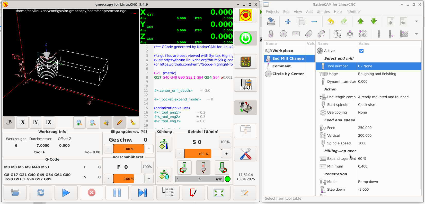

20 Apr 2025 15:54 - 20 Apr 2025 16:11 #326769
by Cynas
Replied by Cynas on topic NativeCam on LinuxCNC 2.9.3
embedded - incomplete view and no proper operation
standalone - it doesn't start
ncam --catalog=mill - ok
ncam --catalog=plasma - ok
ncam --catalog=lathe - it doesn't start, error in the next post

20 Apr 2025 16:08 #326770
by Cynas
linuxcnc@linuxcnc:~/Desktop$ ncam --catalog=lathe
NativeCAM info:
inifile = NA
NCAM_DIR = /home/linuxcnc/nativecam
SYS_DIR = /usr/share/linuxcnc/gladevcp/NativeCAM
program = /usr/share/linuxcnc/gladevcp/NativeCAM/ncam.py
Using default lathe/menu.xml, no lathe/menu-custom.xml found
File "/usr/bin/ncam", line 4124, in get_selected_feature
if self.actionDualView.get_active():
AttributeError: 'NCam' object has no attribute 'actionDualView'

DEBUG actionDualView.get_active
Previous work not saved as current work
File "/usr/bin/ncam", line 5923, in <module>
ncam = NCam()
File "/usr/bin/ncam", line 2827, in __init__
self.load_currentWork()
File "/usr/bin/ncam", line 5068, in load_currentWork
self.action_new_project()
File "/usr/bin/ncam", line 5086, in action_new_project
xml = self.update_features(xml)
File "/usr/bin/ncam", line 5524, in update_features
recursive(xml_i, None)
File "/usr/bin/ncam", line 5465, in recursive
f_B = Feature(src=src_f)
File "/usr/bin/ncam", line 1784, in __init__
self.from_src(src)
File "/usr/bin/ncam", line 1848, in from_src
src_config.read_string(str(f))
File "/usr/lib/python3.11/configparser.py", line 739, in read_string
self.read_file(sfile, source)
File "/usr/lib/python3.11/configparser.py", line 734, in read_file
self._read(f, source)
File "/usr/lib/python3.11/configparser.py", line 1112, in _read
raise DuplicateOptionError(sectname, optname,
configparser.DuplicateOptionError: While reading from '<string>' [line 90]: option 'header' in section 'PARAM_Z_RAP' already exists
