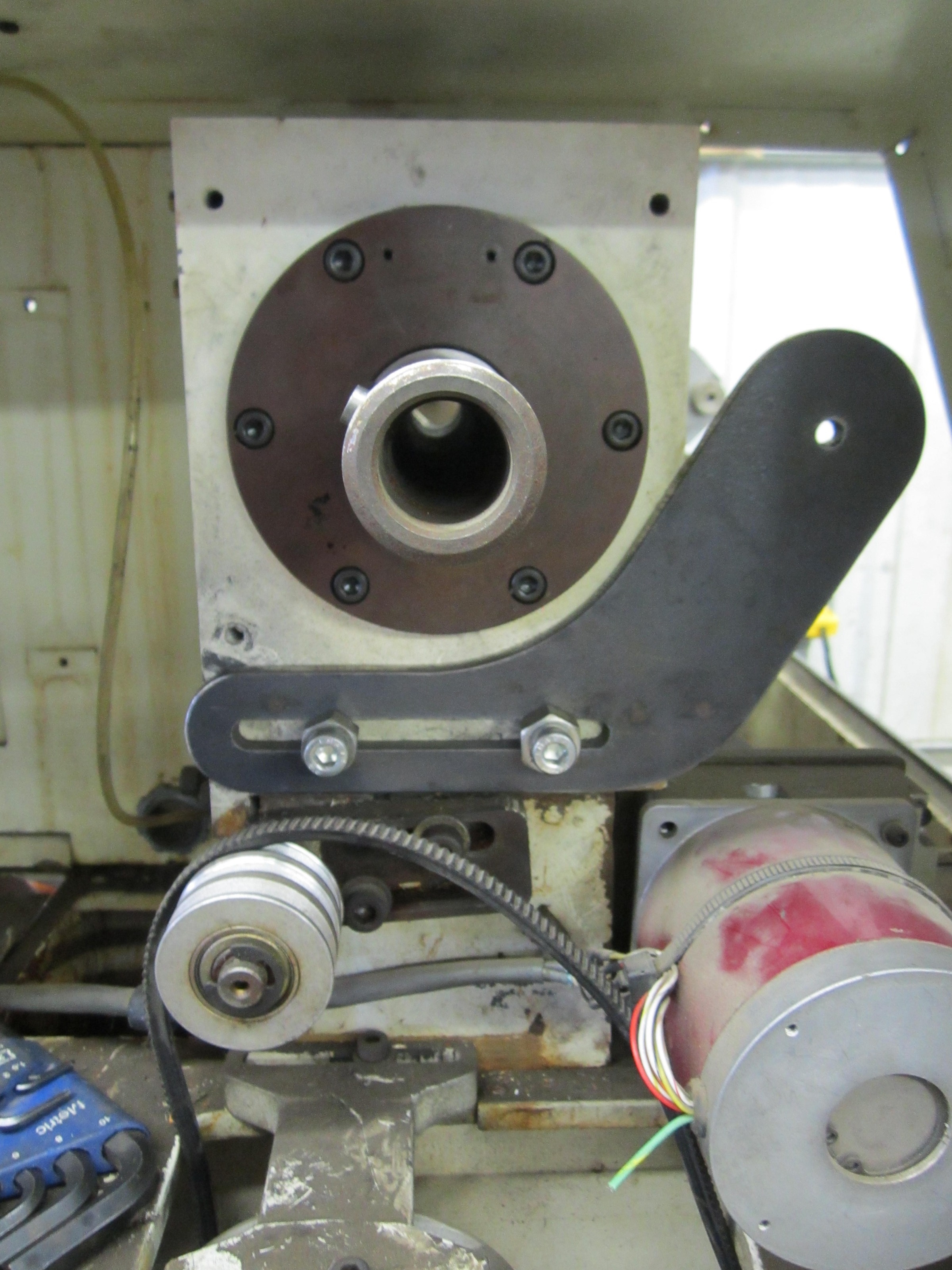

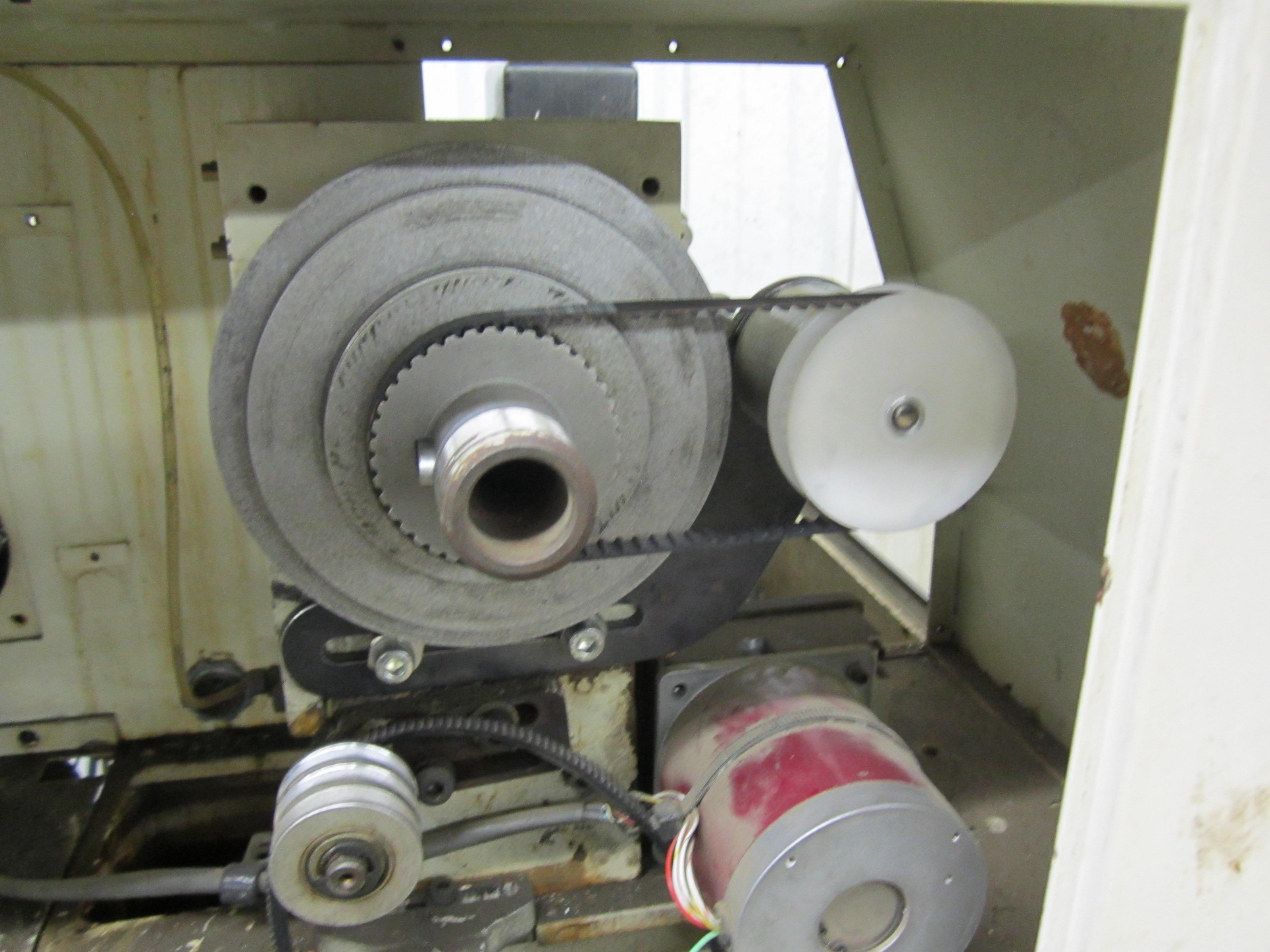

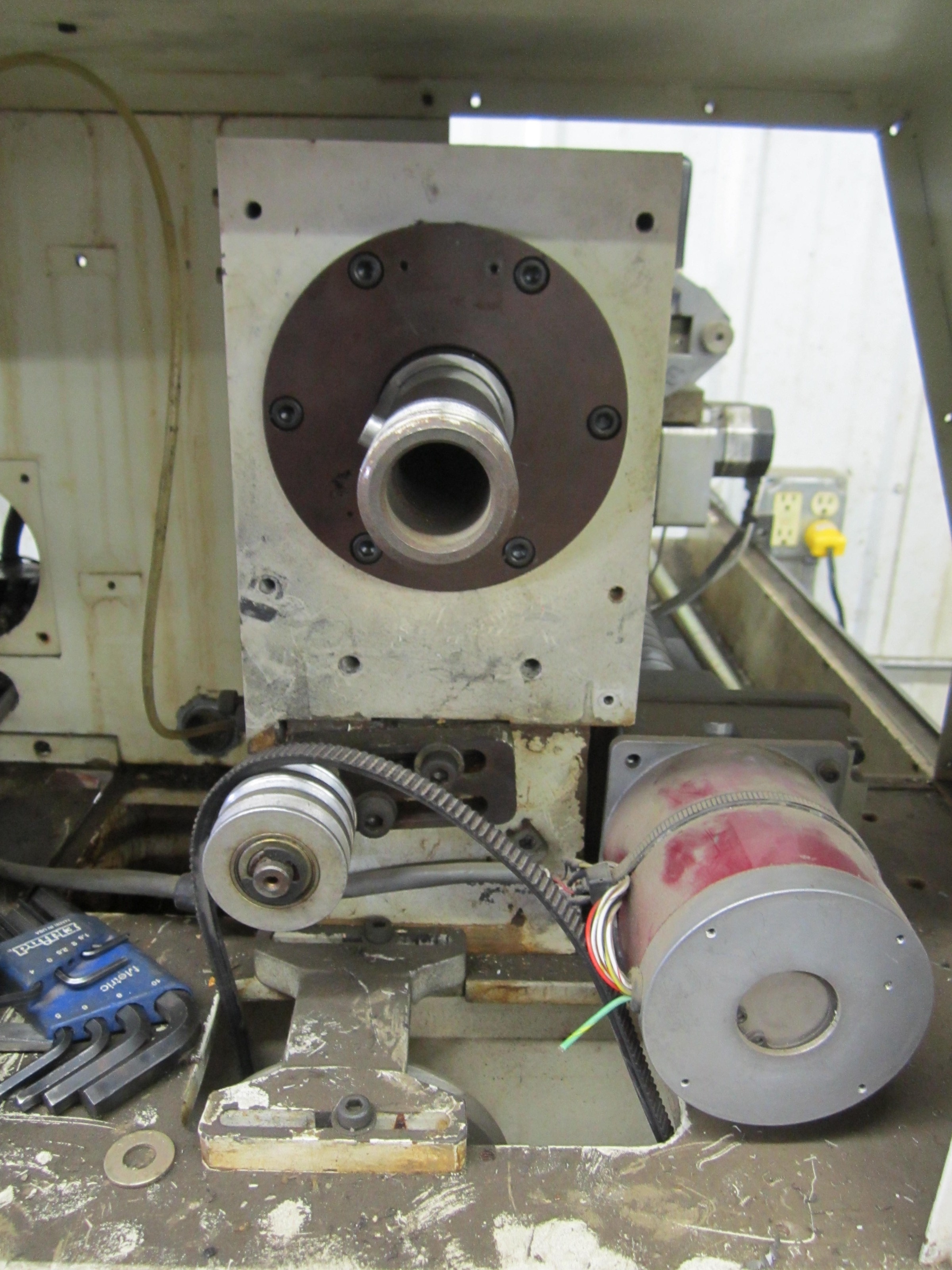

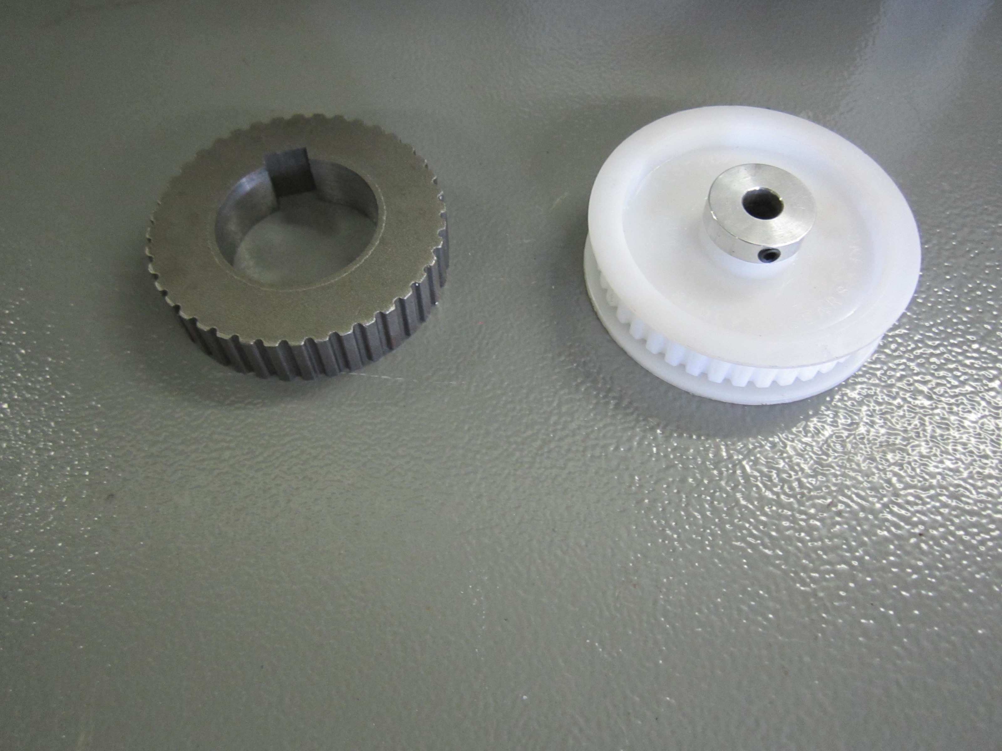

Here is the start of getting my spindle speed input. I got a stock martin gear and bored it out to fit my spindle. Then i fabricated a mounting bracket and bearing block to mount encoder.
Brian
Brian
