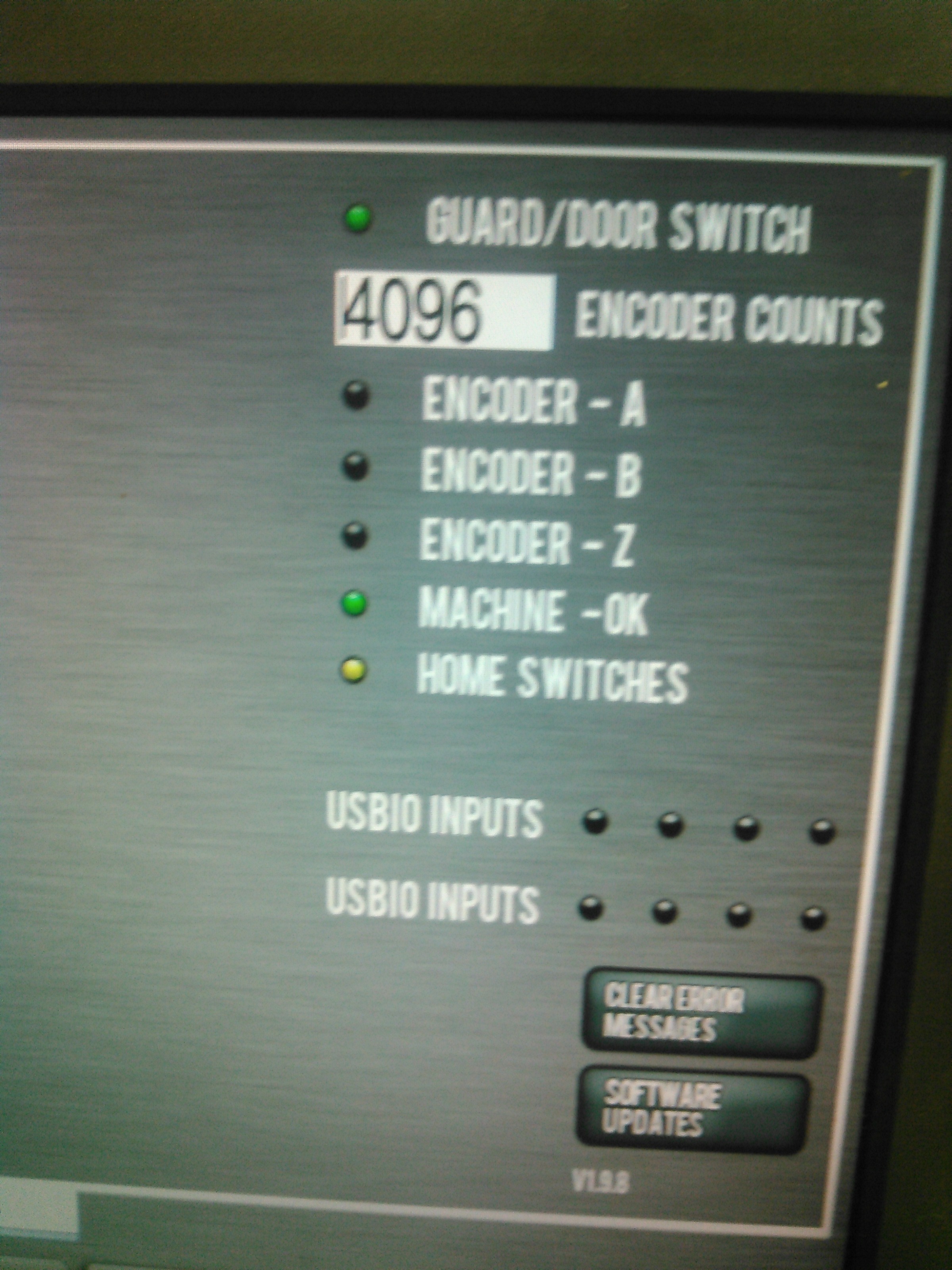

Replied by PCW on topic PathPilot Lathe with 6 place turret
if the LEDS never light up. I would check that the 7I76 encoder inputs are jumpered to match the encoder type
does the encoder position change when you rotate the spindle? Also are you sure you have the correct firmware?
( stock Pathpilot will re-write the 5I25 firmware with Tormachs firmware )

04 Feb 2018 17:25 - 04 Feb 2018 17:26 #105408
by brianTruck
Replied by brianTruck on topic PathPilot Lathe with 6 place turret
Pathpilot doesn't let us access most of halcmd and halmeter functions.
Here is the code in the post GUI file that displays status on screen, the encoder count works.
net spindle-encoder-count hm2_5i25.0.encoder.00.count => tormach.encoder-count
net sig1 => tormach.encoder-a
net sig2 => tormach.encoder-b
net sig3 => tormach.encoder-z
I do have Pathpilot controlling my spindle, but can't tell if it's using the encoder to keep the spindle at speed.
Thanks'
Brian
Thanks'
Brian

04 Feb 2018 17:44 #105409
You should be able to run halcmd and halmeter with
admin halcmd
admin halmeter
or start Pathpilot in a window and run the commands from a terminal
I really can't imagine trying to get this working without a tool set that lets you see what's happening behind the curtain...
In fact getting a working debug tool set should be the first priority
Closed loop spindle speed control will require modifying the hal file
( and this again will be much harder than it needs to be without having a working debug tool set )
admin halcmd
admin halmeter

04 Feb 2018 21:48 - 04 Feb 2018 21:49 #105422
by brianTruck
I'll check later on admin halcmd and admin halmeter. For now I can tell you that everything seems to be working ,the spindle speeds up when tool get closer to center. If i unplug the encoder while lathe is cutting all axis come to a stop until I plug encoder back in (rpm gauge also goes to zero).
I'm fighting a little bit with if this thing is running in diameter or radius mode.
Thanks'
Brian
