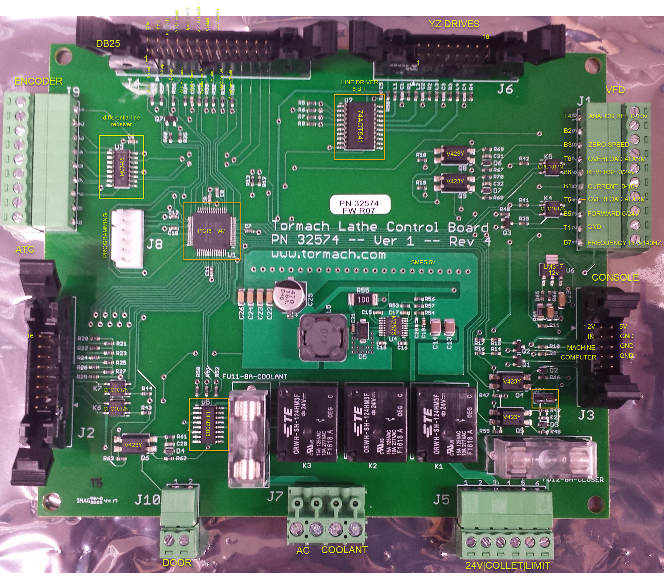

07 Feb 2021 23:14 #197971
by smgvbest
Replied by smgvbest on topic SK Commander VFD Parms
For documentation purposes only
Here's what I have worked out on the Tormach Lathe Control Board so far
Few items to note
24Vdc in > SMPS @ 5Vdc and 12Vdc at U6 for Control Panel
AC in Isolated and switched via relays
Encoder is Differential in to singled ended out direct to Mesa Card
ATC has 9 Digital lines going to it
Drives have Octal Line Driver
VFD has B2 connected but not configured in Parms
See attached for what I've identified

04 Mar 2021 01:00 #200996
by smgvbest
Just wanted to provide a quick update.
I have a Teensy 4.1 setup running FreeRTOS with ChargePump detection and generating the Door and Limit switch input (freq based) working. I'll add MachineOK soon which is really a few items, ChargePump must be there (500Hz), Emergency Stop must not be Tripped, Tormach kills AC power the board for this and it looks like they do a simple peak detector circuit. if Present the Emergency stop is not tripped. so Basically it's MachineOK = ChargePump + AC Detect . I feed this to Enable Steppers and VFD. If not present motion is disabled at the hardware level.
Next will be to hook it up to PP and see if it comes up ok.
Only Signals needed to test are ChargePump from PP, DoorSW, MachineOK and I should have PP able to come out of Reset state. Or that's my hope.
I had some issues with FreeRTOS in that I was doing everything in C++ with Classes and FreeRTOS is not written to support that. I have it working with my TormachBob Class
