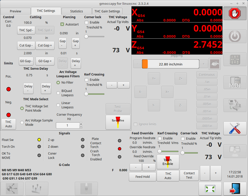

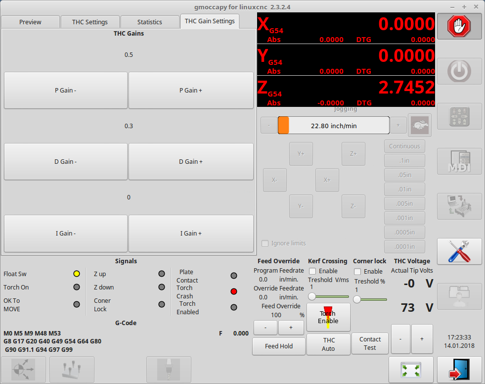

- islander261
- Posts: 757
- Thank you received: 216

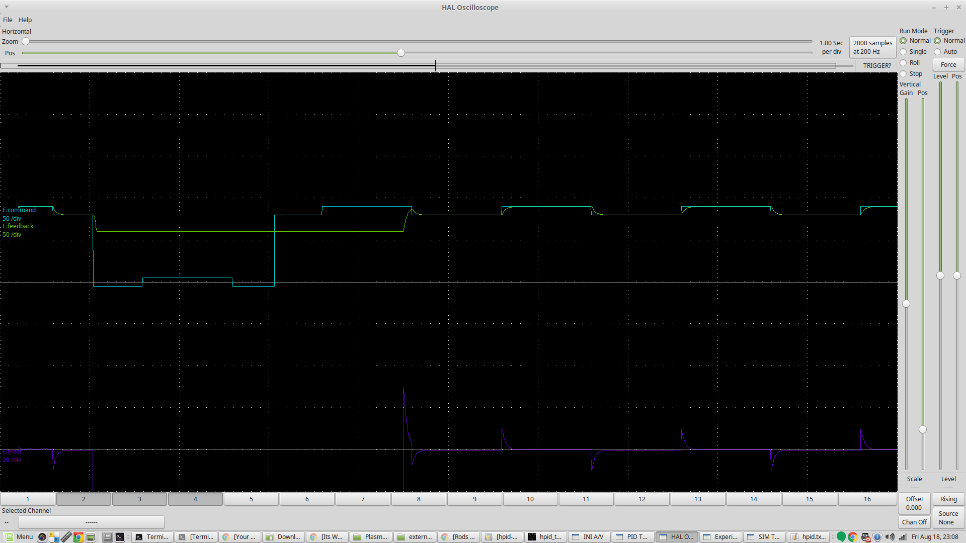

15 Jan 2018 01:37 #104486
by islander261
Replied by islander261 on topic Anyone Actually Using External Offsets Branch for THC?
Rod
Thanks for clarification on the simulation, I though I was to try and actually drive my machine with it.
Find attached a bunch Halscope logs of trial cuts. This seem very strange the low gain needed to get the oscillations down. They also required dgain to work at all.
The records are quite short because of the thin material I have. I have included a screen shot of THC setup.
My cutting current is 45A at a speed of 220ipm.
I'm still not sure where to go from here as I don't believe the low gains I am using are correct.
John
John

- Posts: 12161
- Thank you received: 4151
15 Jan 2018 03:45 #104493
You and I had already built a working config before adopting eoffset_pid though.
I think if I followed Dewey's paradigm from the beginning, I would have a much more streamlined system with more automatic settings as the sheetcam post we both used as a base is probably far more complex than what we need.
Were the cuts stable or was it oscillating?
It would be good to post some screen dumps of your Hal scope of a live cut. Thats what Dewey and I worked with.
Its very interesting how low your P & D settings are. This may be the reason. In your ini file, you haveThis is a key critical parameter.
This means that only 20% of the velocity and acceleration settings of your Z axis can be used by the THC to adjust the height
When we first started, Dewey was apologetic that he set it so low and suggested that it might need to be much higher, more like 0.8. But then touchoffs take forever as they are throttled back to 20% of maximum speed. So then I had an idea of setting it to 0.5 and doubling the actual velocities in the ini file so that maximum speeds were available for both the touch off and THC control could both use maximum speeds as 0.5 of 200% = 100% of available performance. This can only work becasue the THC and touch off are mutually exclusive events. Make sure you understand what I've written here and review your Z axis velocity and acceleration settings.
Now on to tuning.....
I'm going to assume you had a stable system at those low P & D terms for now.
I'm no expert with PID tuning but I think the idea is to continue to push P up (try doubling it each time) and adjusting the D to get it stable again. Once it becomes unstable and overshoots and oscillates around the set point before settling, then back off to the last stable setting. This should give a more robust system than the initial low values.
From what I did, I think velocity and (more importantly) acceleration will be key tuning parameters as well as the P,I,D terms and the provided sim allows these to be changed on the fly. In theory, we want these to be as fast as possible so we build a really responsive system so I would not change the maximum machine settings unless I was out of options.
So in answer to your question. What to do next? I think I would change OFFSET_AV_RATIO to 0.5 and see if you can get it stable again.
Then I would try slowly increasing the velocity and acceleration settings so they are 2 times what the machine is capable of and see if you can keep the system stable by changing the PID settings. At that point, I would try gradually increasing the P & D terms as discussed earlier.

15 Jan 2018 05:05 #104495
by islander261
Rod
Damn, I really didn't want to have to get another GUI and configuration running.
The cuts look good, but don't be fooled, the Z axis was oscillating all over the place. I guess this is a good testament about the tolerance of the HT torches to cutting height.
Ok, I am just starting to get my head wrapped around the OFFSET_AV_RATIO parameter. This may explain why it appeared that the touch offs were so slow.
I have tuned many PID servo controllers over the years. This is why am am very suspect that the basic setup I have is wrong.
I have plenty of head room to increase the axis velocity and acceleration if need be. Dewey has recommended about .2g+ for cutting corrugated steel, my present setting is .15g and I am cutting sheet that is flat to better than .25"/foot. Torch ends are expensive and I have learned the hard way about driving them into the table even with a break away mount. If the break away mount is stiff enough that the torch doesn't wiggle (technical term) when cutting then you can damage the torch in a collision, it just saves the day when the operator has a brain fart.
I posted an archive of some of the Halscope log files I took. This is a much more efficient way to transmit this information.
