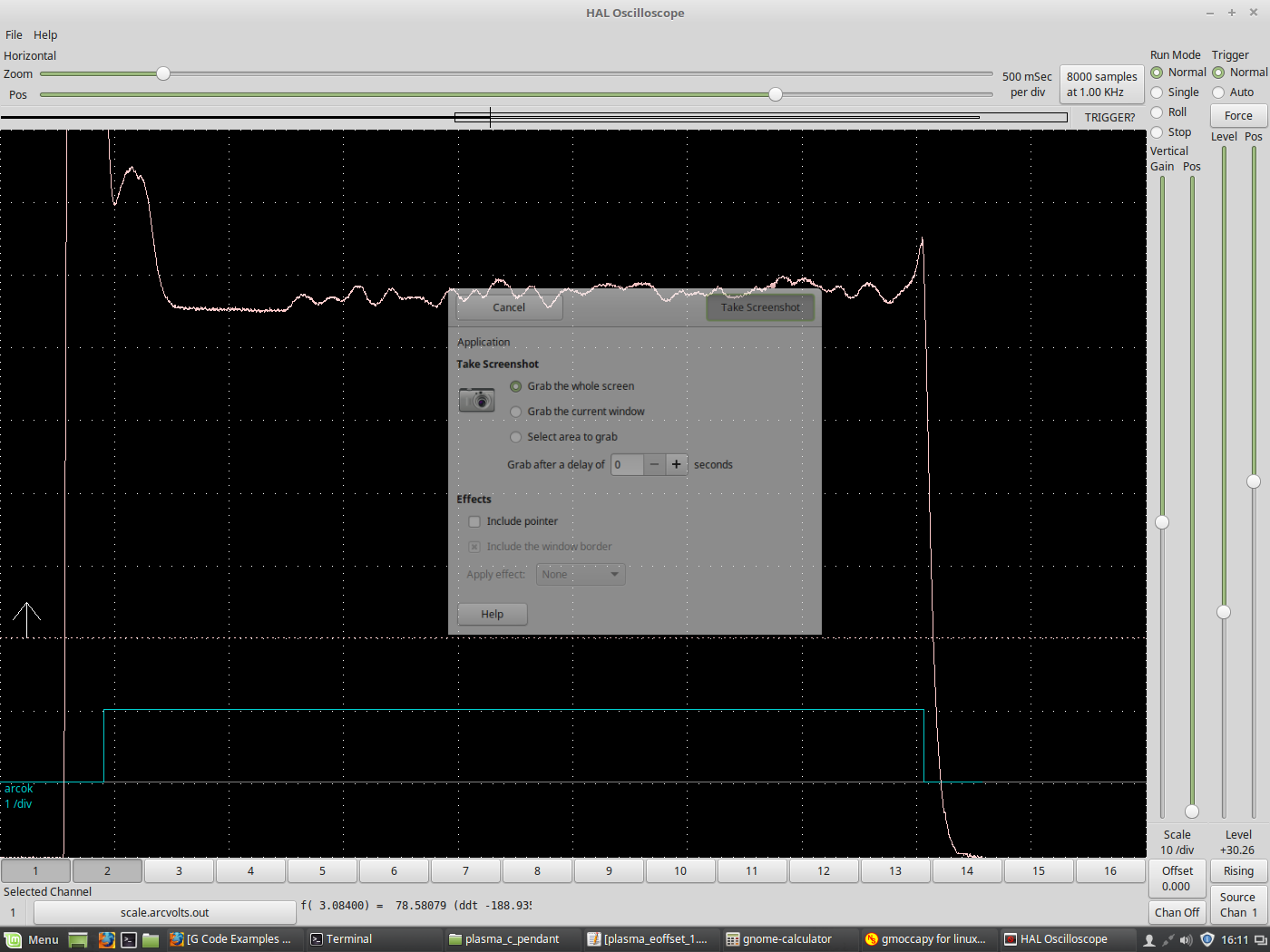

I am still stuck in the low gain woes. I hope Dewey has a look at this and spots my errors.
I changed the .ini like this in the Z axis section;
I checked the actual distance moved by the Z axis and it matches any commands I gave using MDI, jogging, and gcode.
Here is about the best I could get as a halscope trace of the arc voltage. The Pgain was set to 1 and the Dgain was set to .3. Note while this motion was taking place the Z axis was moving up and down synchronized with the voltage (the set point was 78v) . The cut is good but I will wear out the lead screw or nut in a week with this much motion ( don't ask about how I know about worn Z axis lead screws).
Oh well it was a good try for a screen shot. I think you can still get the general idea of what is happening.
I think that I am going to move on to cleaning up other loose ends at this point and revisit this whole THC thing later. I can always go back to the old control system with about an hours setup now. I still need to get a Sheetcam PP going for this. The one example we look at is really complex and has a lot of bug fixes embedded in it so I think I am going to modify the one I currently use for a basic PP to start with. I cut the same material and thickness 98% of the time so I will hold off on incorporating gcode controlled cutting parameters for now even though my controller is set up to accept them (and does work as far as my testing goes).

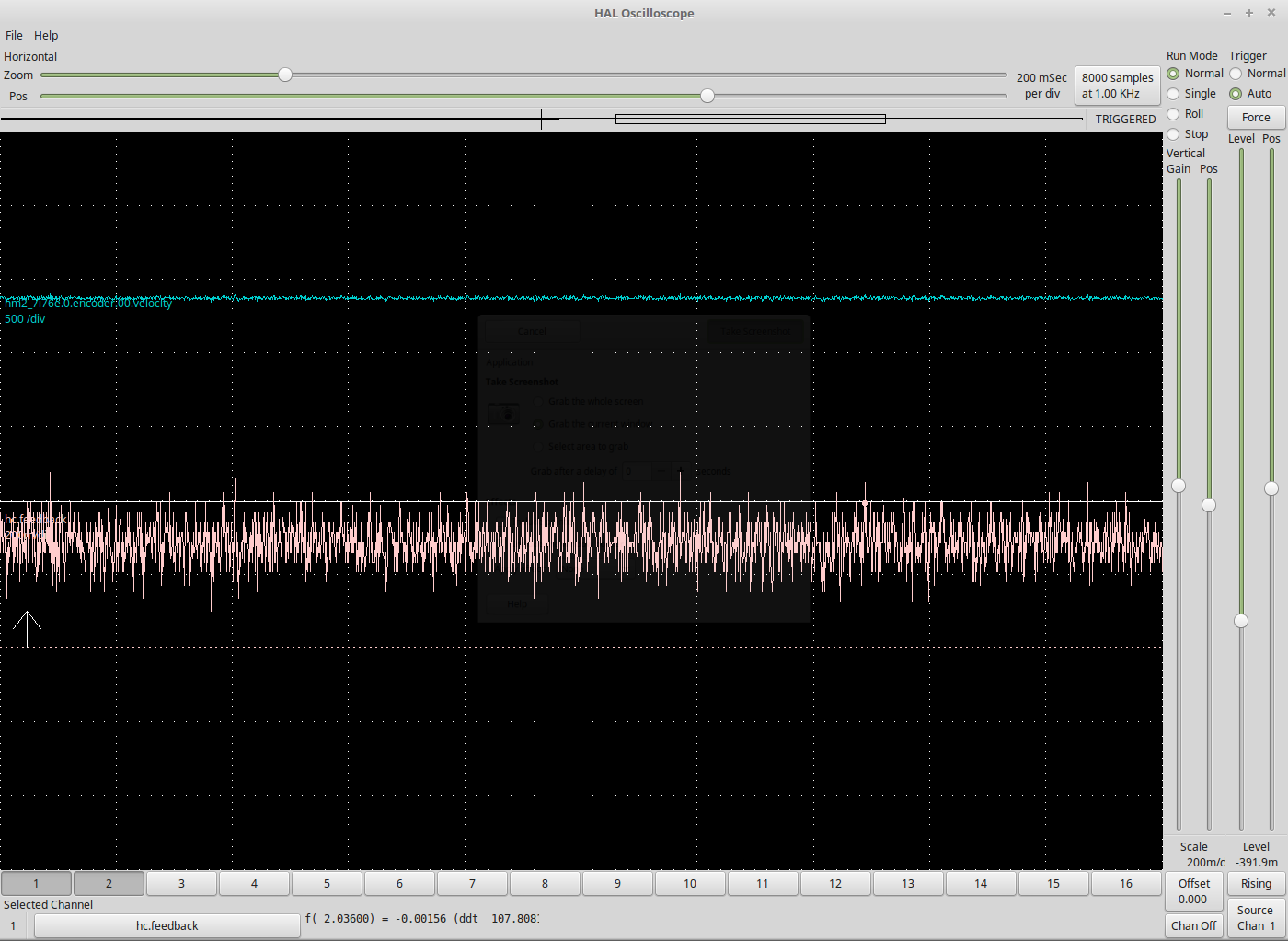

I started looking this morning at the lower noise ways to read the THCad card for arc voltage. My previous focus had been at all out speed, noise be damned. Well that really didn't change anything. I then upped the halscope gain and was looking at the scaled arc signal and found that there was a strong 60hz component in the noise with the cutter off. Lots of looking around later I found the problem, The safety ground connection to the outlet strip I was using was broken so the control computer and 7i76e box were both floating with respect to ground. Fix this and reduced the noise by about 1/2. So now I have about 200mv pk-pk noise when the cutter is off. I quick cutting test revealed that the scaling was in deed correct but no change in THC performance. As a quick check I disconnected the cutter and voltage divider and had no change in noise. So I connect a wire between the input+ and input- connections on the THCad card, still no change. So this is where I ended up today with the THCad input shorted, about 200mv pk-pk noise still present:
So from I am operating the THCad in the divide by 32 mode. I have an 18.94181:1 voltage divider between the work leads and the THCad. The FS for my card is 970700hz and the Zero is124400hz. Here are my relevant hal entries:
Here is the THCad installation:
Does anyone have any ideas about what is going on here? 200mv pk-pk noise seems pretty high to me with the input shorted. And yes, I have a common mode filter on the power input to the 7i76e box.
TIA
John
TIA

200 mV of noise relative to 300V full scale really should not cause any issues.
You can trade off noise vs bandwidth by using the lowpass filter on the voltage before its fed into the control loop.
The plasma voltage will always have some HF noise (typically much bigger than 200 mV and due to arc hopping)

So your scaling is set for 10V full scale?
If so yes 200 mV is way too high (2% of full scale where ~0.1 or 0.2% is expected at a 1KHz sample rate )
but these number suggest ~300V full scale:
setp scale.arcvolts.gain .007162211
setp scale.arcvolts.offset -27.843

18 Jan 2018 10:56 #104673
by islander261
Replied by islander261 on topic Anyone Actually Using External Offsets Branch for THC?
PCW
Thanks for the reply. You found the error in my analysis.
My THCad is connected to my plasma through a 18.9...:1 voltage divider, hence the scale and offset numbers. I have check the scaling using a 168V power supply verified with a DMM on the input to the voltage divider. When I disconnected my plasma machine, voltage divider and shorted the input to the THCad I didn't change the scaling so I was treating it like an 190v full scale machine. So I guess what I really need to look at is the encoder.velocity pin or set my scaling for 10V full scale and check the noise.
I think that I am going to find that the THCad and associated .hal settings are just fine. .2V/190V = .00105 or .105%.
