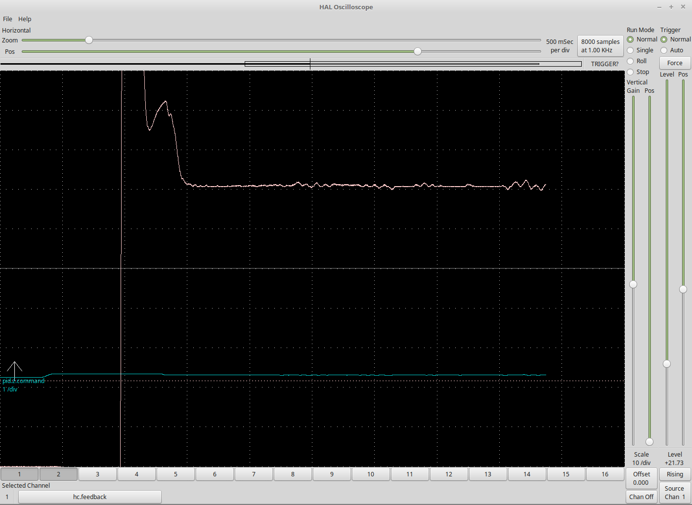

Well I have made some progress towards having working THC using the eoffsets branch. I have looked at the source code (I'm not a programmer) till my eyes bugged out get my head wrapped around this thing. I have cut nearly 100 test lines in the shop trying to find a configuration the works well. Thanks to Dewey for all the hard work he put in getting it this far.
What I have now is THC in a straight line with no corner hold or kerf crossing tested. The torch holds 2v (.010") pk-pk or better position while following gently bending sheet. The height control is still a little "nervous" for my tastes but much better than previously. The cut is good with no noticeable variation in taper or kerf width. I have even gotten to test many of the extra features I added to my GUI. I think I will have a total rebuild of my GUI before putting this into production use. I also need to reinstall the eoffsets branch because it has been rebased since my last install.
My configuration is not the standard one for testing the eoffsets branch. I am using eoffsets_pid Pgain =1 and Dgain =.1. My machine is an inch units machine. My z axis is set to maximum velocity of 220 ipm with an acceleration of .15g. Here are the deviations from the standard test configuration files that I have.
During my testing I found that it would have been really nice to have separate scaling factors for both axis velocity and acceleration.
Tonight I have to reinstall my old commercial controller so I can get back into production. It will be a month or more before I get a chance to dive back into this, maybe someone else can clear more of the path in that time.
John
