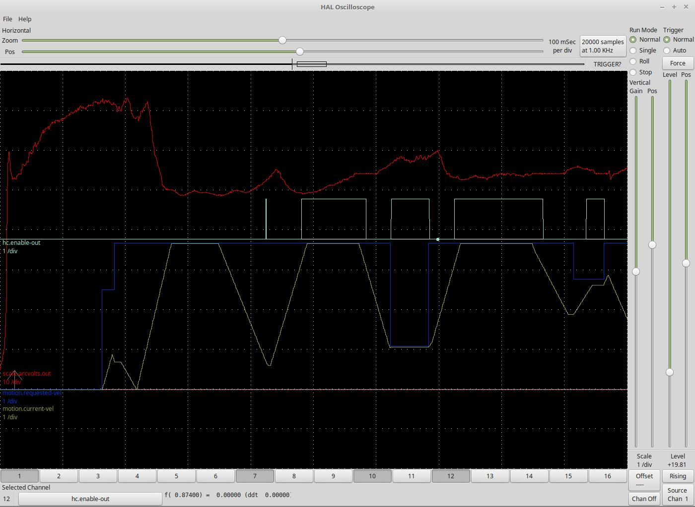

I believe that I have found a rather strange source of some of the "divots". All of the THC comps that I have seen that do any sort of velocity hold are comparing motion.current-vel to some fraction of motion.requested-vel and causing a height hold when it is less. If you look at how motion.requested-vel is defined in the docs this makes perfect sense:
motion.requested-vel - (float, out) The current requested velocity in user units per second from the F=n setting in the G Code file. No feed overrides or any other adjustments are applied to this pin.
The trouble is that it only behaves this way when the motion planner thinks the mechanics of the system as set in the .ini file can keep up. The motion planner reduces the value of motion.requested-vel if it will cause a violation of the .ini parameters for that joint (slows down for the corner). This causes a problem for the height hold because you are comparing to a moving reference which ultimately causes the THC to be active when it should be holding. Look at the attached halscope screen shot.
You may need to view this with an external viewer so you can zoom in to see the details. The blue trace is motion.requested-vel. The sage trace is motion.current-vel. The white trace is hc.enable-out (thc servo enable) and the red trace is arc voltage. You can see two instances on the right side of the screen where motion.requested-vel dropped to some value below the value commanded by the F word in the gcode. The result is the predictable enabling of the THC servo when it should be holding the height which leads to the torch diving and a "divot". This happens in a number of place during this cut. I have attached a second screen shot from a different part of the the cut to show this is not an isolated case. I have also attached the gcode for the cut that these screen shots were taken from.
OK so I am way over my head here. Do I not understand the docs correctly? Are the docs in error or incomplete? Is the motion component not behaving correctly? I do know one thing for sure and for any sort of velocity hold to work when plasma cutting we need a stable source of commanded velocity from the gcode we can access in the hal. Right now the behavior of the motion.requested-vel pin causes the velocity hold functions to fail just when you need them the most when plasma cutting.
John
08 Jun 2018 14:28 #112002 by islander261
Replied by islander261 on topic THC Servo Start
Wow, I am surprised that this hasn't generate some interest as it potentially affects most plasma configurations I have seen. This was also independently confirmed by rodw on both the external-offsets and master branch last night (well day in Oz).
John
08 Jun 2018 17:05 #112010 by PCW
Replied by PCW on topic THC Servo Start
Requested velocity definitely doesn't behave as I would expect
(I would expect it to follow the feed rate in the gcode file during all but G0 moves)
