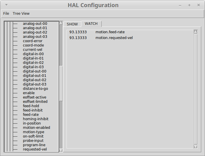

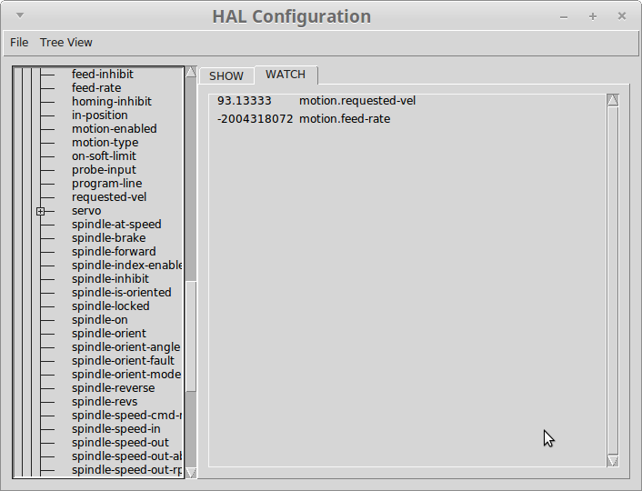

11 Jun 2018 08:10 #112186
Replied by rodw on topic THC Servo Start
I added a new field called feed_rate to the
emcmotStatus and emcmot_hal_data structures
I then tried what Sebastion suggested on the issues tracker github.com/LinuxCNC/linuxcnc/issues/440
and this is what I got.
in /src/emc/tp/tp.c, I addedin src/emc/motion/control.c (to load the Hal structure)And in /src/emc/motion/motion.c
I didn't understand what Sebastian mean when he said "And when the tcq drains, set that pin to 0." but the value drops to zero between cutting segments.
Any ideas would be much appreciated.
emcmotStatus->feed_rate = tc->reqvel;*(emcmot_hal_data->feed_rate) = emcmotStatus->feed_rate;if ((retval = hal_pin_s32_newf(HAL_OUT, &(emcmot_hal_data->feed_rate), mot_comp_id, "motion.feed-rate")) != 0) goto error;I didn't understand what Sebastian mean when he said "And when the tcq drains, set that pin to 0." but the value drops to zero between cutting segments.

11 Jun 2018 18:41 #112219
Sorry guys, a false start, the feed-rate pin is a copy of requested-vel

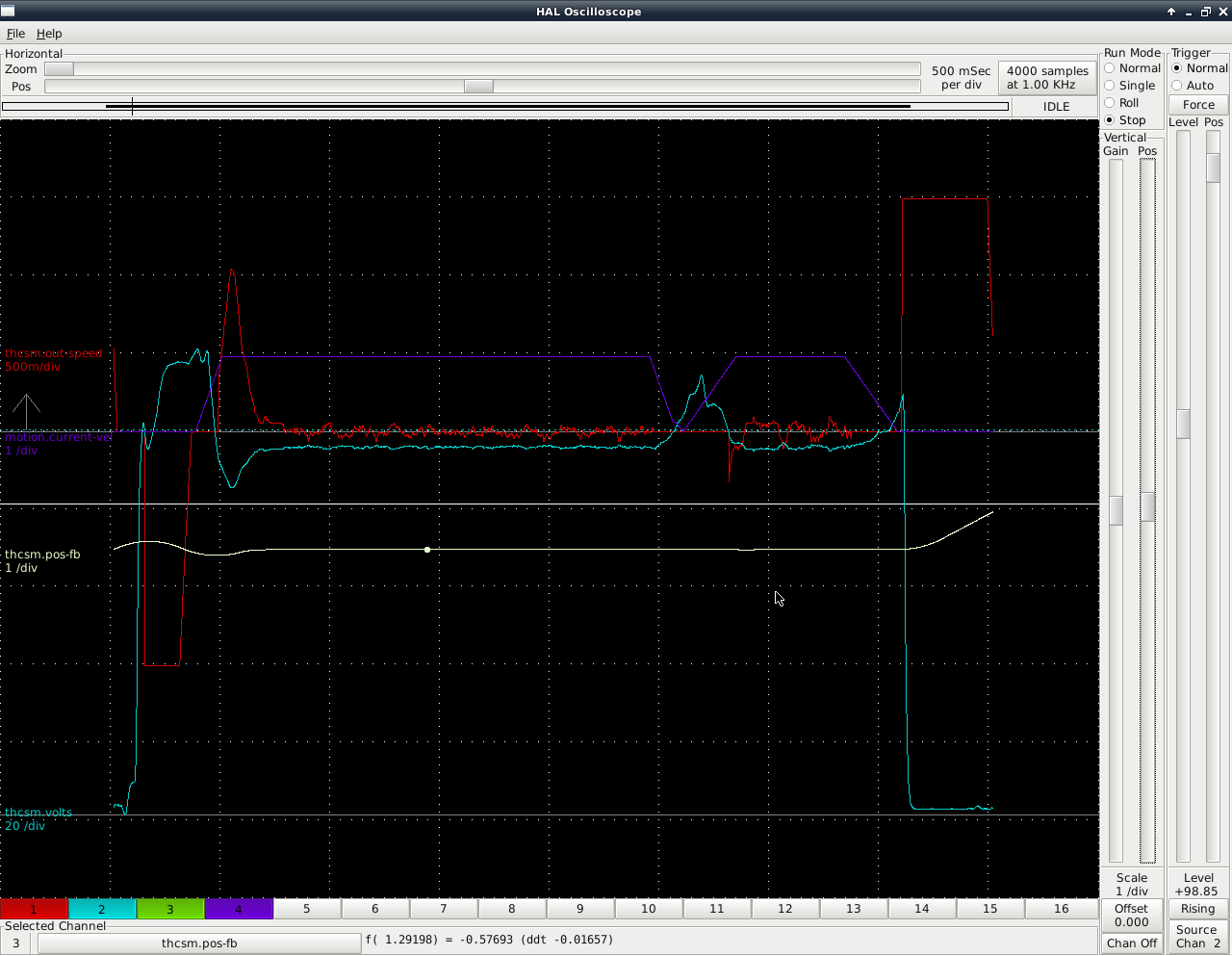

16 Jun 2018 01:59 #112458
Just a bit of an update. And a Solution!
After a bit of research I found something and asked the devs if we could remap the F code..
Some of the developers had forgotten that the F code can be remapped. There is a complete sim example already included.
It uses a subroutine called setfeed.ngc and you just have to change it to
And use motion.analog.out.01 instead of motion.current-vel in your HAL file.
After I confirmed this worked in a sim and grijalvap has tested this on a live config.
So the only thing missing is some decent documentation on remapping as its a bit convoluted to migrate it from a sim to a live config.
o<setfeed> sub
(debug, in setfeed feed=#<feed>)
; using the code being remapped here means 'use builtin behaviour'
M67 E1 Q[#<feed>/60]
F#<feed>
; signal success be returning a value > 0:
o<setfeed> endsub [1]
m2And use motion.analog.out.01 instead of motion.current-vel in your HAL file.

- Posts: 12176
- Thank you received: 4155
16 Jun 2018 17:03 #112497
What do you mean? Its already 8:00am Sunday morning here! Time to get out of bed!
So good to see this finally coming together for a few people. Those results look great.
Can't await until Sunday.
I have implemented the Remap solution on a Live Cutting system attached you can see the signals
