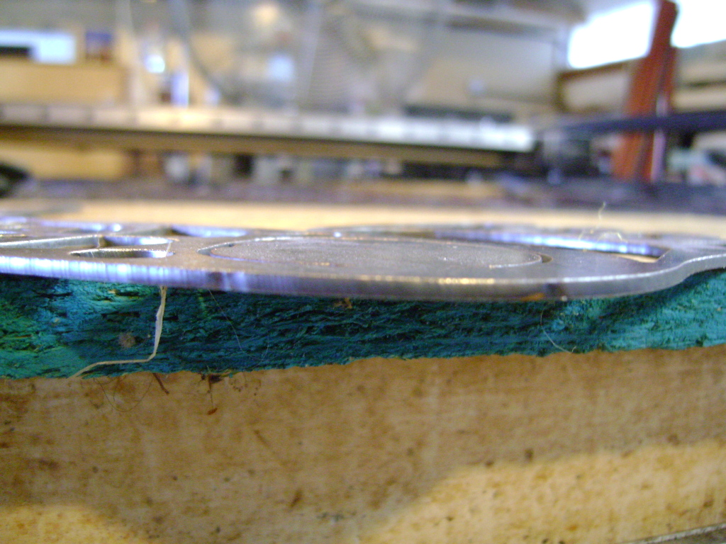

08 Jul 2018 12:58 #113826
by islander261
Replied by islander261 on topic THC Servo Start
Guys
I will try and get some photos of the marks posted in the next few days. The G code snippets will be a little harder, these parts are cut from an approximately 500kb file ( 12k lines of code). Does the community want to see the code where the marks occurred, at the start of the cut, at the start of the program?
John
John
John
John

10 Jul 2018 13:41 #113964
by islander261
Guys
I started looking into the bug #447 problem on plasma cutters and have found plenty of examples of "divots" at the junctions of some arc and straight sections. Now the bad news, these "divots" are also at places with strange small linear segments in the G code. So is this the problem reported in bug #447 or is it a post processor problem? I haven't had a chance to look over the original artwork yet and check for short segments but I will.
John
[attachment=15408]gcode_snippet.ngc[/attachment]John
- Posts: 22042
- Thank you received: 7506
10 Jul 2018 16:20 #113971
Replied by tommylight on topic THC Servo Start
@John
Can you notice any slow downs when that divot occurs?
I have seen this plenty when using inkscape to create the paths for plasma, and inkscape has a nice feature to show the segments of any path so you clearly see where the paths are not linked even if they are a single union, so selecting the two unconnected dots and making a single dot out of the two solves that problem.
Almost any path is made out of segments and if those segments are not connected, the machine will have to decelerate and accelerate at that point, leaving a divot.
- islander261
- Posts: 757
- Thank you received: 216
10 Jul 2018 18:24 #113977
by islander261
Tommy
This happens very fast! With halscope I would see the requested-vel go to zero and the back to full speed at the .ini acceleration settings.
I went back and checked the original drawing in Inkscape. The path is joined at every segment. The "divots" actually occur in a single segment. I have used Inkscape for a long time with plasma and am pretty good at producing cuttable files. When I import the file into SheetCAM something happens. SheetCAM breaks up the nice long path segments from Inkscape into shorter segments so each segment is an arc or a straight line, not the Bezier curve that Inkscape uses. The "divots" are at the junction of two of the SheetCAM generated arc segments. It gets even stranger because looking at the SheetCAM generated segments the "divots" are at the junction of two arc segments but the G code produced by the PP has tiny straight segments there. I am going to do some in depth testing of this problem over the next few days.
John
John
