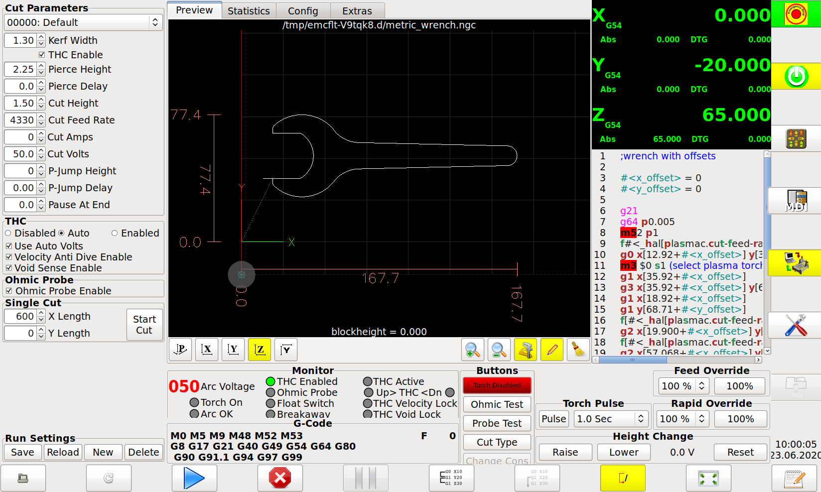

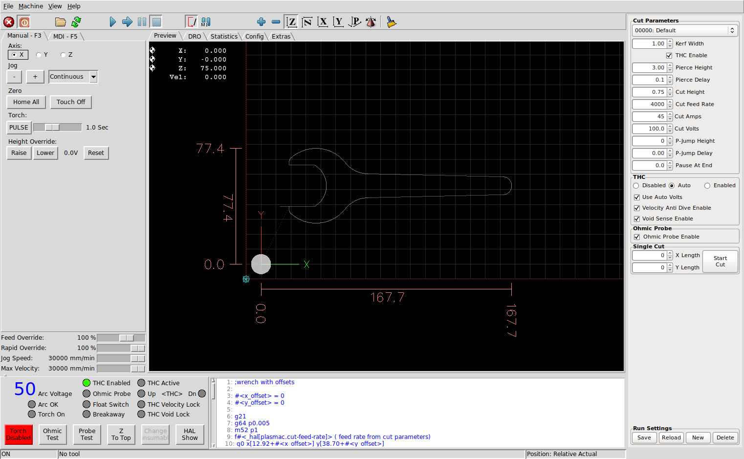

I am in the process of building a very small plasma table (600mm x 600mm or 24" x 24"), during this build I have pored over many forum articles and was impressed with the Toma configuration that tommylight uses.
I have written a configuration called PlasmaC ("Plasma Component" for want of a better word) which includes a single hal component and I think (hope) that it does all that the Toma configuration does plus a few extras.
An HTML User Guide is in the LinuxCNC HTML documents and a PDF version is within the LinuxCNC documentation that is available in your machine with a full LinuxCNC installation.
If you think that something is missing, incomplete or incorrect, please leave a reply on this thread.
The PlasmaC configuration requires LinuxCNC v2.8 or later for full functionality.
It can be installed either as a package from the LinuxCNC buildbot which is recommended for most users or as a run in place installation by following the Building LinuxCNC document.
Also included are sample Axis and Gmoccapy configurations which utilises all the functions of the component.
The example configurations can be accessed from the LinuxCNC Configuration Selector:
Sample Configurations/by_machine/plasmac/ then either axis or gmoccapy.
There is a choice of either metric or imperial configurations.
Example gcode files can be loaded from nc_files/plasmac.
Feel free to try it and if you do I hope it works for you, I am open to suggestions if there is anything I have missed or have got wrong.
