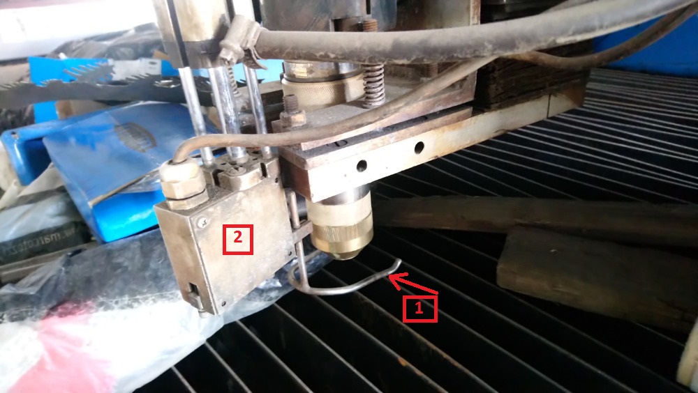

I like your idea of a simulated path pin.
I am not 100% sure what you mean with your eject probe pin.
I have this.. on machine
1. probe
2 pneumatic piston
I need set pin for eject probe to 1
wait 0,3 sec
probe
set pin for eject to 0
wait 0,5sec
continue torch on
Simulation mayby done by remap Mx for spindle, because plasmac starts by spindle-on.
like a feed remap.
martin

That can be easily done in gcode OR hal.
Please start a new thread about that as that might be useful to other members of this forum.
