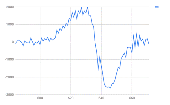

Also, I had a good look at your code. We will need to do some work on the kerf crossing part. Rather than just looking at a change in volts, we need to look at a change in volts over time (dv/dt). From tests I did, it looked like a threshold of around +500 volts/second might work for void sensing. Once the void is crossed, dv/dt becomes negative (falling) so I think perhaps, the THC is enabled following a delay after the first positive dv/dt reading. But you have to have a working machine before you can tackle this.
This chart shows dv/dt at a kerf cross at 200 ms per reading. Horizontal scale is reading number (per 200 mHz)
I'm not sure that there will always be such a pronounced negative reading
. I've also written some non looping moving average code using c pointers. For use in kerf rrossing and torch sampling
14 Nov 2018 10:27 #120660 by rodw
Replied by rodw on topic Another plasma component...
Forgot to say that we can use fperiod to measure time in seconds per servo thread cycle.
From the halcompile docs:
Functions which use floating-point can also refer to fperiod which is the floating-point time in seconds, or (period*1e-9). This can be useful in components that need the timing information.
