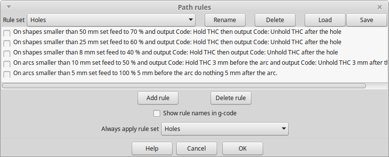

12 Jun 2019 07:28 - 12 Jun 2019 08:02 #136699 by rodw
Replied by rodw on topic Another plasma component...
Thanks Rod,
Remove the THC Enable checkbox and label from the run tab.
Personally, I think this needs to stay. There will be times when times when you will want to disable this just like you can disable the torch.
But you can do this from the radiobuttons.
Then, the need to turn the THC on and off from within gcode would be vastly diminished as the corner lock will do it for us.
That is the case now, if your actual cut feed rate is less then 99.9% of the materials cut feed rate then THC will not be enabled.
Being able to control cutting speed with adaptive feed can be implemented in HAL as I suggested (if it ends up working OK).
What is the intended purpose of using adaptive feed to change the feed rate?
Cheers, Phill.
My bad, I had never noticed the radio buttons.Happy now!
Agreed re the thc enable via the corner lock but people still want/need the ability to disable the thc when it suits them from g code. Stefan quoted an example where he needed to disable the THC well before the end of the cut (which was due to how far behind the arc trails behind on the lower side of the material).
Re the adaptive feed, you caught me at a good time so I could grab a sheetcam screen dump.There are fairly standard rules that apply for holes and other small shapes automoatically and are in use by many people.
So if you apply these to a cutting operation, it will be used for all shapes. These features are not in the post processor but are in rules the user defines.
Granted that the corner lock probably makes the thc irrelevant codes in most situations.
However Sheetcam will use its feedrate to reduce the cutting speed with these rules. The big risk I see is that is if we are using the plasmac feedrate and it gets out of step with the sheetcam feedrate, you won't get the expected results. There is no doubt this WILL happen.
So here is where the adaptive feed comes in. If implemented, We can insert a code snippet here that will reduce the cutting speed by the appropriate percentage of the plasmac feed rate. That way there is no dependence on Sheetcam and you will always have the cutting speed based on plasmac settings. This will eliminate the risk of a major stuff up.
I hope that clears it up
