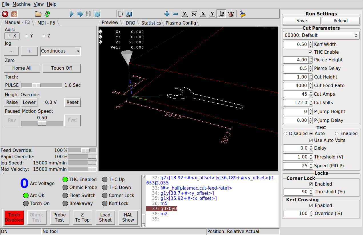

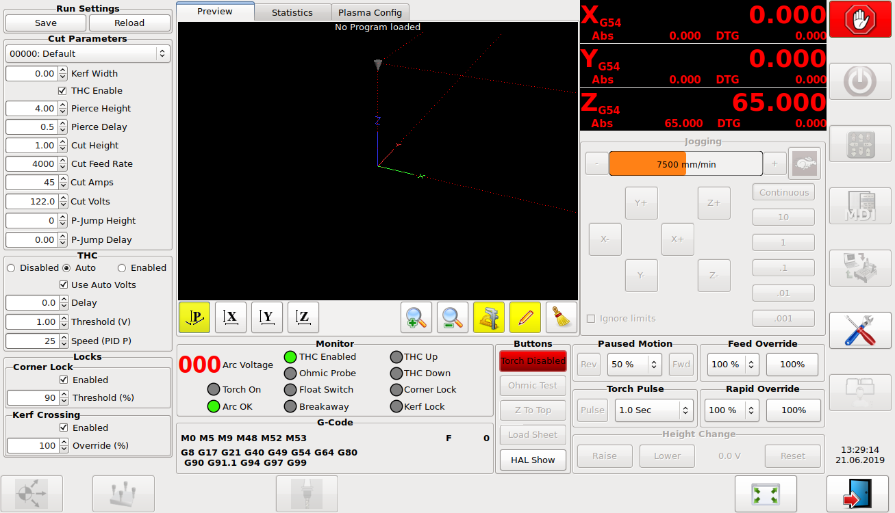

For all you folk with widescreen monitors I have made a Run Panel that shows at the side of the GUI rather than as a tab.
To use this do an upgrade then edit your ini file.
For Axis, the panel sits at the right hand side and at the moment you will get a permanent error in the terminal saying it is waiting for a component to be ready. This doesn't appear to affect the machine operation and there is a pull request in the LinuxCNC repo for a fix.
Comment out the two EMBED lines an uncomment the GLADEVCP line.
For Gmoccapy the panel sits at the left hand side.
Comment out the first three EMBED lines and uncomment the next three EMBED lines.
Axis:
Gmoccapy:
Cheers, Phill.
# run panel in tab behind preview
EMBED_TAB_NAME = Plasma Run
EMBED_TAB_COMMAND = gladevcp -c plasmac_run -x {XID} -u ./plasmac_run.py -H plasmac_run.hal plasmac_run_tab.glade
# run panel in panel on right side
#GLADEVCP = -c plasmac_run -u ./plasmac_run.py -H plasmac_run.hal plasmac_run_panel.gladeFor Gmoccapy the panel sits at the left hand side.
# run panel in panel on left side
#EMBED_TAB_NAME = Plasma Run
#EMBED_TAB_LOCATION = box_left
#EMBED_TAB_COMMAND = gladevcp -c plasmac_run -x {XID} -u ./plasmac_run.py -H plasmac_run.hal plasmac_run_panel.gladeAxis:
Gmoccapy:
Cheers, Phill.

Well it just so happens I did a bit more work on my machine while Phill was doing this upgrade.
Just a heads up you may need to manually copy the new display settings into your ini file. I was getting gcode errors becasue I did not have a feed rate because the whole plasma run tab was missing! The new Gmoccappy wide screen works well.
The other issue I had was that the new HAL connections to allow adaptive feed and disableTHC features.
Anyway, the good news is once I had pins that actually got the adaptive feed working, I sorted out some code snippets and cutting rules for holes for Sheetcam and it all works nicely.
