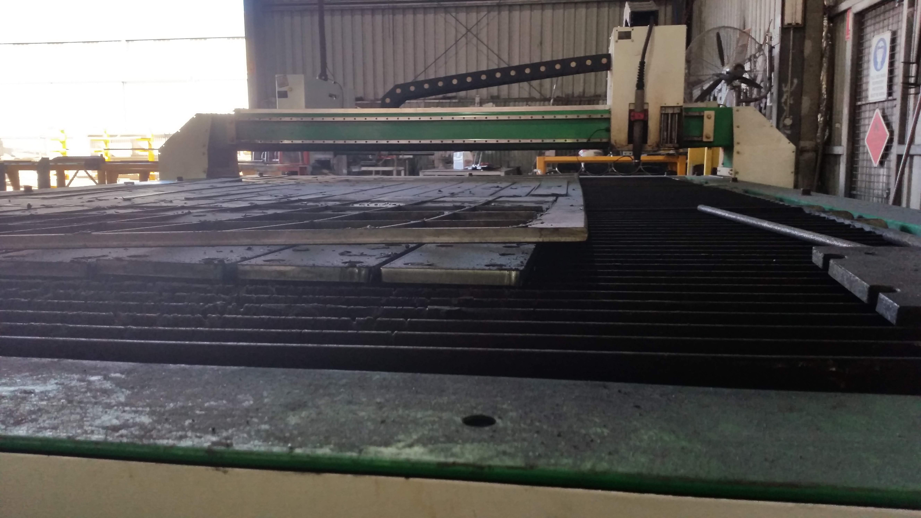

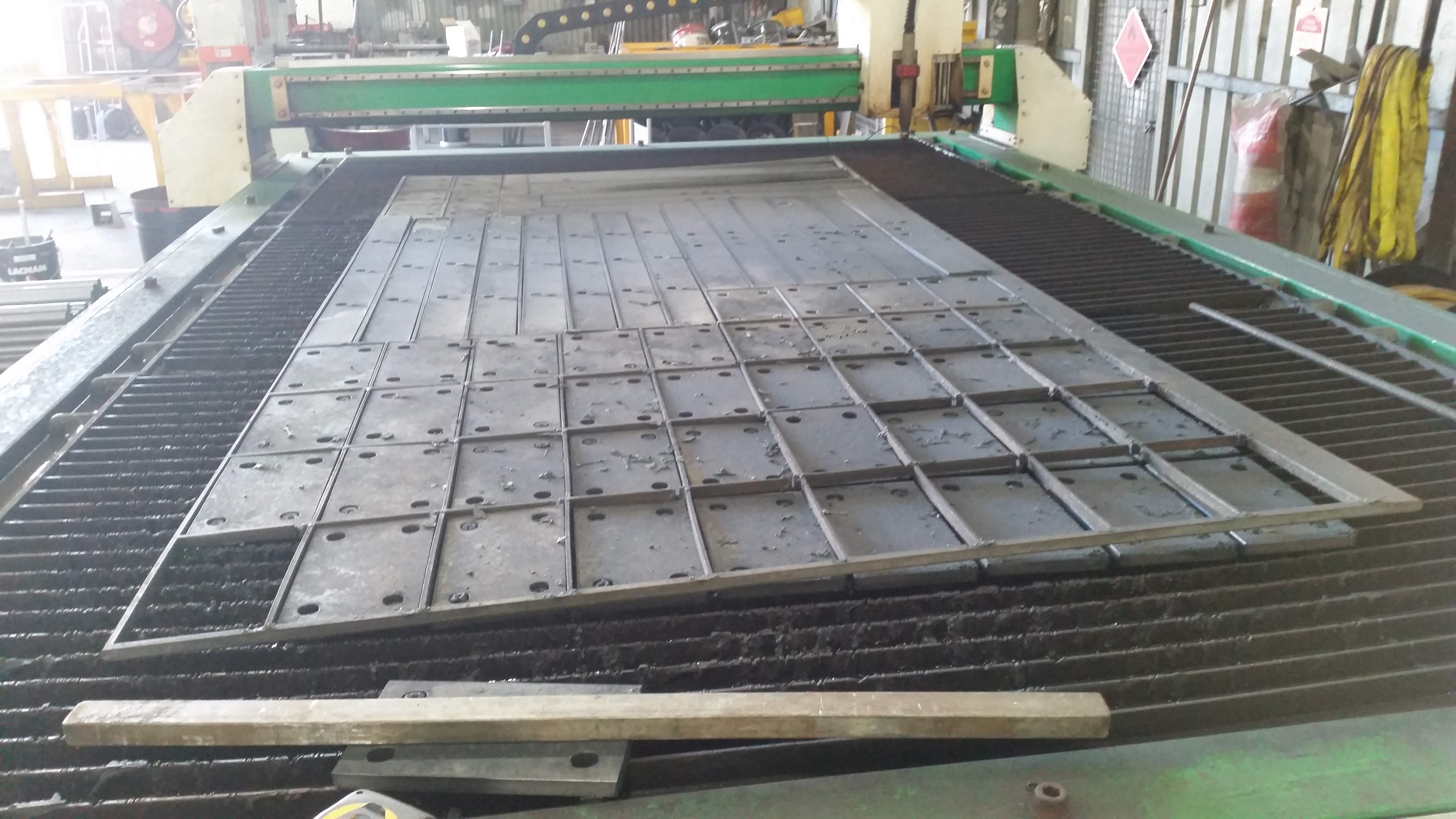

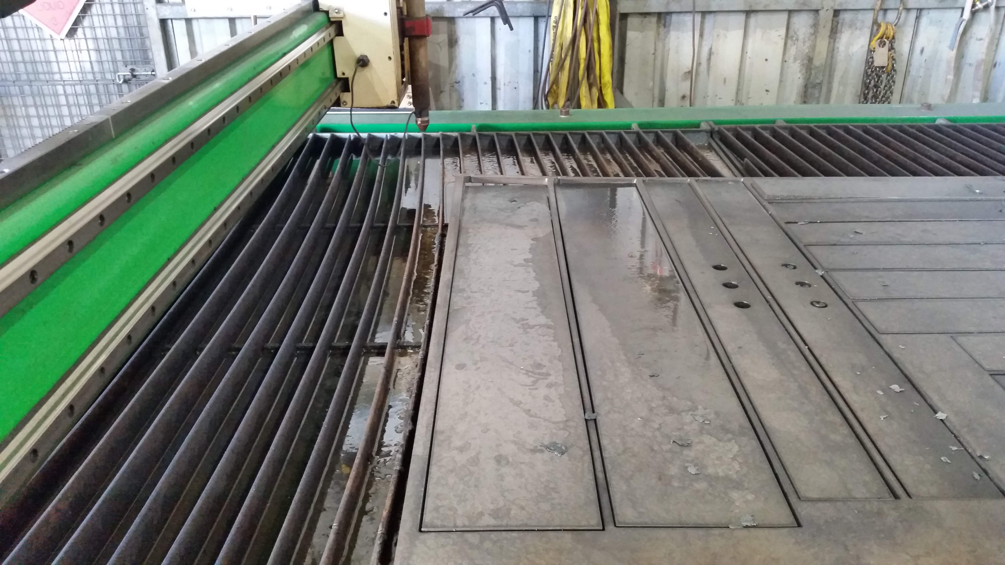

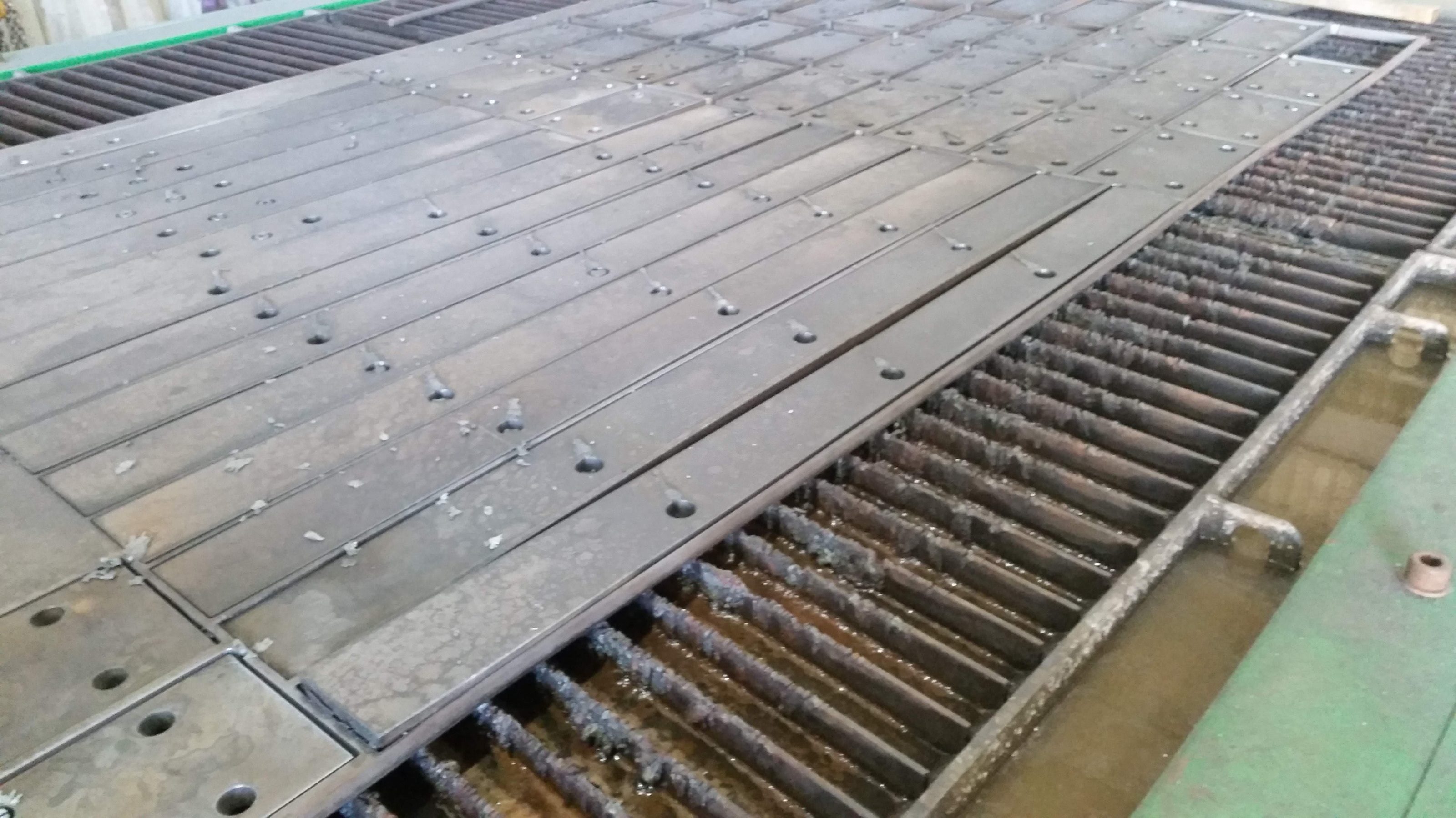

Anther sheet cut by PlasmaC,
Dont let anyone tell you that 16mm sheet does not need THC, On these longer cuts THC works very well,

I like the pics of yesterdays sheet, I must say the 16mm sheet distorted more than I thought it would.
Actually it would be good if any guys who are using the soft arc ok (Mode 0) could let me know their OK High Volts and OK Low Volts and I could put something in the docs as a starting point for new installs.
Edit: Machine type would be good as well.

Yeah I was surprised when I first cut that thickness with reading on the forums how anything over 12mm does not need THC to cut.
Ive got a sheet of 20mm to cut tomorrow which usually stays flat but ill see how it goes.

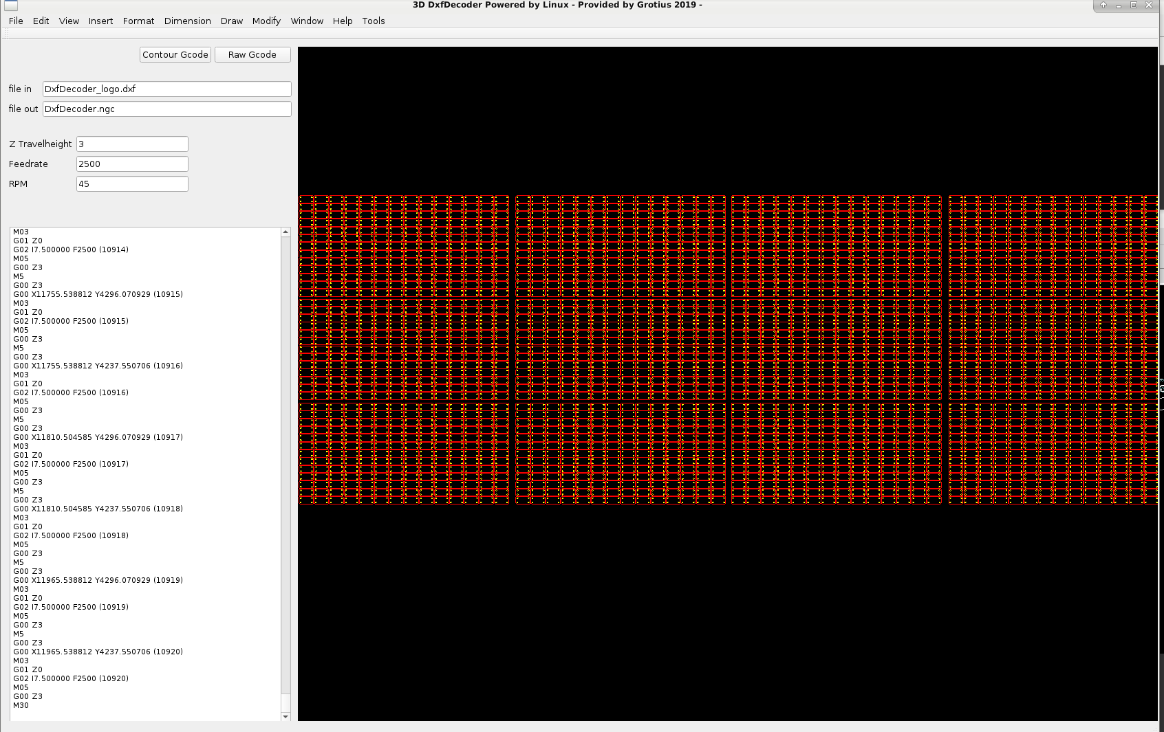

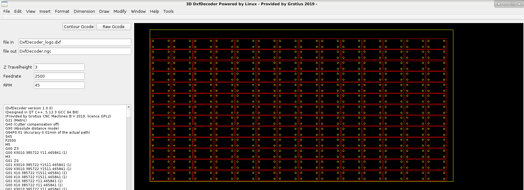

I see your picture of all the strips. I tested this tonight on the free dxfdecoder cam program, wich is in progress, not fertig...
Do you work with G40, G41 and G42 offset's at the moment?
Grotius,

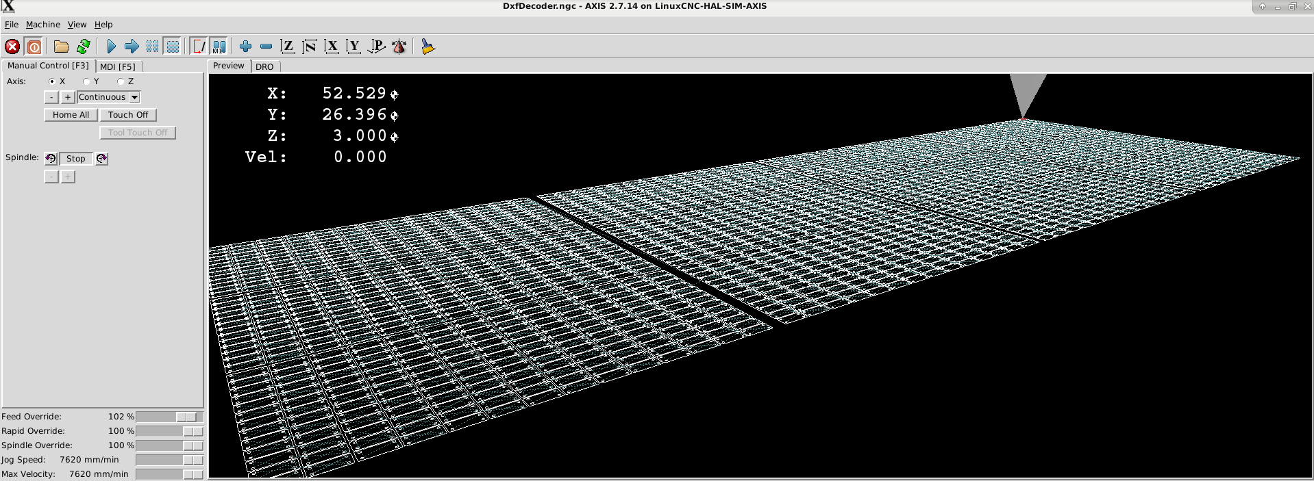

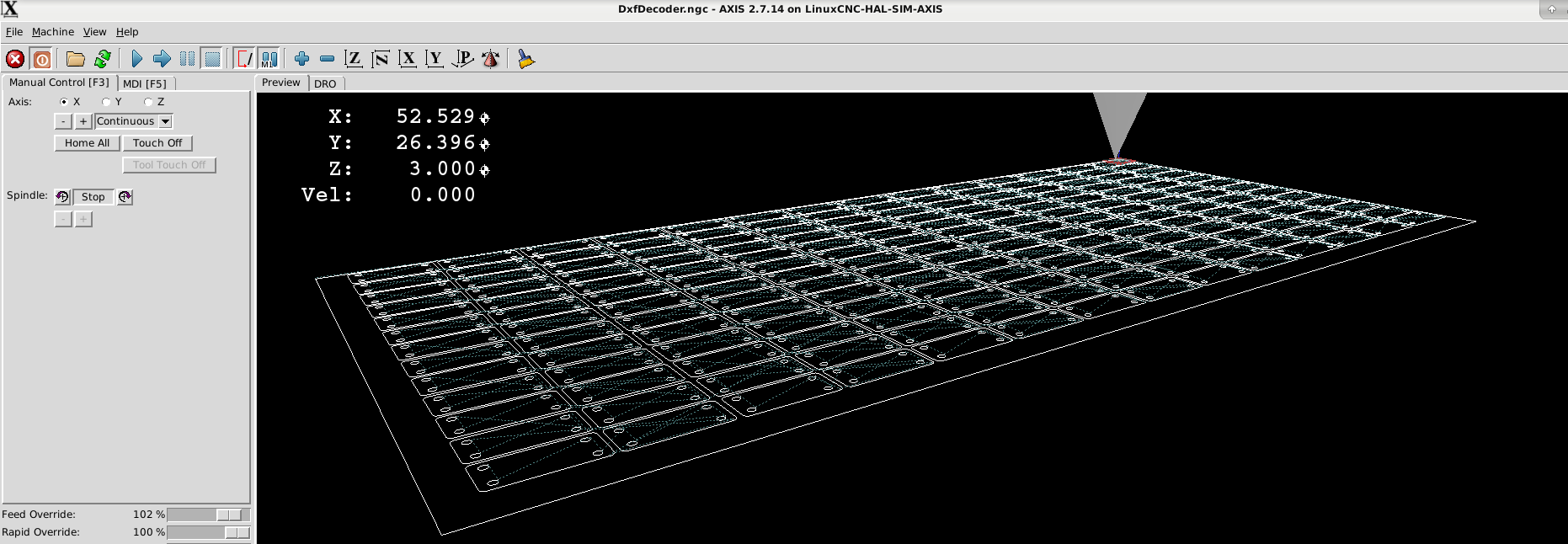

Stefan.
Thanks for that. With this info i can make a matching PlasmaC gcode output. I will work on that.
M3 S69
G1 Y208.926
M62 P2 (DTHC OFF) (On small circles)
G2 I0.000 J11.000
M63 P2 (DTHC ON) (On small circles)
X26.211 Y209.645 I0.000 J11.000
M5
I expected z value's. But Phill is so smart to do the torch height control only with M3 and M5. I do it the same way in other
component.
There is no "z" character in the whole ngc file.
I prefer to use the tool kerf offset's in the future. I will work on that.
For the rest i mentioned that the DxfDecoder does the job with one button press.
Then you can reload the axis gui with Control-R.
Sheetcam is a very good program. For new users it would be nice to start with a free program coming time.
It saves them money. They could donate to the forum. But the forum is not Php.....
One thing to mention for your post processor : P0.254 could be better P0.01

I tested just some more plates. 12 plates of the same product.
12 plates of 182 products : 2184 product's in one file.
File lines : 113.578
Free download of this software is in other thread. I will stop polluting now.
