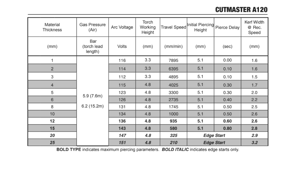

- Posts: 12163
- Thank you received: 4151
02 May 2019 09:55 #132502
I'm actually struggling with this. I have about 6 different tips for my machine. (30A, 40A, 60A, 80A, 100A, 120A) Here is the metric cut chart for my machine with a 9-8211 (80 amp) tip
The key parameter we want is the Tool Diameter or kerf width
There are 10 different kerf widths for this tip alone.
The kerf widths for mild steel for my machine range from 1.4mm to 4.4 mm. I think I'd have to create a series of 30 odd tips 0.1mm apart that don't really relate to anything.
I'm not thinking the tip definitions add anything other than complexity.

Replied by rodw on topic Another plasma component...
Guys,
I have a mostly working concept for tool handling in the configs.
I personally think unless you moved to a fully relational database, what we need would be met by simply adding a unique ToolID and a kerf width to the existing materials table records.

02 May 2019 10:14 #132503
by BigJohnT
Replied by BigJohnT on topic Another plasma component...
I'm using a database for my plasma cut data on my GUI just for that reason that there are so many different options and kerf width changes with material, thickness and nozzle.
JT
JT
