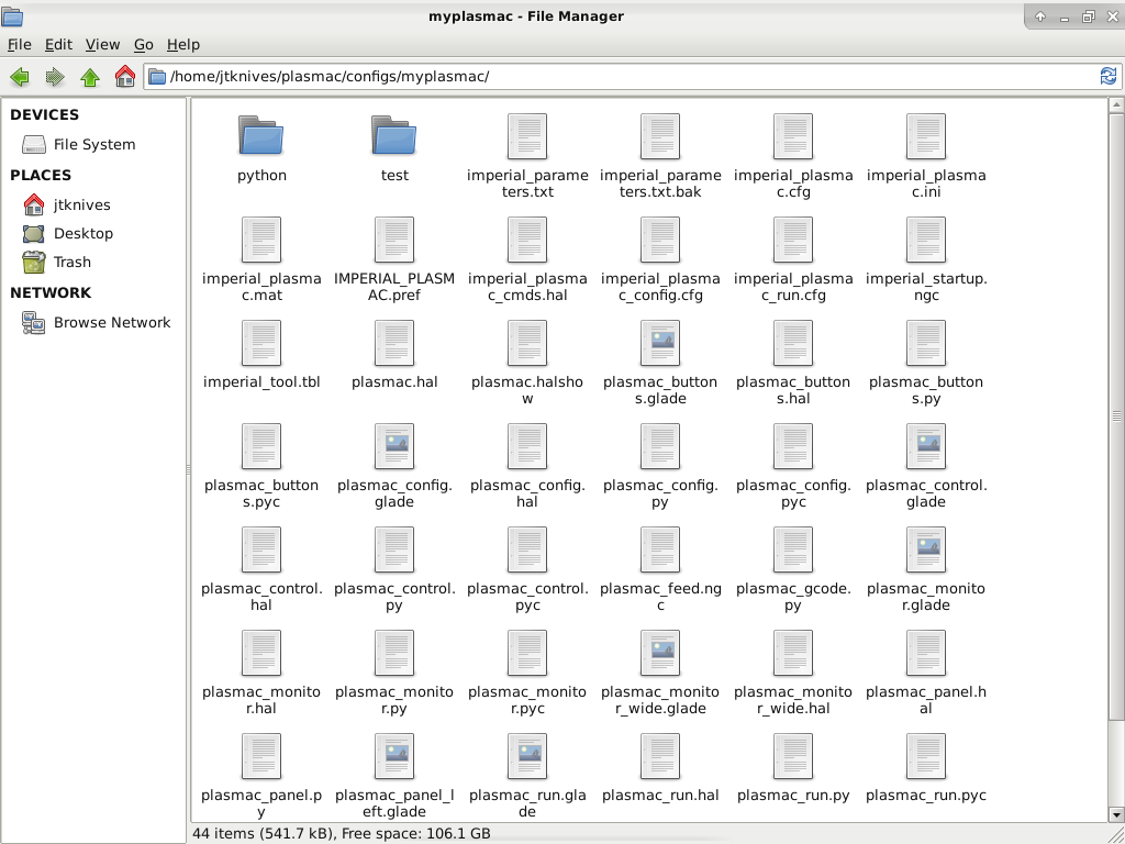

28 Apr 2019 15:19 - 28 Apr 2019 15:23 #132180 by JTknives
Replied by JTknives on topic Another plasma component...
Last I checked the plasmac branch uses both EO (now incorporated in the master) and reverse run.
Without working .hal and .ini files we can only get to all of the copying that will be needed to start building a working configuration. To start with make a new directory, say myplasmac or what ever you want, under ~/plasmac/configs/ using either a terminal or your distros file manager program. So by my example you will need a directory ~/plasmac/configs/myplasmac. Then copy all files and subdirectories from ~/plasmac/configs/sim/gmoccapy/plasmac/ to the directory you just created. Now you can cut the work in 1/2 if you are only going to use imperial or metric measures and not both. Delete all the imperial... or metric... files and links from your new directory and leave the system you want to use or leave both. The next part is a little tricky. Many of what you thought are files that you copied are actually just links to the real file and they are broken. I find it is easier to use your distros file manager program to make new links and replace the broken ones( they will usually have some sort of broken symbol if you use the icon view). Most of the files you will need to link to will be in the ~/plasmac/configs/sim/axis/plasmac/native/ folder. Once you have all the files copied and the broken links fixed we will be ready to make your working configuration.
My crystal ball is a little foggy lately so I really need you to post working examples of your .hal that has everything for your machine motion and physical I/O in it and the .ini file that calls it. I can post mine if you want to work it all out yourself but it is very confusing because of my pendant, gantry mechanics and hacks to allow limited control from Gcode.
John
Ok, I started to fallow your instructions and got the new folder created and the files copied over from the sim area. But i don't see any broken links. I tried opening each "file" and thy seamed to open fine by just double clicking on them. Am I missing something? Here is a shot of the new folder with the copied files. Also i do have working .hal and .ini file that moves my machine. I think I still need to tweak them to get proper dimensional moment, acceleration and what not.
Last edit: 28 Apr 2019 15:23 by JTknives.
