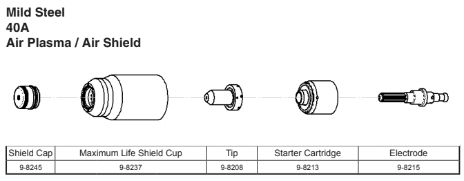

Phill, I don't think you need to worry about tracking nozzles. On my machine, they go hand in hand with the amperage chosen. eg 2mm 40 amps = 40 amp nozzle, 2 mm 60 amps = 60 amp nozzle. I have seen some posts that put some comments in the code to remind the user. I guess they use a pause or something.
You'll be please about that as I have about 7 tips I can use.
If I'm lazy, I can avoid changing out a nozzle by changing the selected material at a different amperage.
I did think about scanning the cut charts page diagrams of the consumables that show the part numbers and including a link to the image in the materials file. But all 40 amps mild steel would display the one image regardless of thickness. If there was an image included in a cut chart entry, you could unhide a button and display the image in a popup so you knew what parts you had to install.

This is what I had in mind. Include an image file name like this for a given entry in the tool table
This would be very useful.
