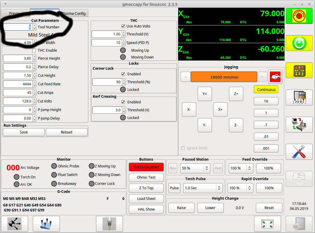

06 May 2019 07:29 #132927 by rodw
Replied by rodw on topic Another plasma component...
Phill, I've now got the new version installed. Its a bit manual for me as plasmac and the spaceship are fighting over the same signals.
Does glade allow you to display 2 fields in a dropdown eg. Tool number and name?
We seem to have given up a lot of usability when implementing the tool table. I know most languages I've used allow this. eg. revert to a drop down with tool number and name on the one line
So if you have 200 or so tools in the table, this will become fairly unwieldy as you'd need an index card beside you to choose the tool you want.
