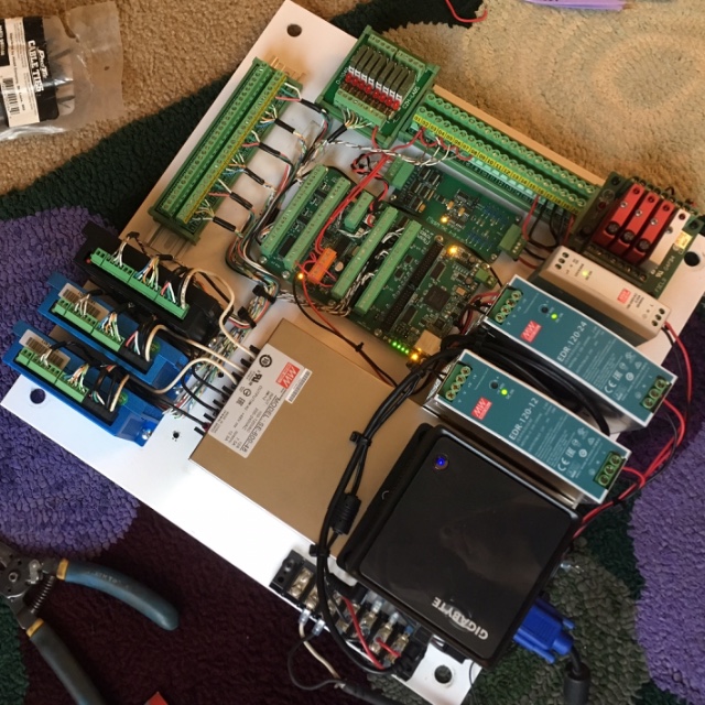

Like the idea of a material library. I think my situation will be diffrent then most other people’s. I will be cutting a vast selection of steels and stainless steels. Being that I deal in knife steels there are all kinds of flavors in both carbon and stainless, As well as thicknesses. So getting it set up so each “material” can be saved would be helpful so I can tweak perfect setting for each one. Now is there a way for the material list to store cut rate as well. Some of the stuff I will be cutting is .062 up to around 3/8”.
09 May 2019 01:21 #133213 by rodw
Replied by rodw on topic Another plasma component...
Jt knives, this is already supported on the plasma run tab. You just need to add your description for the material to the new xx_material.cfg file on the new version. I use something like "2mm Mild Steel (40 amps)" as I might have settings for the same metal at 60 amps. So basically, a postprocessor (eg sheetcam) just needs to know the material id number to select it.

Thank you. I’m still in the process of trying to get my damn controller to stick to my plasma table . It keeps fallowing me back into the living room.
