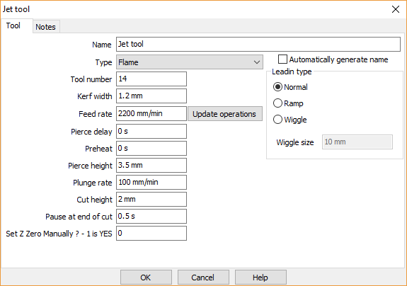

Actually, I think all of the settings exist in Sheetcam. Under the tools dialog box, click on new tool and select flame tool and configure itr including ramp in.
Then catch those variables in the post processor and pass them to the gcode touchoff function.
Let us know what is missing in this screen.

And the last variable displayed on that screen is created in the post by this line
So it is easy to add any extra variables to define the behaviour the OP wants.
Sheetcam is very powerful.......
post.DefineCustomToolParam("FlameTool", "Set Z Zero Manually ? - 1 is YES", "manualZSet", sc.unit0DECPLACE, 0, 1, 1)So it is easy to add any extra variables to define the behaviour the OP wants.
