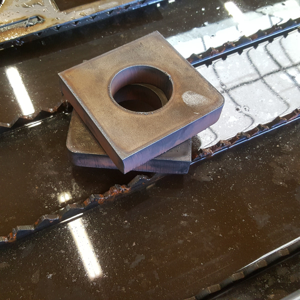

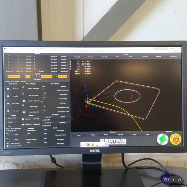

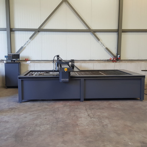

Just for info what linux is capable to, thanks to Mr. Chris Morley, for making his user interface python code.
Without his magic, it would be problably not easy to go with linuxcnc on this level.
20mm steel test cut during linuxcnc training course today.
Cutted at 105 amp, with powermax 105. First cut without improvement's.
Linuxcnc plasma software application with universal thc component.
A machine that cut's, my last machine of model 2018, up next is new model 2019.

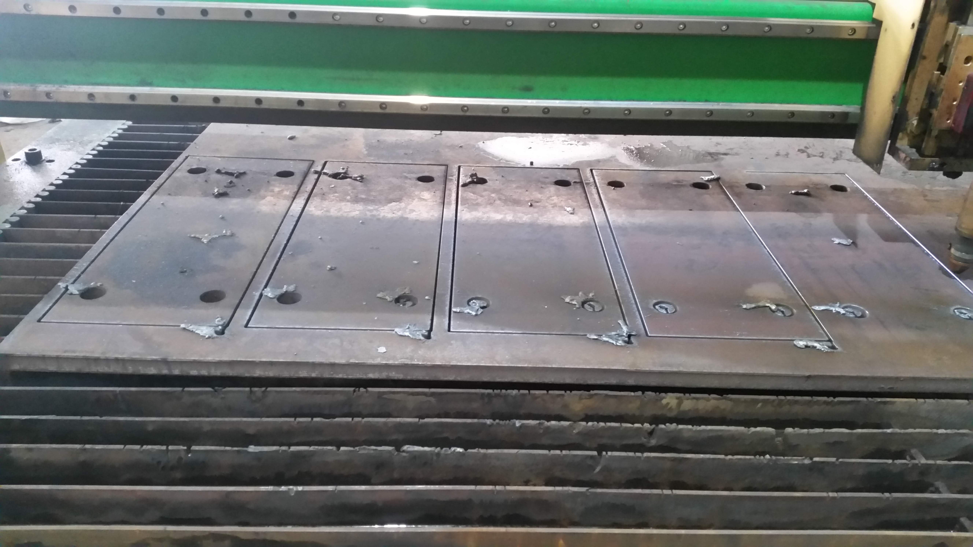

Your machine looks very well built, Did you build it yourself?
With my machine using a Powermax 125 I have been able to cut 25mm plate with the same quality,
What program did you used to generate the G-code? Sheetcam?
Attachment not found

Hi Stefan,
Thanks. Yes me is the builder.
Nice too see your picture's. Very nice output.

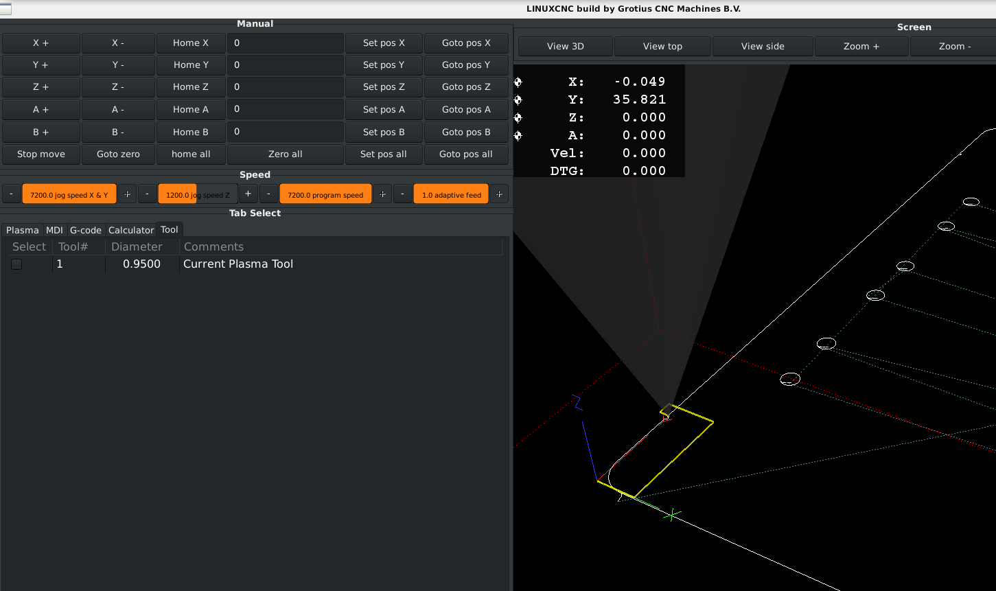

It's generated with sheetcam. I did some test in the past with dxf2gcode to load a dxf straight into linuxcnc without seeing the program dxf2gcode opening actually.
Tonight i did some more test's. I coupled the tool.tbl tool file within the grotius gui python code.So when we are going to use dynamic tool libraries for plasma in the future, the plasma kerf widht (tooldiameter) is actually working nice with (G40/G41/G42) to my surprise. It's has the reloading possibility without restarting Linuxcnc. Just what we need.
In other word's, we can soon do a simple way of cam processing also in linuxcnc for plasma.
What i noticed about the startpoint is, sheetcam wil allway's start at the cone point on the picture, standard. At that point there is a little press brake mark with radius 2mm. But i don't want to start at that point so i have to modify start point's each time with sheetcam. Okey dxf2gcode is starting at outside contour at a better point, without modifiying start point's. So that is nice.
Generated with dxf2gode :
I think goal of many users is open linuxcnc :
1. click button "tool library" or a button name you want to have on your screen.
2. click your way to the database (.odb file) pop up screen's, select dynamic input fields one by one, everything about the tool is set.
-- cutting chart's in odb format. ( python pluging code for acces databases, full plasma tool databases, also editable off-line )
-- the rs485 (modbus connection) to plasma inverter is set this way. ( also for standard modbus i/o module, standard plasma inverter conversion with modbuss connection. )
-- The kerf width is set this way.
-- The real time plasma THC component is set this way.
-- The G1 speed is set this way. (trick is to use this in the python code for reloading parameters of speed :
self.c.mode(self.cnc.MODE_MANUAL)
self.c.wait_complete()
self.widgets.gremlin.reloadfile(None)
The G0 speed is available in user gui. Master speed is adaptive feed -1 to 1. Feed override is set to max tuning parameters.
3. select dxf file you want to cut. (behind this, the dxf2gcode is autogenerated and loaded into linuxcnc)
4. start your machine.
self.widgets.tooledit1.set_filename("tool.tbl")
self.widgets.tooledit1.set_visible("pabcxyzuvwijq", False) #here i say, dont show too much stuff i don't useIn other word's, we can soon do a simple way of cam processing also in linuxcnc for plasma.
