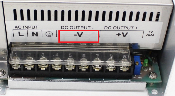

24 Sep 2019 01:22 #146016
by shizyo
Replied by shizyo on topic plasma control panel
Sorry for some silly questions(I am not electronic guy). What does 0v mean in the torch relay and 220ohm resistor in the thefabricator03's schematics? Does it mean that I should not connect anything to 14 on the relay? What about 0v on the resistor? Thanks.

24 Sep 2019 03:36 #146025
by phillc54
Replied by phillc54 on topic plasma control panel
0v means they are both connected to the 0v rail of the COMMON 24V POWER SUPPLY.Sorry for some silly questions(I am not electronic guy). What does 0v mean in the torch relay and 220ohm resistor in the thefabricator03's schematics? Does it mean that I should not connect anything to 14 on the relay? What about 0v on the resistor? Thanks.

24 Sep 2019 04:09 #146031
by shizyo
Hi, thanks for the reply. By the 0v rail of the COMMON 24V POWER SUPPLY, do you mean -V output on my power supply(attached picture)? Thanks.

24 Sep 2019 04:38 #146033
by phillc54
Your -V = 0V on the COMMON 24V POWER SUPPLY
Your +V = 24V on the COMMON 24V POWER SUPPLY
Yes, that is correct.Hi, thanks for the reply. By the 0v rail of the COMMON 24V POWER SUPPLY, do you mean -V output on my power supply(attached picture)? Thanks.
- shizyo
- Posts: 34
24 Sep 2019 06:37 #146036
by shizyo
Hi Phill, I appreciate your help. Please bear with me 1 more question. For the 220 ohm resistor, I need to connect 1 leg of the resistor to TB5-6 on 7i76e and also from the end of this leg, I will solder a cable and connect this cable to 0v on the 24v power supply. Is it correct? Thanks.

24 Sep 2019 06:58 #146039
by phillc54
the other leg could connect to either TB3-24 or TB1-8 as 0v is connected to both of those or -V on your power supply.
one leg of the resistor connects to either TB5-6 or to the socket your cable to the plasma unit plugs into.Hi Phill, I appreciate your help. Please bear with me 1 more question. For the 220 ohm resistor, I need to connect 1 leg of the resistor to TB5-6 on 7i76e and also from the end of this leg, I will solder a cable and connect this cable to 0v on the 24v power supply. Is it correct? Thanks.
The following user(s) said Thank You: shizyo

24 Sep 2019 07:08 #146041
by shizyo
I got it now. Thanks for your help. Have a good evening!

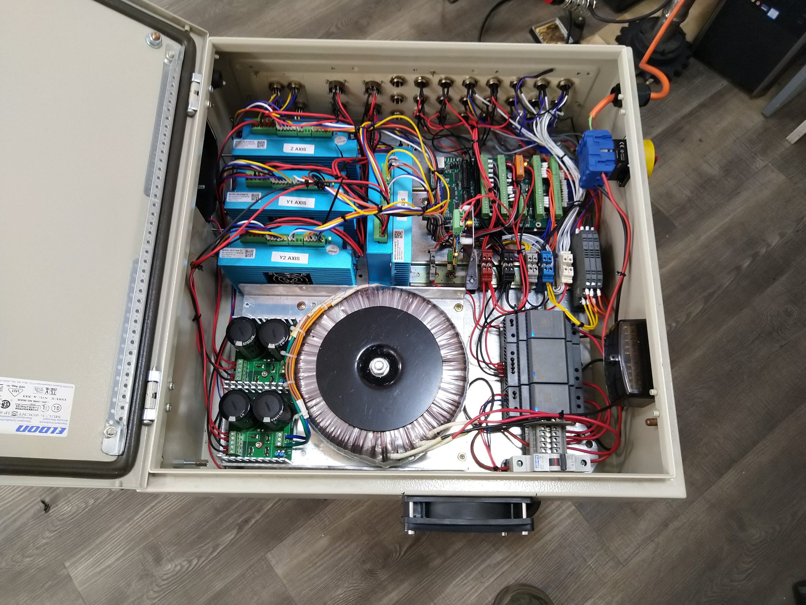

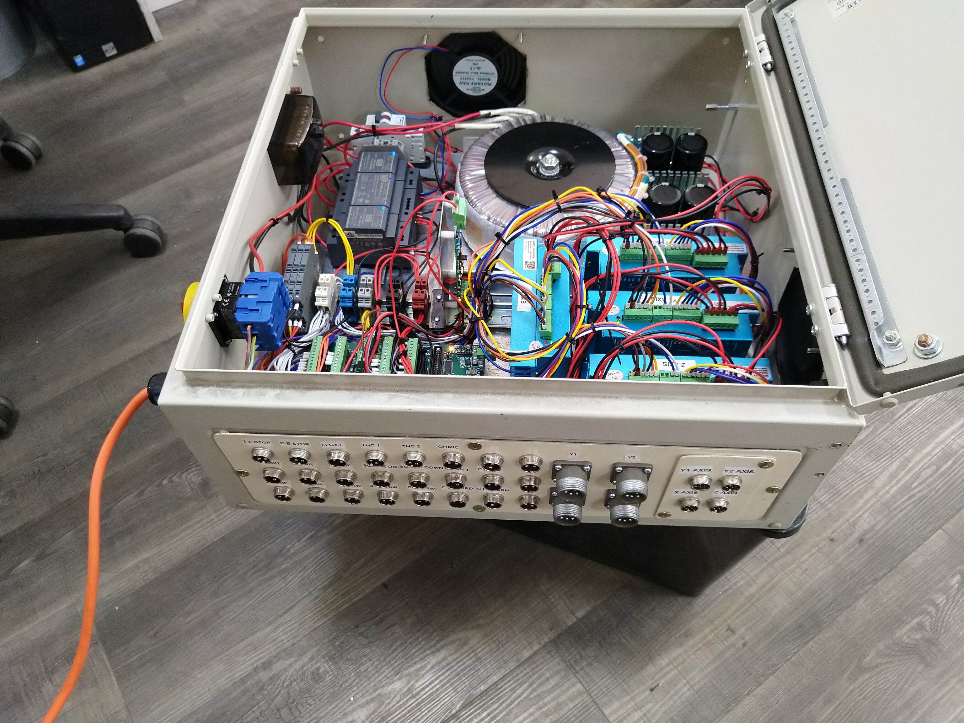

24 Oct 2019 03:09 - 04 Jun 2020 22:45 #148670
by thefabricator03
Replied by thefabricator03 on topic plasma control panel
I have just finished wiring my new closed loop stepper drives into my control box and added Rods hyper-sensing circuit.
I have attached a updated wiring diagram to this post for anyone that might find it useful.
