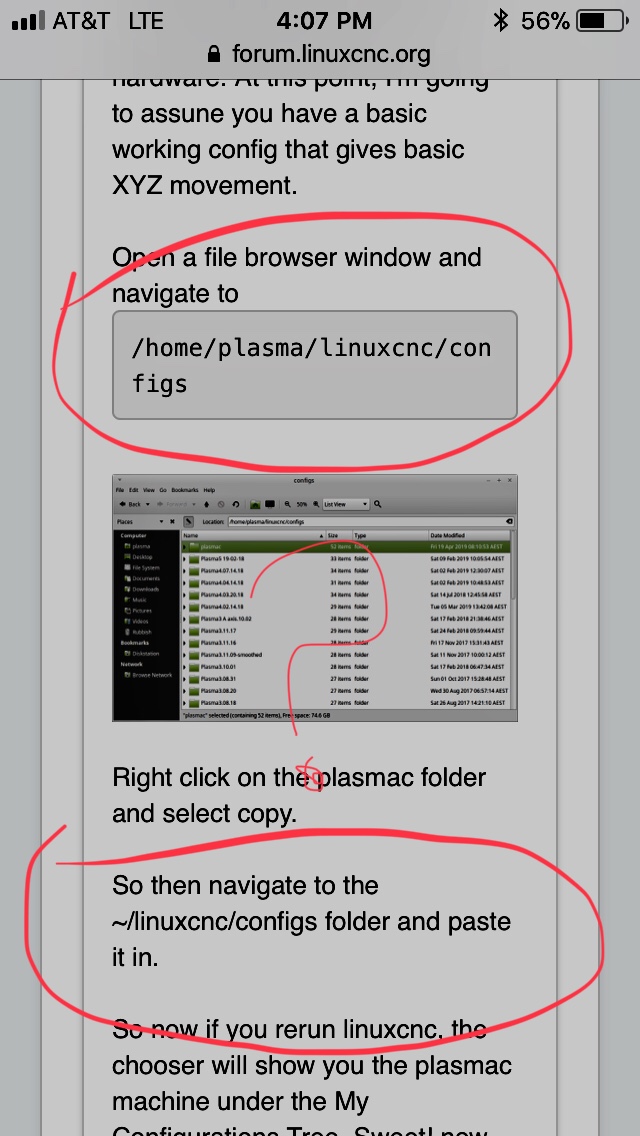

28 Apr 2019 23:10 #132200 by JTknives
Replied by JTknives on topic Installing PLASMAC - Another Plasma Component

28 Apr 2019 23:27 - 28 Apr 2019 23:33 #132203 by rodw
Yes, my mistake. I noticed it this morning but did not want to rely on memory to fix it.. The correct source directory will be somthing like:
~/plasmac/configs/sim/gmoccapy/plasmac/
EDIT: Now fixed in the original post

28 Apr 2019 23:40 #132207 by JTknives
Ok I was just checking. I know just enough to get me into trouble lol. Thankyou for the step by step.
