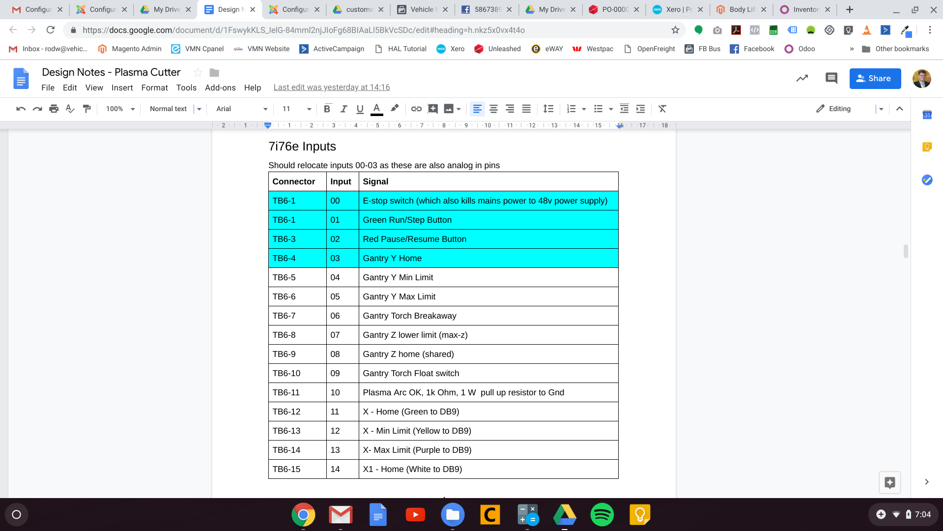

Just looked at your output. You just need to replace the question marks in the hal file John wrote for you with the real pin number. Either use Halshow or use the 7i76e manual. The manual is a bit confusing as the hardware pins are numbered from 1, but the output pins start at INPUT0.
So if you connect a wire to TB6 Pin 5, it will be INPUT4. In halshow, it will be hm2_7i76e.0.7i76.0.0.input-04. You can always check a pin by jumpering field power to it and watching it change state in halshow.

But how does it know your talking about TB6 and not any of the other TB# inputs/outputs.
- Posts: 12153
- Thank you received: 4144
30 Apr 2019 22:09 #132380
Replied by rodw on topic Configuring Plasmac - a complete THC/plasma config for any hardware
Because page 11 of the 7i76e Manual says that Input 4 is on TB6 pin 5.But how does it know your talking about TB6 and not any of the other TB# inputs/outputs.
