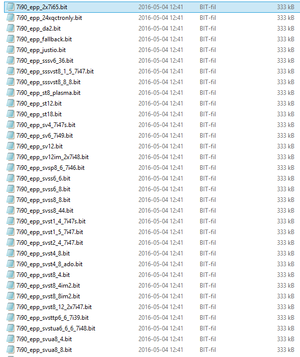

You seem to have flashed with a firmware that has no steppers.
What firmwares do you have available? You need one with both "SV" (for servo, to get an encoder for the TGCAD) and "ST" (for Stepper) in the name.
The file ending with plasma was suggested and is the one i flashed with
26 Apr 2019 17:48 #132008 by PCW
Let me check that bitfile, it looks like sssvst8_8_8
27 Apr 2019 03:24 - 27 Apr 2019 03:25 #132051 by PCW
freeby.mesanet.com/7i90_plasma.zip
Contains the correct bitfile (8 stepgens, 2 PWM gens and 2 "A" pin only encoders on I/O 0..23)
The one in the dist is broken, will fix tomorrow
Last edit: 27 Apr 2019 03:25 by PCW.
The following user(s) said Thank You: tecno

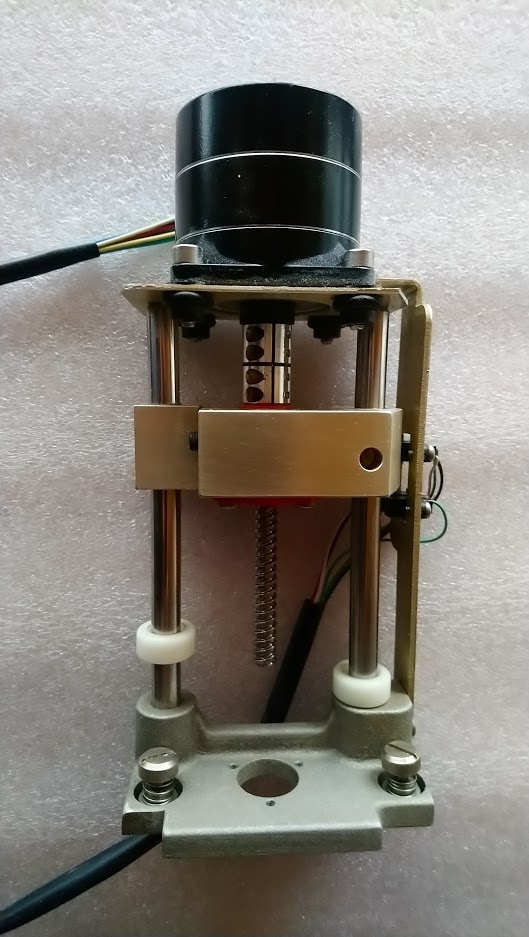

Question
How long Z axis movement is needed for plasma?
I have one linear unit taken out from some kind of dispensing unit with 60mm stroke.

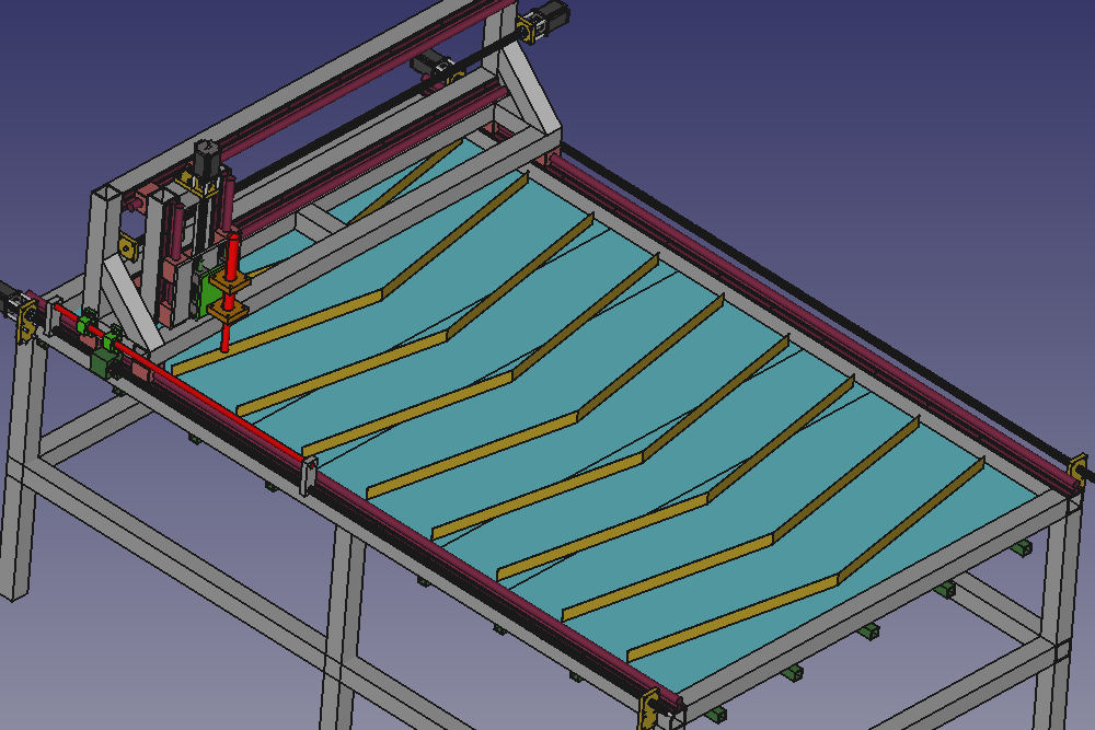

27 Apr 2019 16:27 #132095 by pl7i92
Replied by pl7i92 on topic Low budget plasma setup, what do I need?
nice
here is a drawing of my 2012 plasma its still runing at 3m/min with a total cost of 2500Euro

27 Apr 2019 16:29 #132096 by tecno
Replied by tecno on topic Low budget plasma setup, what do I need?
Nice table, too big for me :(
