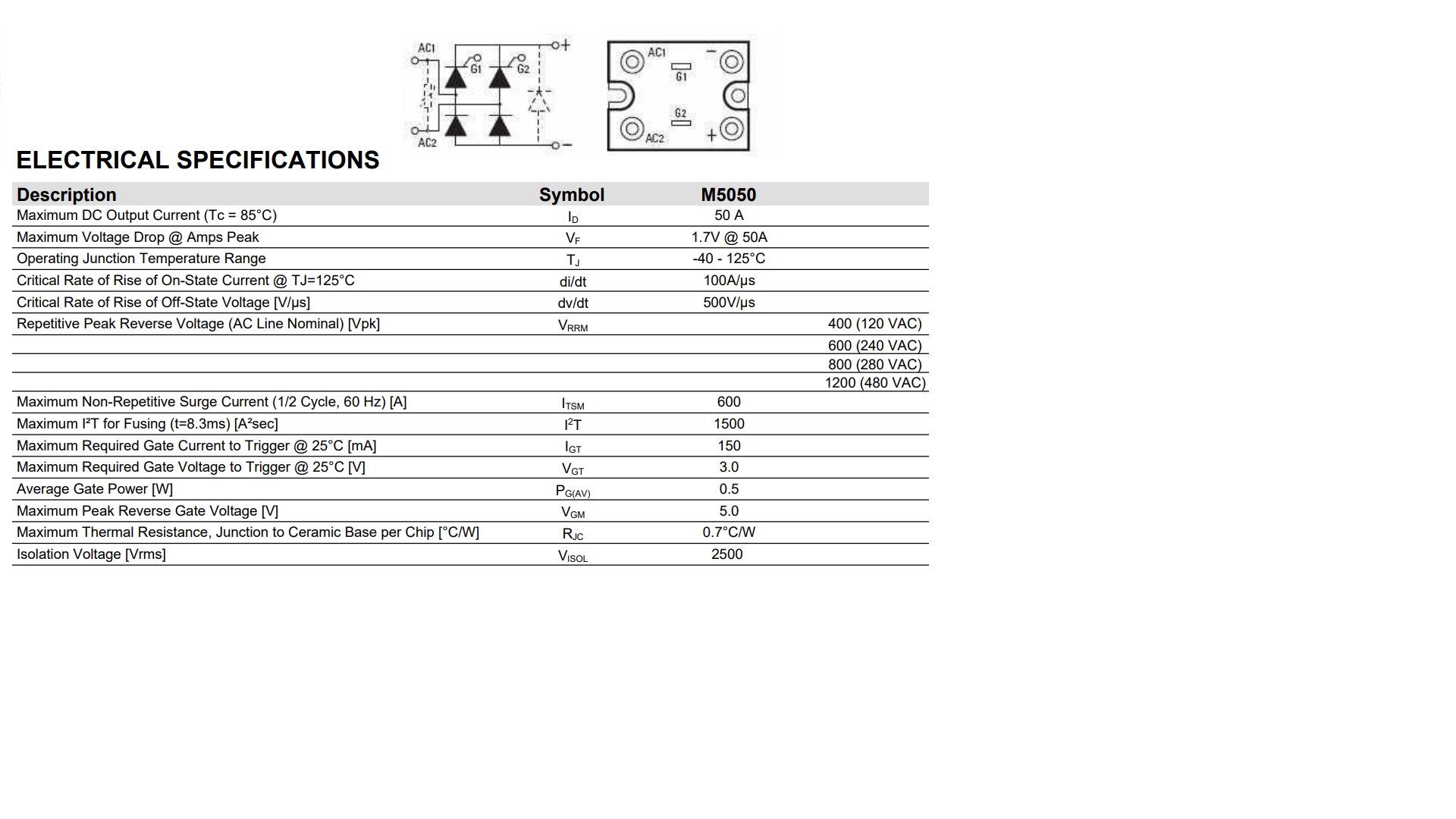

OK, looking across the schismatic i see a few things. First your running the 7i76 off 24v field power and the only other supply you have is a 12v supply for the probing. you run the -12v through the opto and then through a NO relay to the shield. relay one and 2 are both triggered by pin22 on TB6. relay 2 connects the +12v to the work. when shield touches the work the opto goes high and sends field voltage to pin12 on tb6. And your torch "on" is ran through relay 4 which is NO and triggered by pin23 on tb6.
now onto the question(s)
Can I just run my probe sensing through a crydom M505012F. I have 2 just laying around and been looking for a use for them. here is their layout. also my 7i76 is the ED version so its outputs are syncing not sourcing.

The problem with them is that once opened they will remain opened until there is not more current flowing through them and that is something that in AC happens 50 or 60 times per second while in DC it does not until the power is cut off.
Also that is a non isolated type so in the future if you use them, keep that in mind.
Replied by tommylight on topic Inputs & outputs & relays ohmic
Unfortunately no, those are SCR used for switching AC, not DC.Can I just run my probe sensing through a crydom M505012F.
