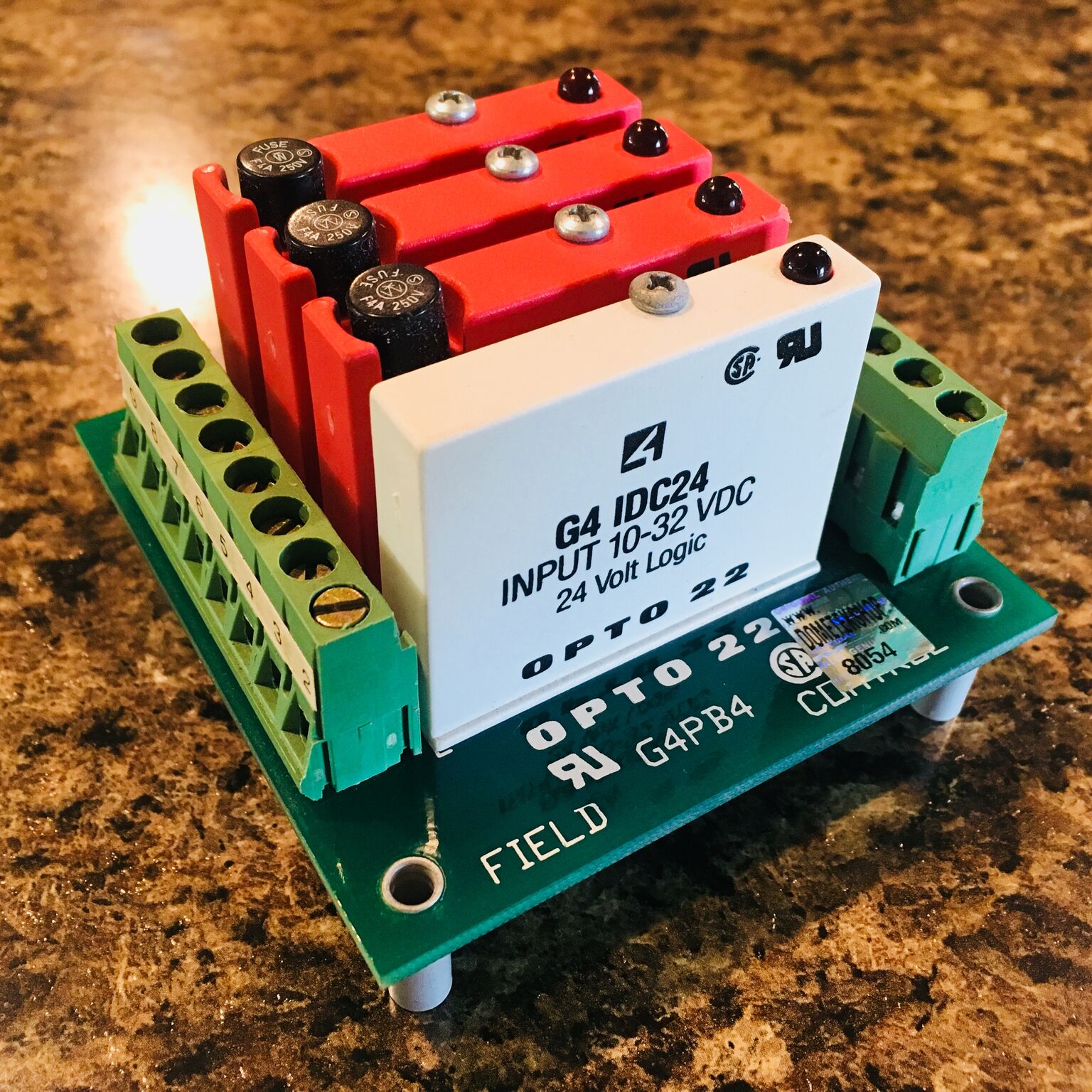

- JTknives

27 Apr 2019 22:03 #132127
by JTknives
Replied by JTknives on topic Inputs & outputs & relays ohmic
So now this brings up another question. I have s THCAD10 and my hypertherm 30XP does not have a voltage devider. My plan was to put the voltage devider resistors in the plasma cutter and then run a shielded wire to the THCAD which is in my main control cabinet. Will there be problems with that plan and having the THCAD10 that far away from the source. I’m half tempted to disassemble the hand torch and build a “machine” torch out of it and tap into the start and arc voltage right at the torch head and run the wires back through the drag chain to the control cabinet. The main plasma lead will also be in the drag chain so I’m not concerned with keeping the functional hand torch feature. I’m just not a real fan of the hand torch sticking out the front or side.
On a side topic talking about THCAD10. What resistors do I need to devide the voltage down to the correct level for the THCAD10. Thanks guys

27 Apr 2019 22:52 #132128
by islander261
Replied by islander261 on topic Inputs & outputs & relays ohmic
Well that Opto board should take care of most of your I/O needs. Get the polarity right and one of those output blocks can be your torch on control.
The THCad 10 manual has instructions for dividing to the correct input ratio. My THCad 10 lives in a shielded box out at the plasma power supply. My home built voltage divider is on a piece of perf board inside the power supply. The voltage divider and THCad 10 want to be close together for best performance.
The way I remember HT hand torches being built I think you will be in for an ugly kludge no matter what you do. Just mount the damned thing the way everyone else does and make your connections at the power supply end of the torch lead.
John

27 Apr 2019 23:05 - 27 Apr 2019 23:12 #132129
Replied by rodw on topic Inputs & outputs & relays ohmic
I don't think it will matter that the resistors are located in the plasma cutter. I would just tap into the wires going to the electrode terminals inside your plasma cutter and place half the required resistance on each terminal. Most plasma cutters with a CNC post also present the raw voltage on the interface but usually have a 100k resistor on each side (which needs to be counted as part of the total THCAD resistance).
I have run raw arc voltage in my 120 amp machine with the THCAD-10 in the control panel without any problems.
I think what I'd do is mount the resitors in the plasma cutter housing and add a multi pin socket on your plasma cutter (eg CB radio microphone style) and place the THCAD-10 in a metal jiffy box like islander261 has done with an input and an output socket. You should be able to intercept the torch on signals inside the plasma cutter as well and bring them out to that port. Then steal some 5 volt power from a stepgen on your 7i76 and send that back to the jiffy box to power the THCAD.
If you want to take this one step further, mount an ACS758 current sensor on one of the electrode terminal circuits and power it from the 5 volts as well. Step the signal up to 24 volts using a LM358 low signal amplifier and connect it to an analog input on the 7i76e. That way, you will be able to pick a current threshold and synthesise your own ArcOK signal in HAL.
THe ACS758 and LM358 are available on ebay as prebuilt modules so you don't have to worry about designing a circuit! I bought thes units with the intention of doing something similar...
