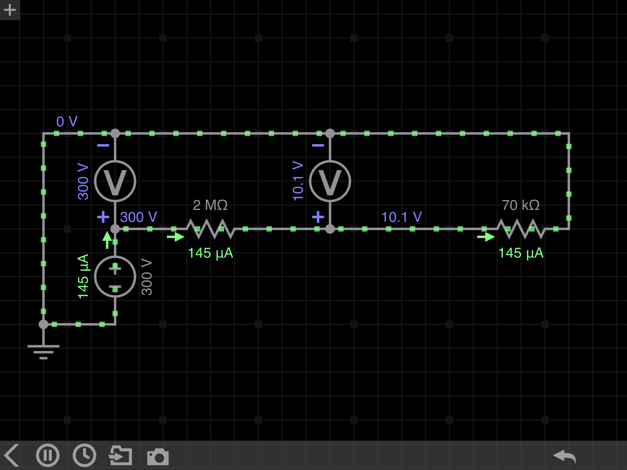

So this is my thought. If you ran a resistive voltage divider circuit like this then it would technically only output 10v max. You would use the aproporate ratio to achieve the proper voltage division and adjust the resistance of both to control the max load depending on what the thcad10 needs amp wise.

I strongly recommend you don't use your own divider and just use the technique described in the THCAD manual.
From experience, the THCAD is likely to see some of the scaling resistors as being part of its own network and then will deliver erroneous results. Something I learnt the very hard way. Mesa give you some instructions so just follow them and you will be fine.

OMG it just hit me looking at the THCAD10 and their paperwork. This thing does not read voltage it’s reading micro amps “ua”. This is why you can get funky scaling with voltage dividers. And also why thy don’t say you have to balance the resistance on each leg. It makes perfect sense now and why their calculation is so simple. Your just adding to their resistance and you back calculate the needed resistance to have your max voltage give 100ua. Because 100ua=1mhz. So thy are not picking off any voltage like I thought. That’s why you take your voltage and subtract the 10v that it’s allready compensated for becaus 10v/100,000k=.0001 which is 100 micro amps. Take 300v subtrack 10v and that’s 290v/.0001a=2,900,000omes or 2.9 meg ohms. This also means that if you put the resistors in the plasma unit and ran the line to the THCAD in you control box you would only have 300v@100ua. Current over 10ma will create a painful shock but 100-200ma is required for it to be lethal. So the current in that line is .1a(minimum lethal)/.0001a=1000x under the minimum lethal amperage.

I suspect this is why if you look at Everlast, Hypertherm and Thermal Dynamics all put a 100k resistor on each side of their raw arc voltage outputs. It does not really matter if the resistance is on one side or both, as long as you count it all, but it was the safety thing that made me suggest you split the resistance to both sides inside the cabinet.

Well it's been a long time but he last time time (1991) I was involved in designing personnel safety circuits (not he machinery protection one you are quoting) we had to interrupt and quench in < 5ms and the trip current was 5mA. This also involved rather long cables with significant capacitive storage ability. Please put 1/2 of the resistance in each leg inside of your power supply to be safe.

As Rod And John said, use 2 resistors, one on each line.
