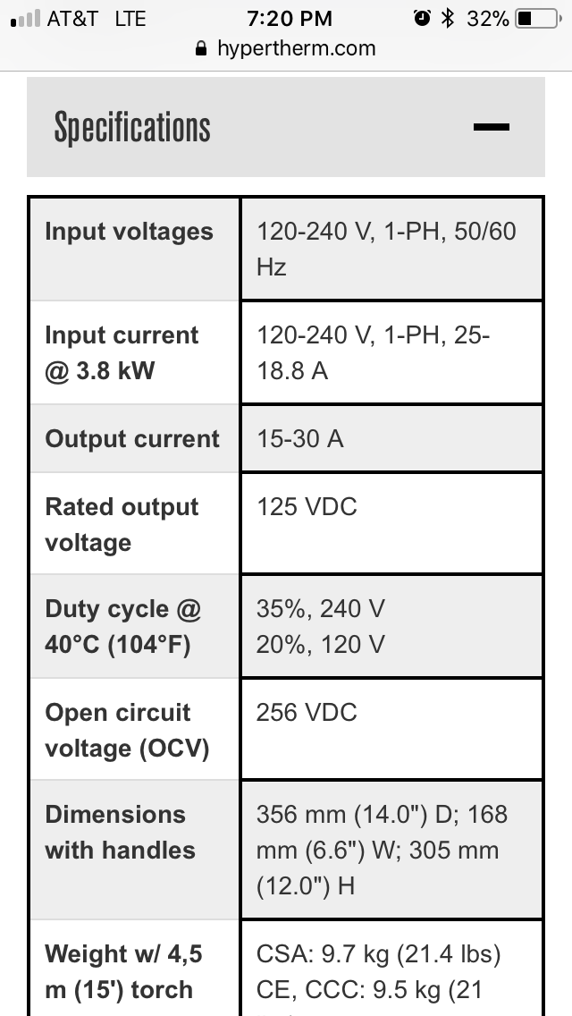

I had just thought that putting the voltage devider resistors in the plasma unit would reduce the voltage coming down the line to the controller and I would not have the dangerous voltage and amps exposed in a external wire. Yeah my plasma is a 30XP so no high voltage start. What is the max arc voltage of the 30XP. I thought it was 300v but I guess I’m wrong. Thanks agian guys.

Well I haven't taken one apart but given the way it is rated I would guess that on 120VAC input they use a voltage doubler circuit. So a full wave capacitive input power supply with 240 input has an approximate maximum output voltage of 340VDC (at arc start only). Now when the unit is cutting this will be far less around 125VDC for the usual HT air plasma voltage. I would shoot for a voltage divider in the 15:1 to 20:1 range, the THCad card is very tolerant of over voltage inputs to greater than 500V.

As long as you have resistors internally on each leg I would not be too stressed about the raw arc voltage leaving the plasma cutter as all of the machines with a CNC port do it. The resistors will take the sting out of it
As far as arc voltage goes it seems your machine has a max voltage of 125 volts. This sounds about right to me. Here is a plot of my old 50 amp everlast machine. If you zoom in, you will see the dotted line divisions and they are 20 volts apart. The white dot is at 100 volts. You can see there is quite a peak on voltage at the beginning of the cut before it settles quickly.
I'd set the max volts to be about 150 volts. PCW says its quite alright to allow the voltage to exceed the full scale reading in this start up phase as it gives you more resolution and you are not using it to control a THC at this point in the step. I like to see the THC to come on about 1.5 seconds after a cut starts to skip this voltage peak.
