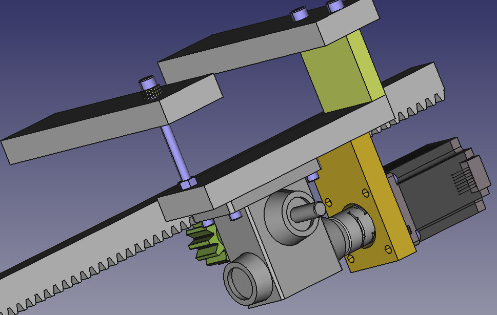

When you say your travel radius is 15mm, does that mean the radius of the pinion is 15mm?
What module gear and how many teeth on the pinion? Take it from me, its easy to make a mistake with the maths. What I thought was 30mm ws actually over 90mm per rev! Double check by marking one pinion tooth and roll it along the rack and measure with a ruler. I was way out! Give me those numbers and I'll check your maths.
Once I was alerted to the mistake I made by people on this forum, I had to refabricate my Z axis to include a reduction gear.
Its not about the accuracy, its about avoiding the slow RPM's that causes uneven movement which is a feature of steppers.

I boght module 1 racks and intend to use pinion with 15 teeth.
Pinion Module 1
Diameter d should be the travelling diameter, which makes my calc already wrong since I used that as radius!!
I was wondering why yesterday it was just the half:blink:
As mentioned the youtube video the guy is using no reduction gear and 15 teeth pinion on module1 rack.
Thx for the mounting information.

You have made the same mistake as I did with the maths but I actually built my direct drive pinion and never used it! See this thread
forum.linuxcnc.org/30-cnc-machines/31509...pinion-drive?start=0
The distance traveled by your pinion per revolution is module 1 x 15 teeth x pi = 47.12mm per revolution. Measure it on the rack to see if I'm correct
The sweet spot for plasma most people suggest is about 25mm per rev. Tommy on that thread says its from 10-25mm per rev. So your machine would benefit from a 2:1 or 3:1 reduction gear which would give 15.6mm or 23.5mm per rev.
Good luck with it!

you shoudt better calculate not on module
use the D0 diameter from the table of the manufacture and calculate by PI
there are Metric Rack pinions that have a real precice workmessurments i use T5 or T10 Metric rack pinion
with the spring tighing system to the Axis it is so precice i never expected that at the speed and precision
even after 2 years we decided to go Gantry and the second gear has been the same

if you can go for it use the DM566 original leadshine >20m/min
if you are on low budget go for M542T abaut 10m/min
if you are even lowest use the TB6600 at 8USD with 36V and 3Nm Nema24 Steppers at 6m/min
