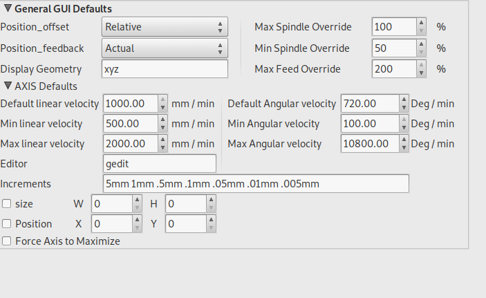

i'm a bit rusty, but pretty sure that jog speed is determined by DEFAULT_LINEAR_VELOCITY in your ini file and its a lot lower than the MAX_VELOCITY you have in your joint configs. I kept the jogging a bit under the max velocities.

thx, funny it does not allow me to go higher on DEFAULT_LINEAR_VELOCITY, jumps always back to 1000 max...

The speed of the motors is clear I only use pncconf which limit to velocity 2000mm/min max and 1000mm/min default which is slow.
So no problem with that, I asked Chris so he will maybe change since I like the wizard a lot.
forum.linuxcnc.org/39-pncconf/38556-defa...ocity-limited#159847
2000mm/min makes in my setup approx 2 rev/sec 33mm/sec travel distance 1.3 inch/sec.
I will see today.

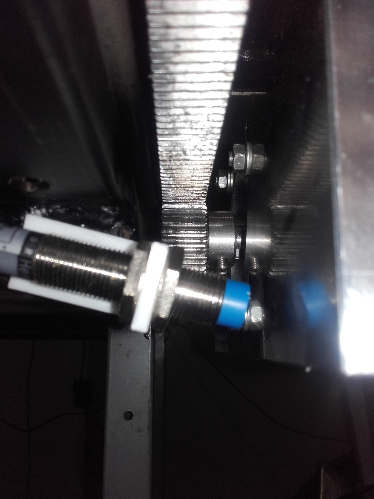

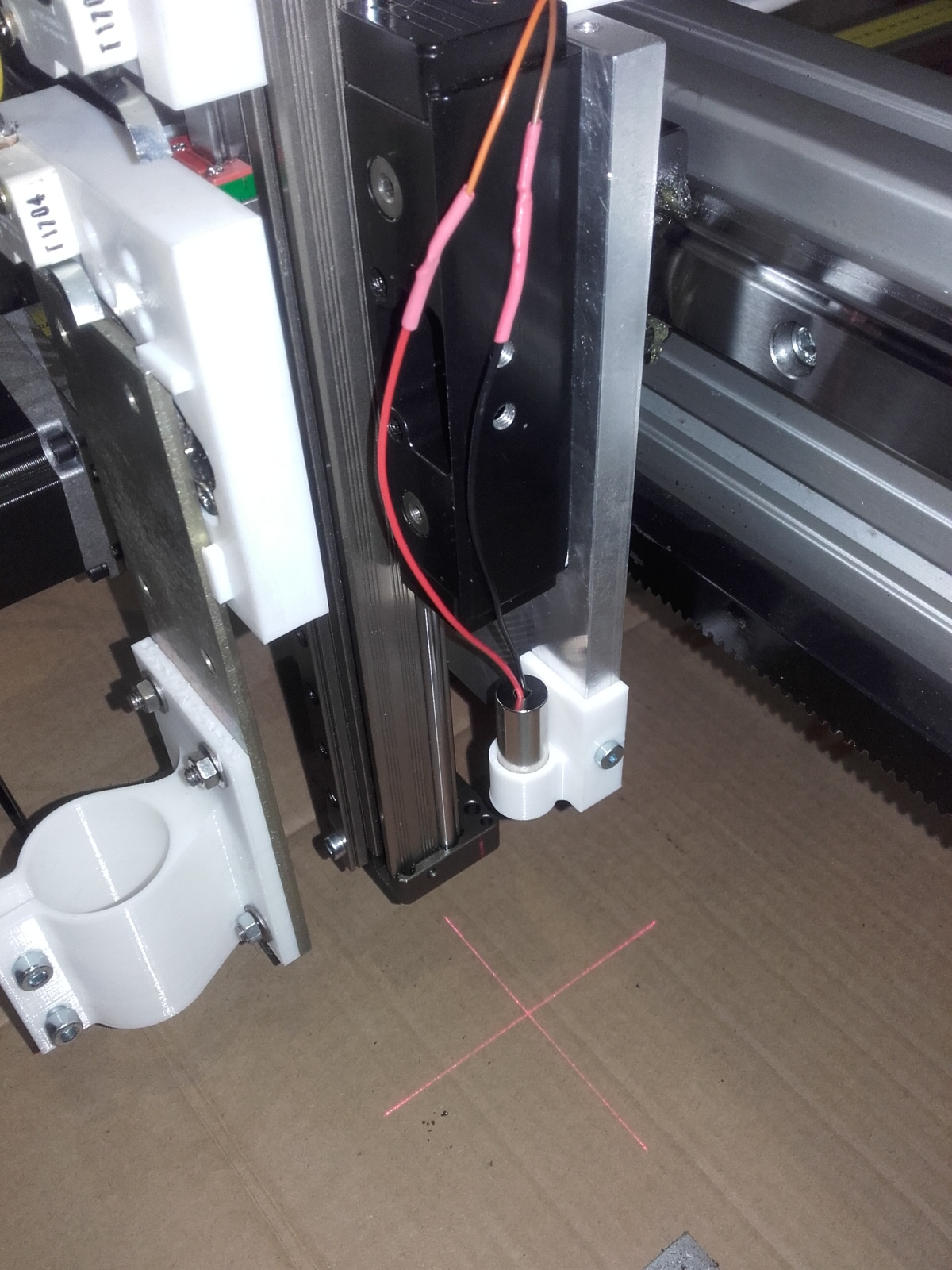

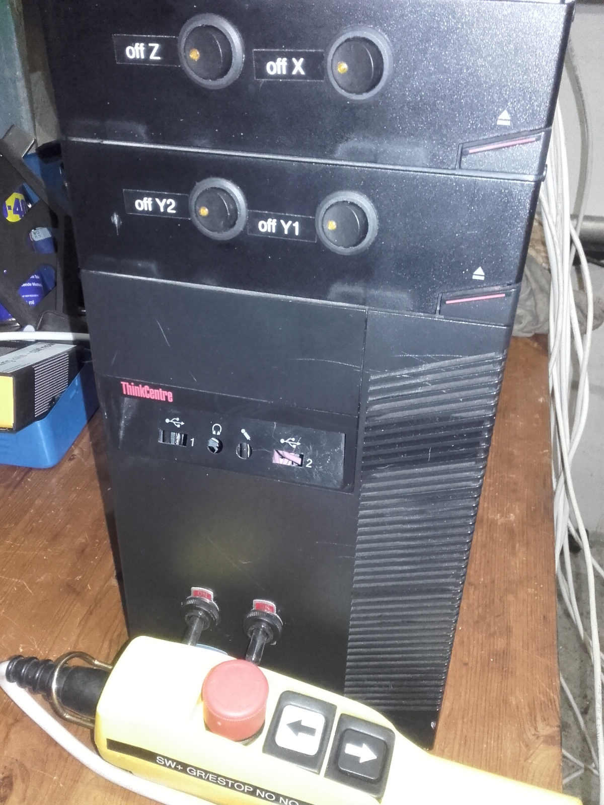

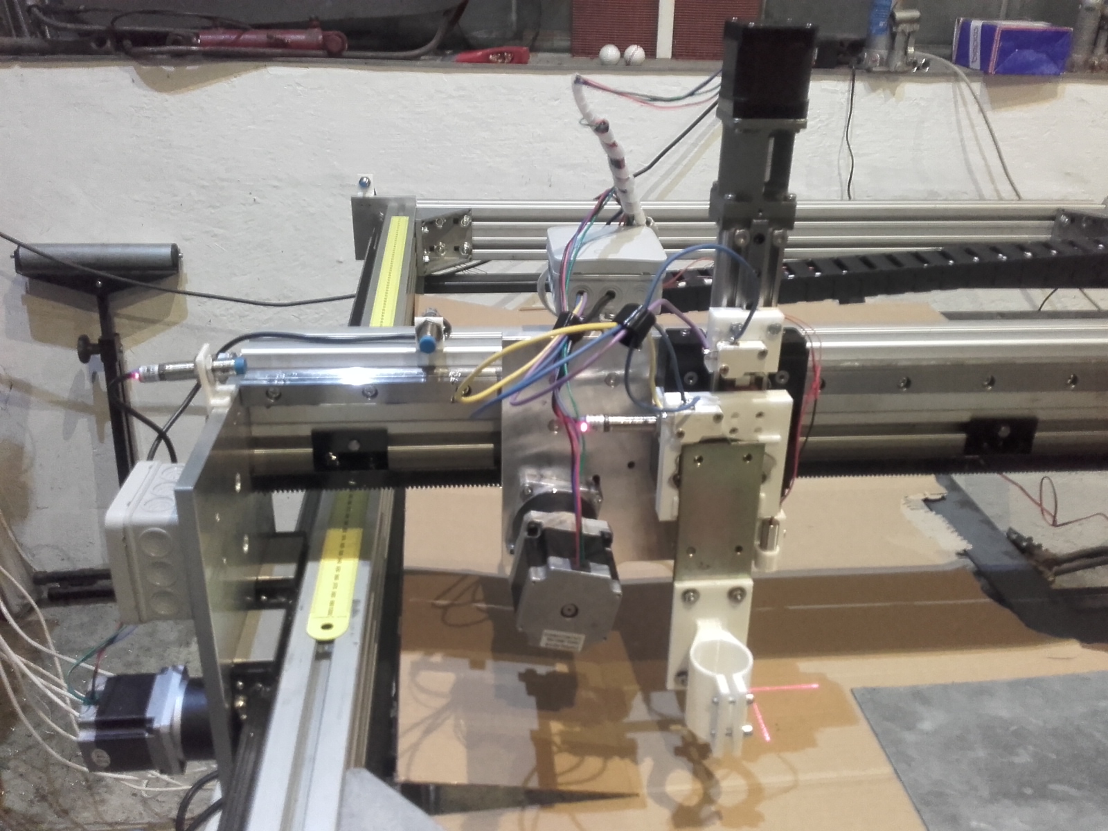

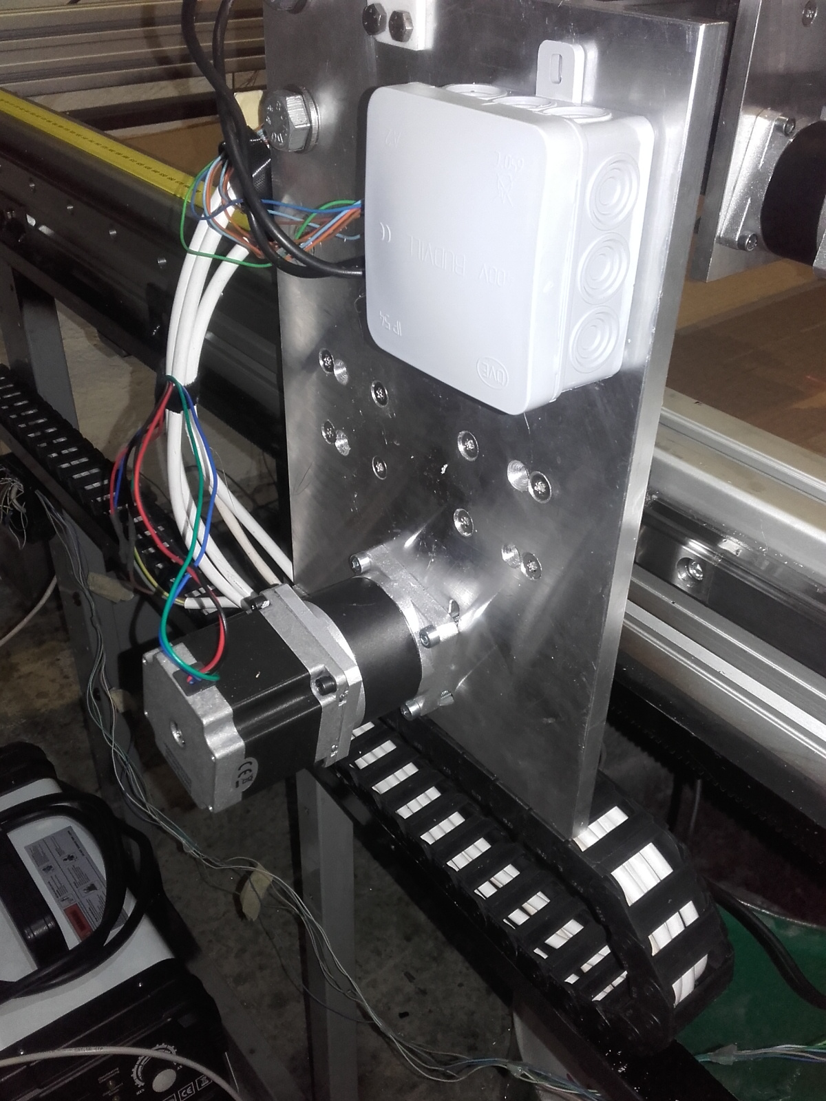

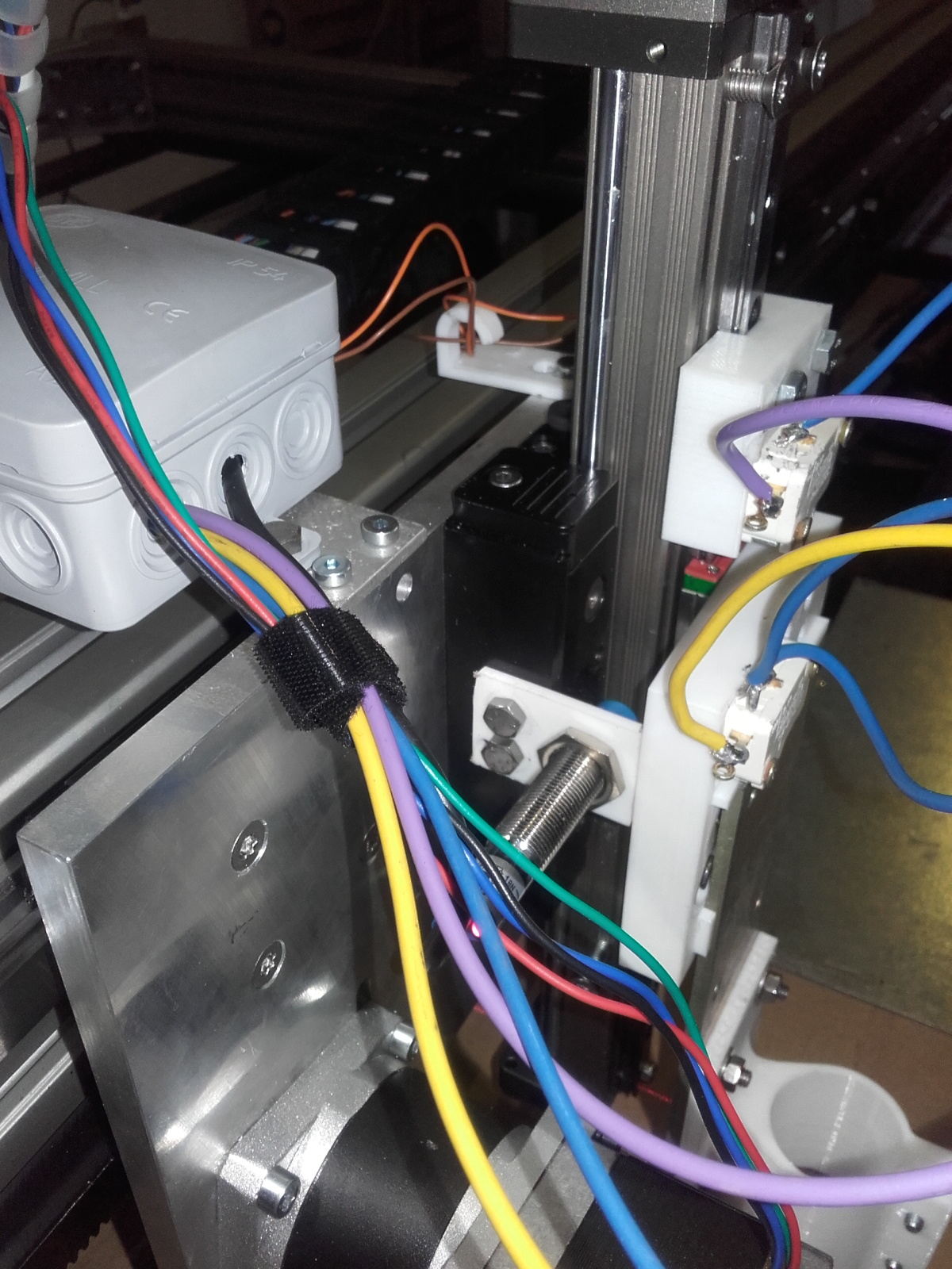

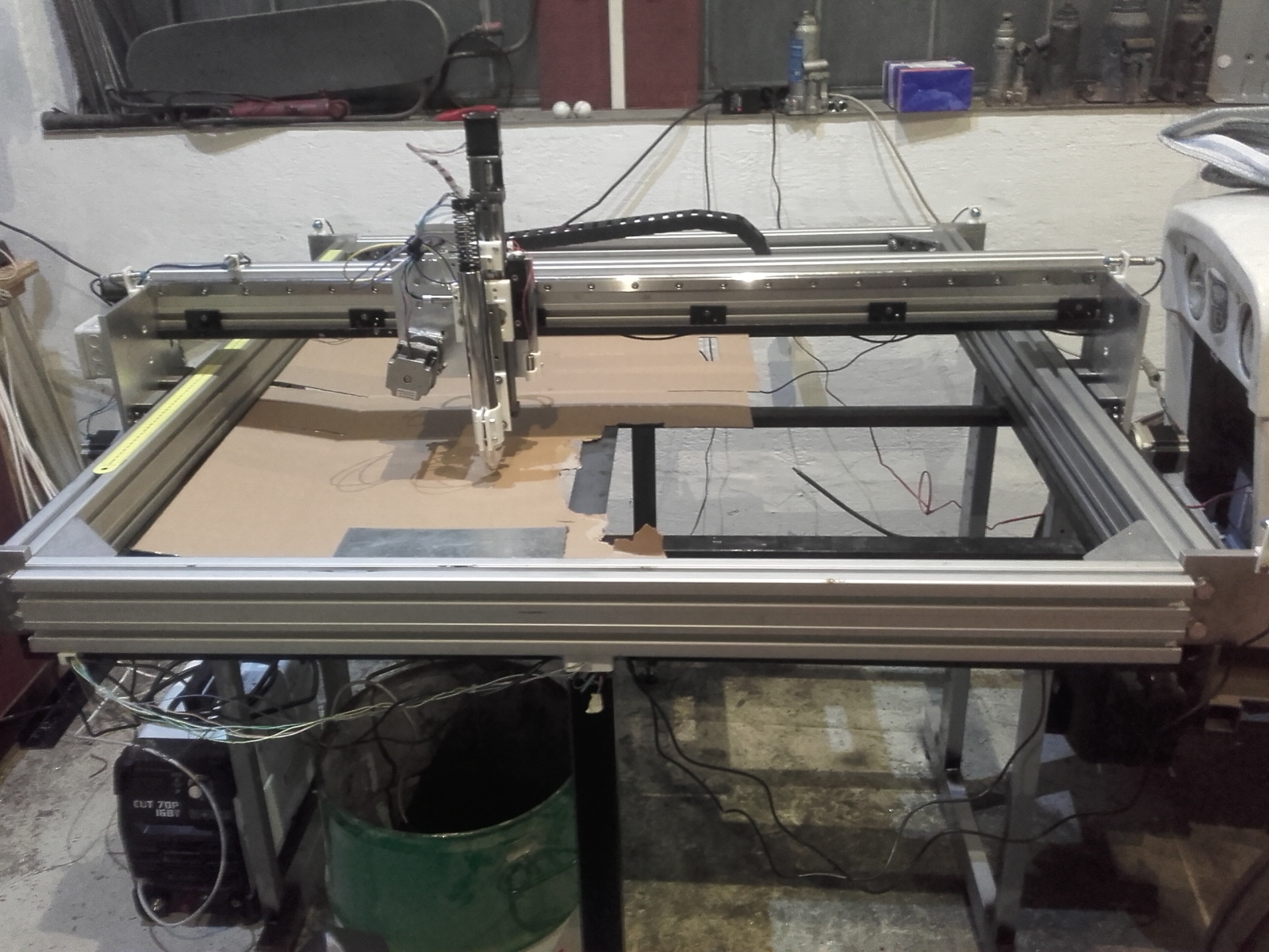

after a lot of help I got and still need , here some pics to view as thank you!!
I would make the gantry a big taller in height next time..wanted to make it flat but it's not necessary ...
home switch Y
setup for squaring and laser test
switches for power supplies motors and switches for motor drivers as well
home switch Y
