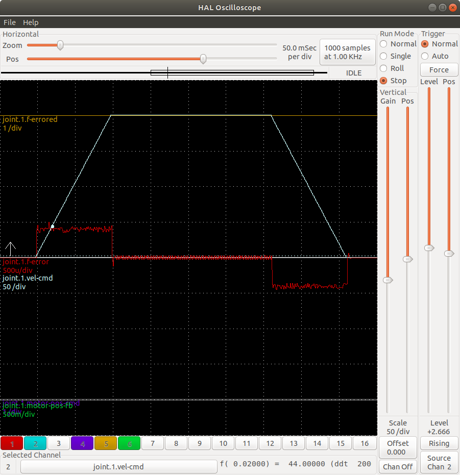

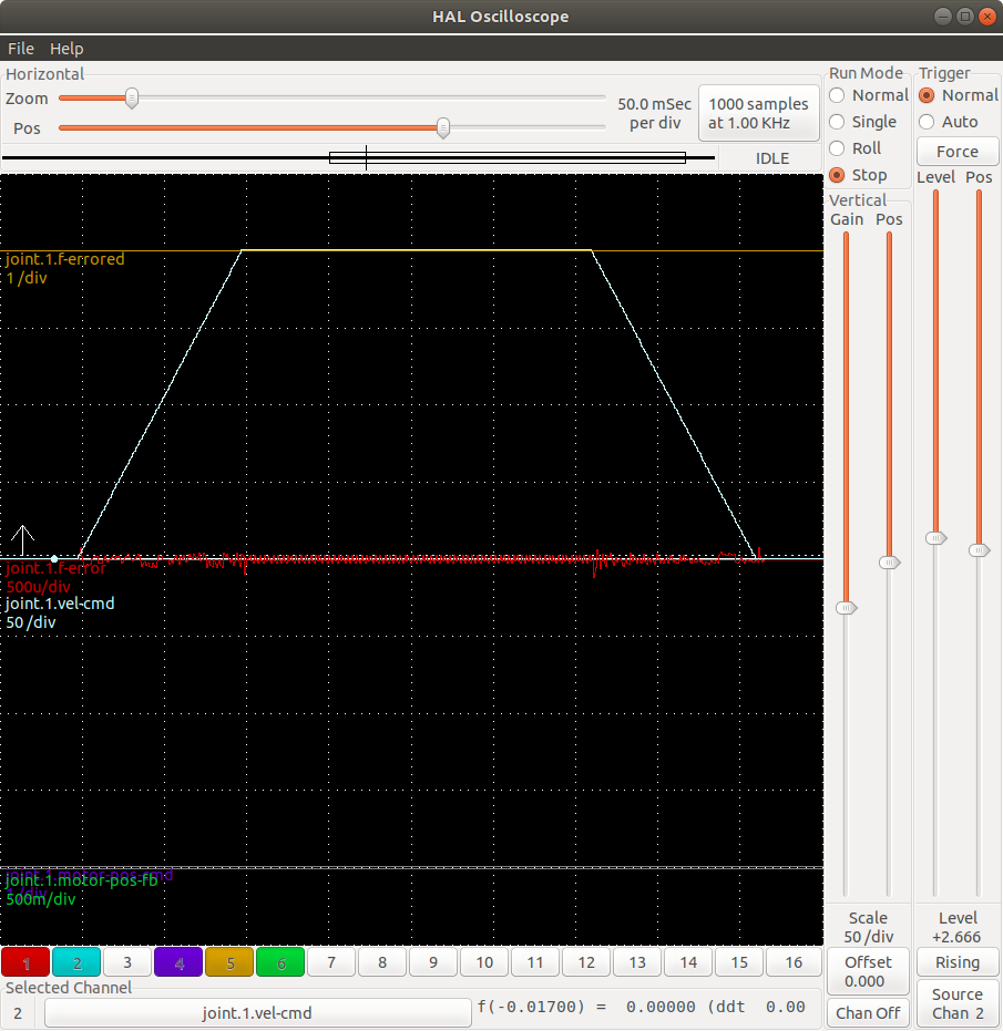

tommylight: here's what FF2 buys you:
No FF2:
correct amount of FF2:
Note that this corrects a _very_ small error (less than 1/2 micron at 1/5 G accel typical of a CNC machine)
but can be significant on devices with high acceleration and high accuracy (say laser plotters)
No FF2:
