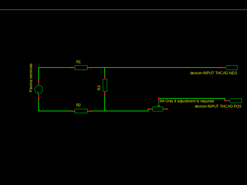

But I this point I am not sure where to get the voltage from in the machine ie is it straight from the torch output terminals on the machine ie +ve and -ve and route those to a metal box with the THC in it and fitted to the case of the plasma machine.
Or do I take the cables via two resistors one in each leg to minimise the current to a few mA something like 15k-20K
I know this cut 40 will die:( , so according to what you have said the THC 10 is the way to go:)
Could you please draw a simple sketch on how the THC 10 is connected to the machine .

23 Jun 2019 21:34 #137675 by tommylight
Replied by tommylight on topic New Plasma build question
Here it is, a rough outline, PCW should add the values for the THCAD10, i did not want to mess something in the calculations. PCW, thank you.
Note: R4 can be removed, it is there for fine adjustment just in case you want to have the exact voltage shown in the Linuxcnc GUI. That would require measuring the voltage at the plasma terminals, something i never recommend due to it's inherent danger.

23 Jun 2019 22:33 #137680 by PCW
Replied by PCW on topic New Plasma build question
I would at the minimum put R1 and R2 (and perhaps R3) at the plasma supply itself
If you use a THCAD10, I would probably just use R1 and R2 and not use R3 and R4
If R1 and R2 are 1M then full scale would be 210V
the wire carrying the signals from R1,R2 to the THCAD should be shielded
with the shield connected to plasma+ = table ground at the plasma end and left
open at the THCAD end
The following user(s) said Thank You: tommylight, Clive S

25 Jun 2019 00:52 #137767 by tommylight
I agree with Peter, leave out the R3 and R4.
That was just a general purpose voltage divider i use often, and since i can not always find the right values, i add the Pot there for fine tuning.
