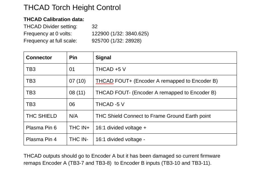

Question: I have notice that the terminal that goes to the work piece +ve is not connected to mains earth is this correct? BUT it would be when being used as the table will be connect to mains earth.
That is almost always the case, and usually they do not care that the ground is connected to + of the plasma as they are galvanicaly isolated. This is the reason i always make the work table separate from the machine part, less to worry about if something goes wrong and much better isolation.
Yes, it should be 1/32 for any type of start as it has nothing to do with it, that is the frequency that goes to the 7i96 and gets counted there.Also using scratch start with 2 x 1meg R's one from each terminal what would be the divide Freq. ie f/32 I will be using a Mesa 7i96

Edit : also on reading the THC manual it shows the W1 mode as down for unipolar BUT the board shows it as up. Which is correct?

W1 is set to unipolar on my THCAD. Bipolar should be set if you need to measure +-5V for THCAD10 or +-150V for THCAD300.

Do I need to use the FREF+ &- terminals on the THC-10 as it states in the manual that it is not generally needed.
Just wondering before starting the soldering.
- Posts: 21980
- Thank you received: 7480
25 Jul 2019 17:13 #140547
Replied by tommylight on topic New Plasma build question
It works just fine without it.
