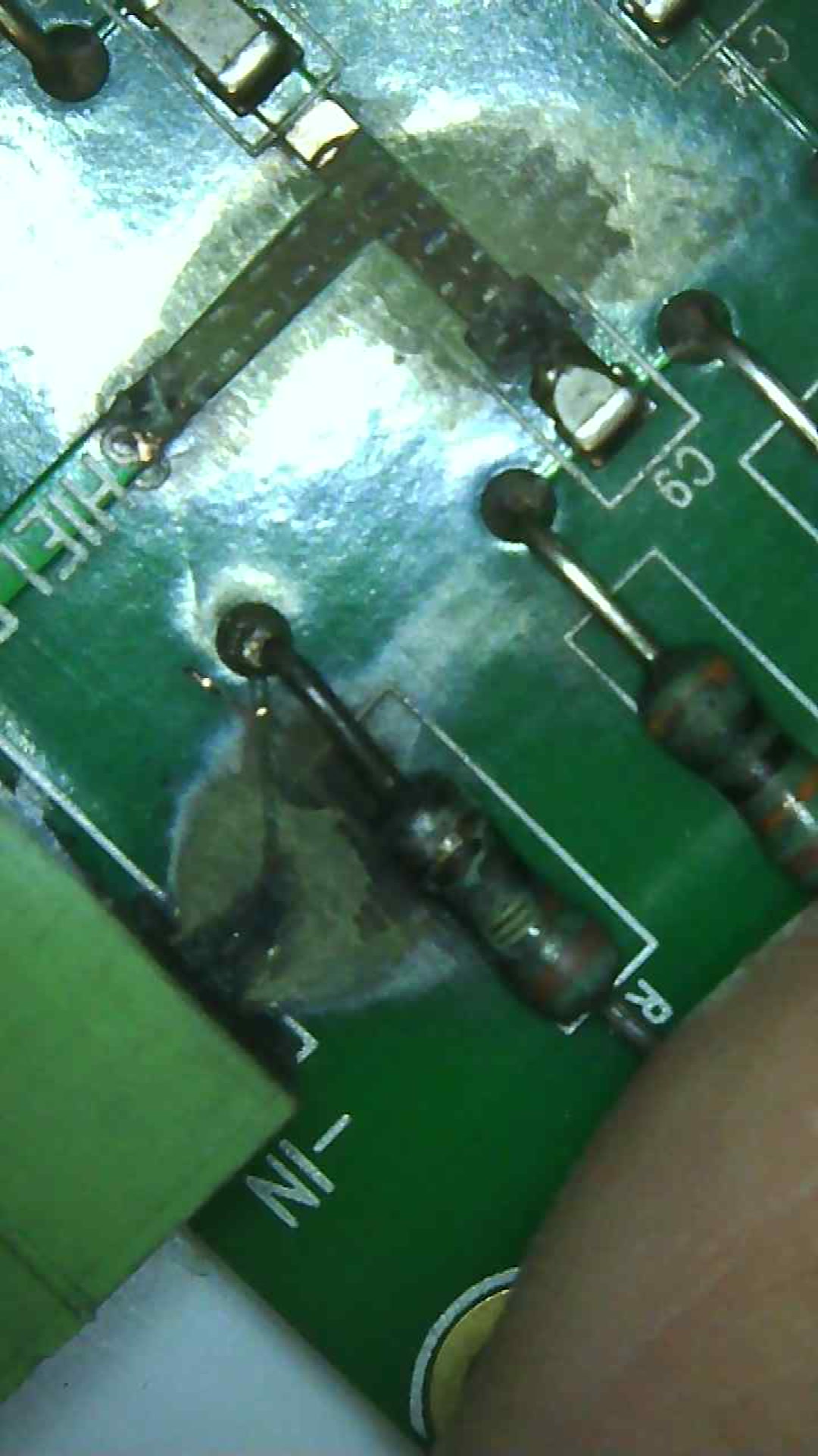

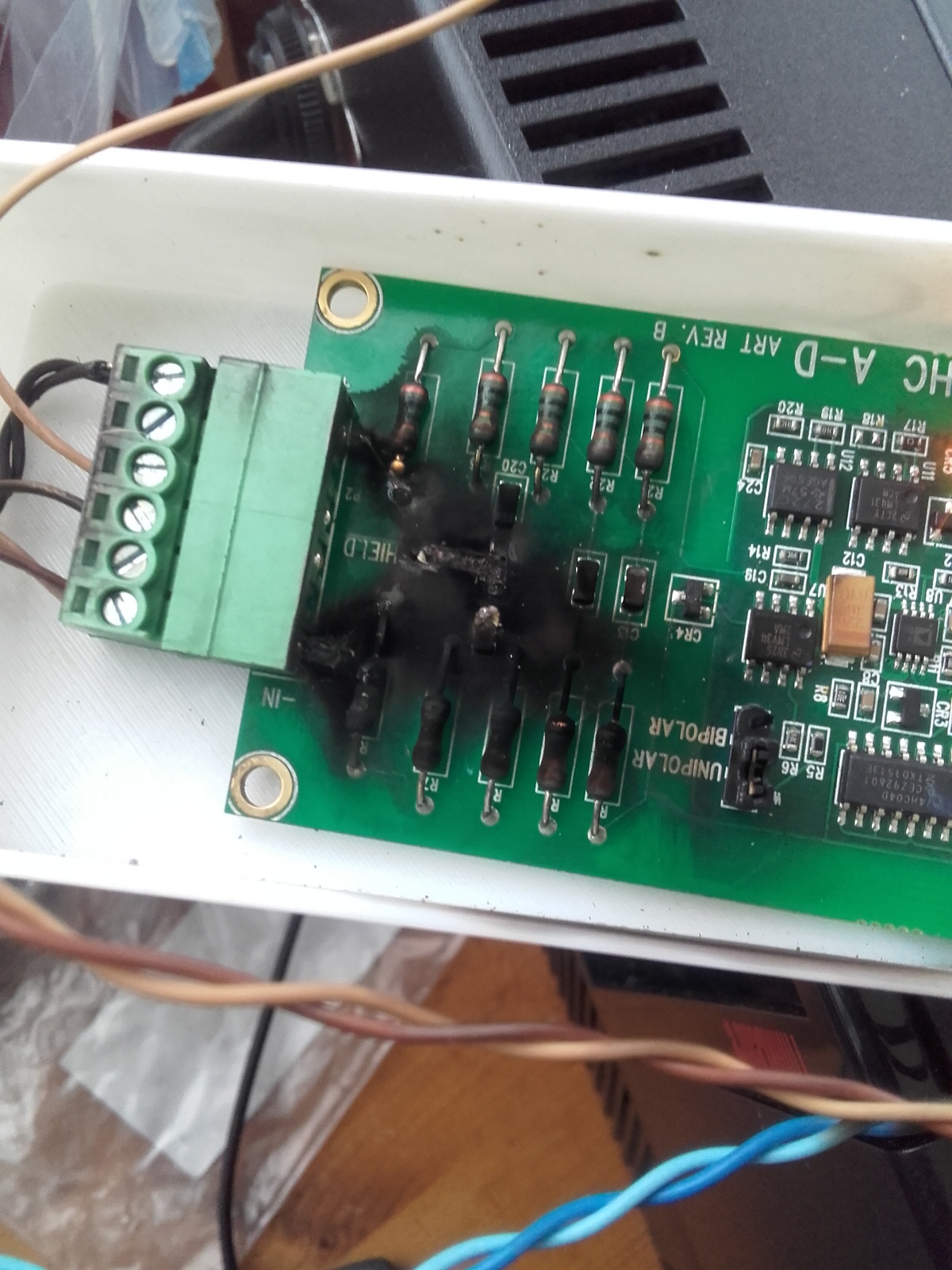

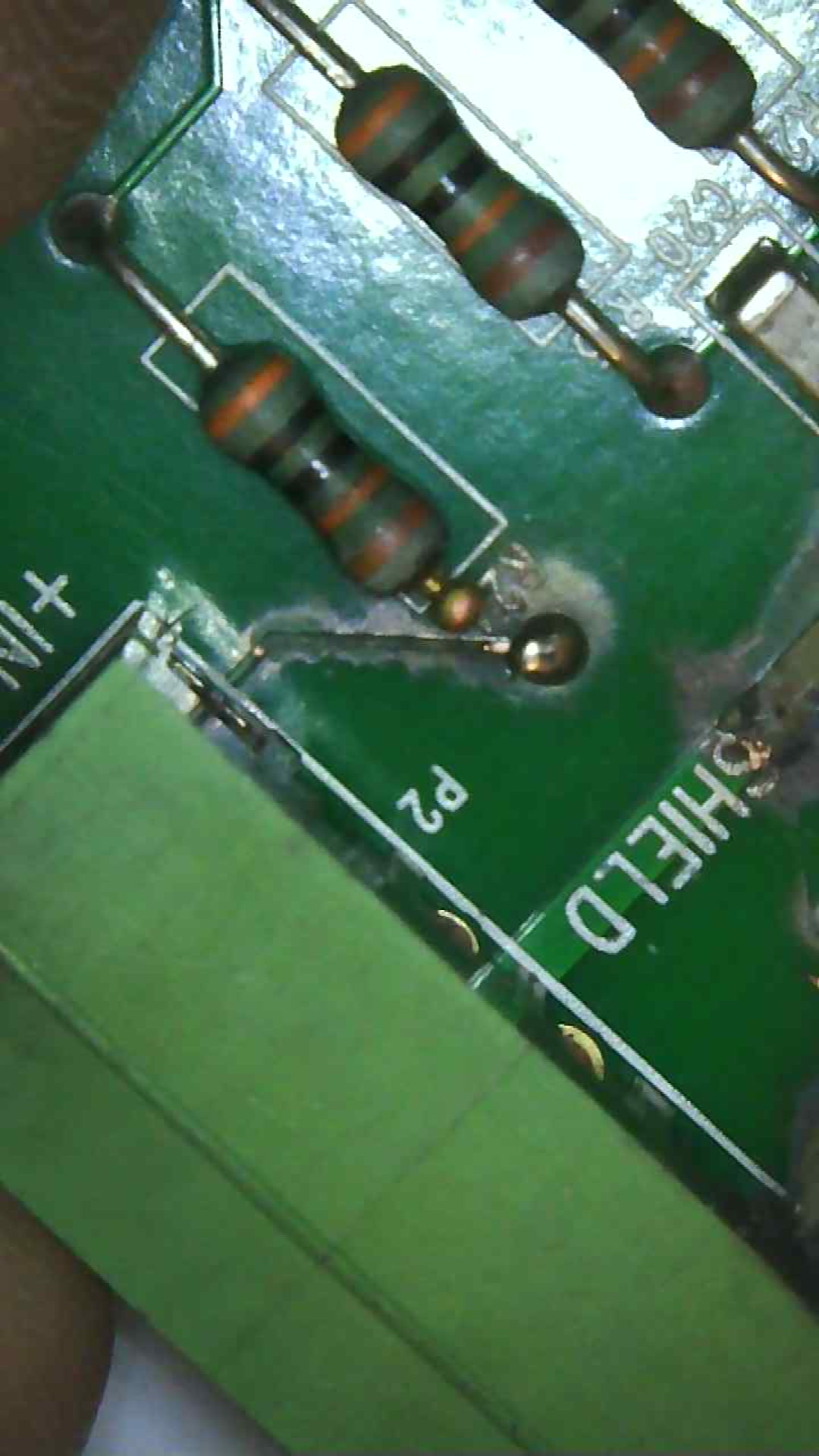

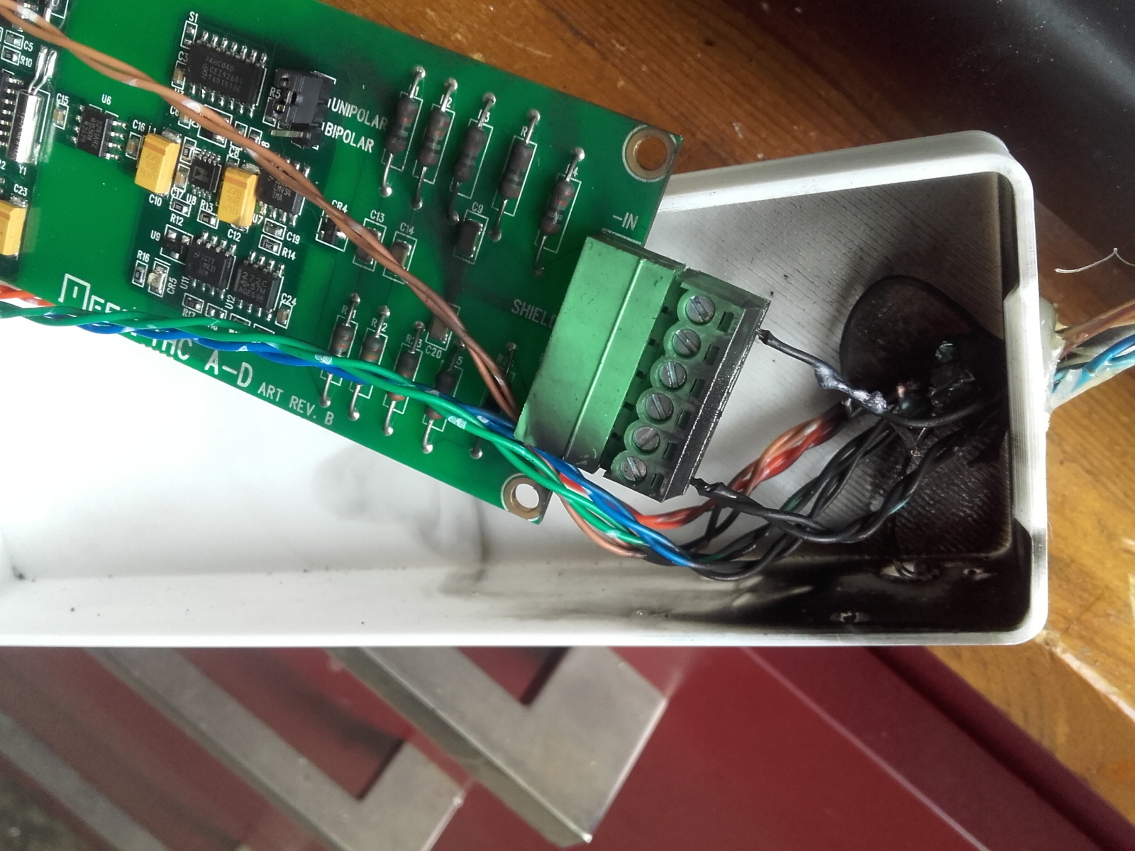

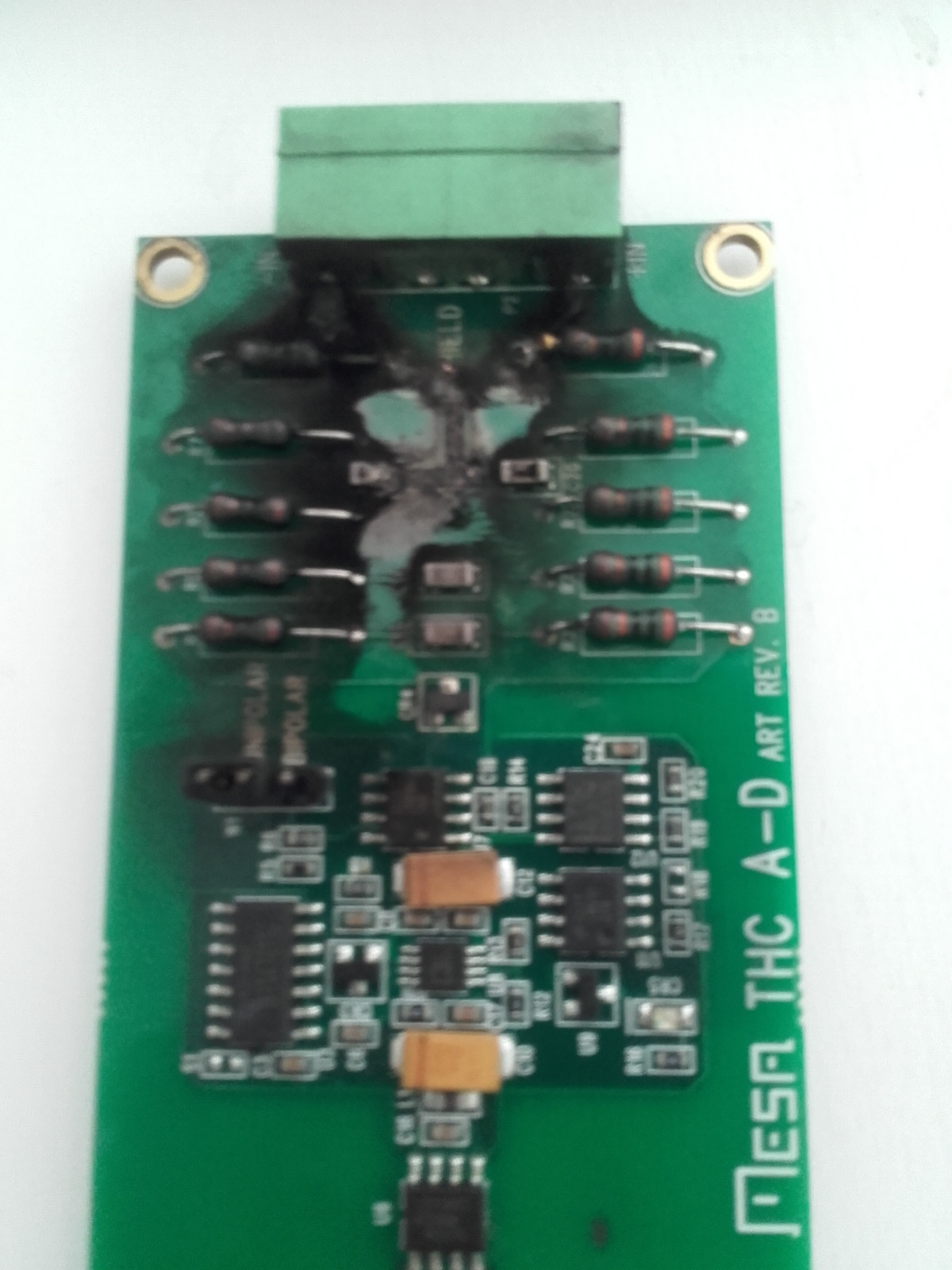

I am very sorry for wasting your time:
I checked the card which was in inside the plasma in a 3dprinted box.
looked like this: seems the shield was smoked off .this was connected to the case of the plasma and the controler box ground (case)....
I reconnected the shield as I had it before ,
I had shortly a voltage reading then it went to nirvana and puffed off.
-in was the torch
+in was the clamp
Like I asked here for clarification forum.linuxcnc.org/plasma-laser/36837-ne...ion?start=180#157751
interesting that the ground smoked off in first place ...ground was connected to ground plasma and ground controller box as mentioned already.
I will order another one as soon as possible . I don't think I can repair it ...voltage showed also without the card -43 Volt!!
all the best !!
Maybe somebody from Mesa has an idea why?

Maybe not my place to say this, but that is clearly due to arcing, first on the cables and the second time on the THC.
That leads me to conclude two things:
You have a high frequency/high voltage start plasma source
You have it wired in the wrong place, namely you have it wired at the plasma terminals.
I've mentioned here several times that those types of plasma cutters need to be wired directly to the rectifier output or at a small board with 2 resistors and a capacitor.
Those things put out 20 to 30 thousand volts at each start of the cut, and protecting from them is not easy.
Same thing is valid for high voltage start, but a bit easier to deal with.
Melted resistor pins while the resistors are intact !
Almost forgot, the wiring you used is absolutely not correct, you need high voltage wire with thick shielding, and NO other wires near those high voltage ones. You have all the wires through the same hole! Again a no no when dealing with high voltages.

As you may have noticed
you cannot use a THCAD300 for a HF Start Plasma
machines. Even though it uses 10X 3500V rated resistors it will not withstand the
power dissipation when 20-30KV is applied = >100W!
HFstart plasma machines need an external divider with multiple high wattage HV
resistors and a filter
