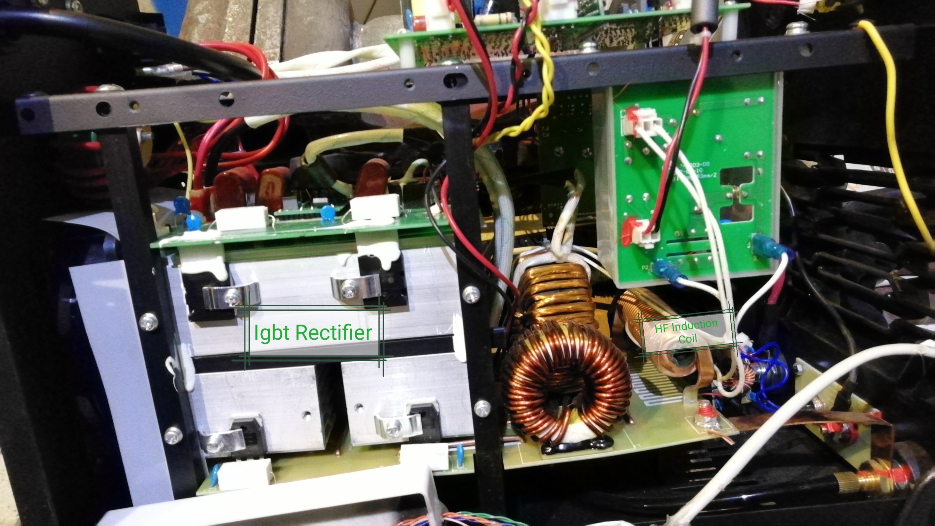

25 Mar 2020 14:33 #161438
by CNCFred
Replied by CNCFred on topic Valid Arc Lost, Thcad 300 config & Plasmac override
Is there a possibility to use the thcad 300 on my plasma cutter?
How can I bypass the ignition voltage?
Thank you

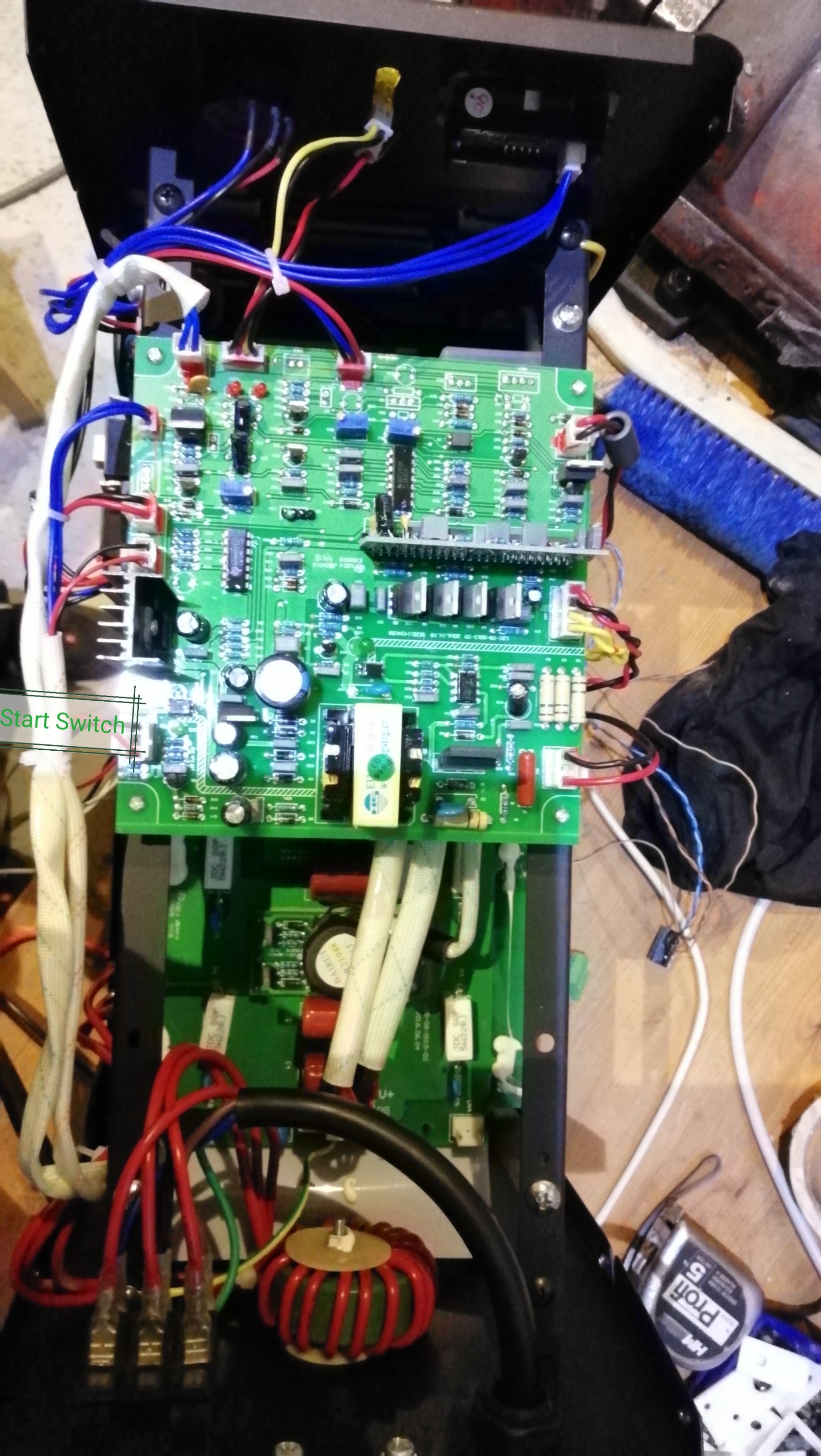

25 Mar 2020 19:26 #161489
That is a video i did 6 years ago on how to wire a THC to a plasma cutter, everything is valid for inverter type plasma's but it is much harder to find the right place.
Do some pictures of the inside of the plasma, maybe that can help figure out where to wire it.
Replied by tommylight on topic Valid Arc Lost, Thcad 300 config & Plasmac override

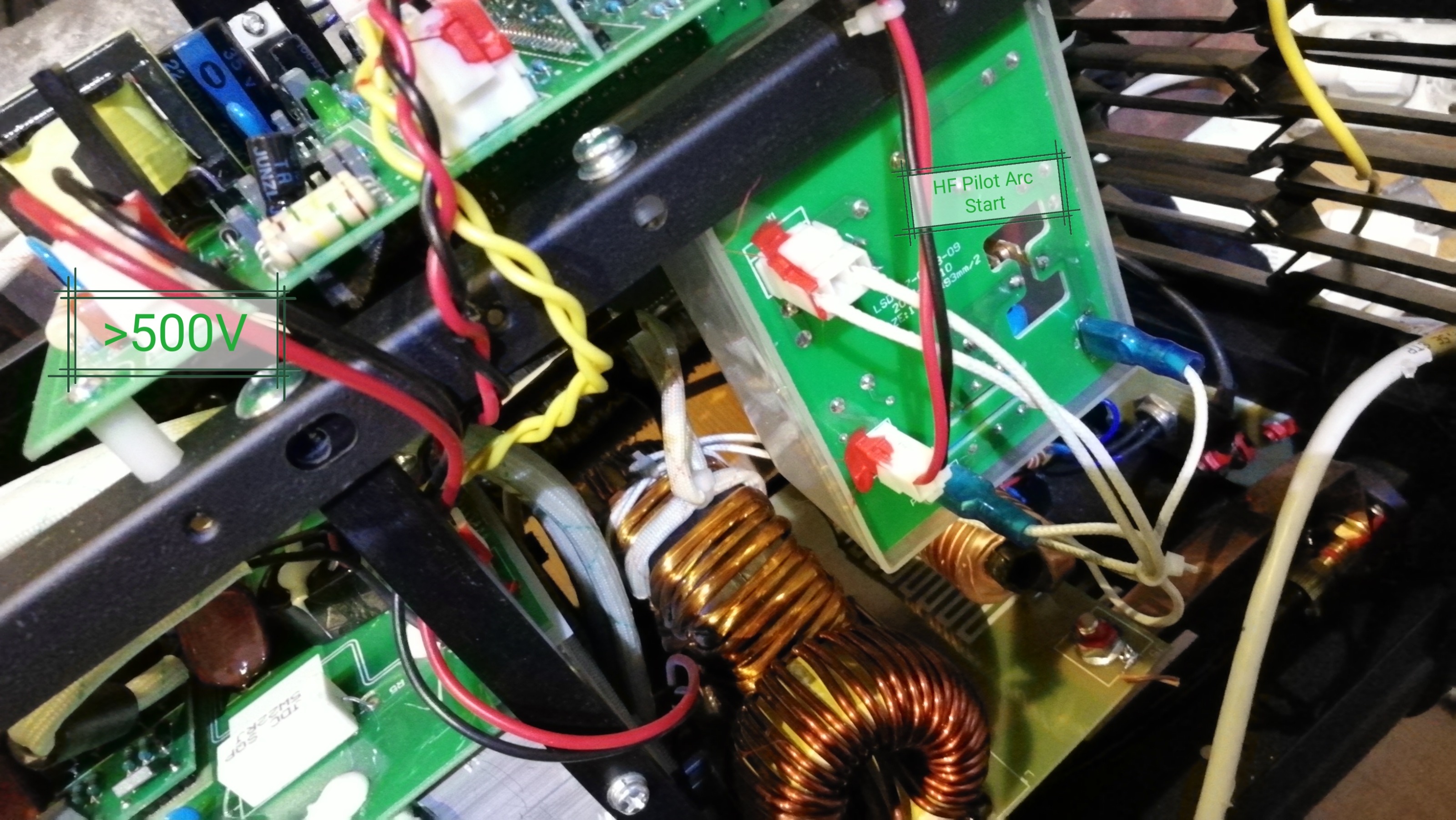

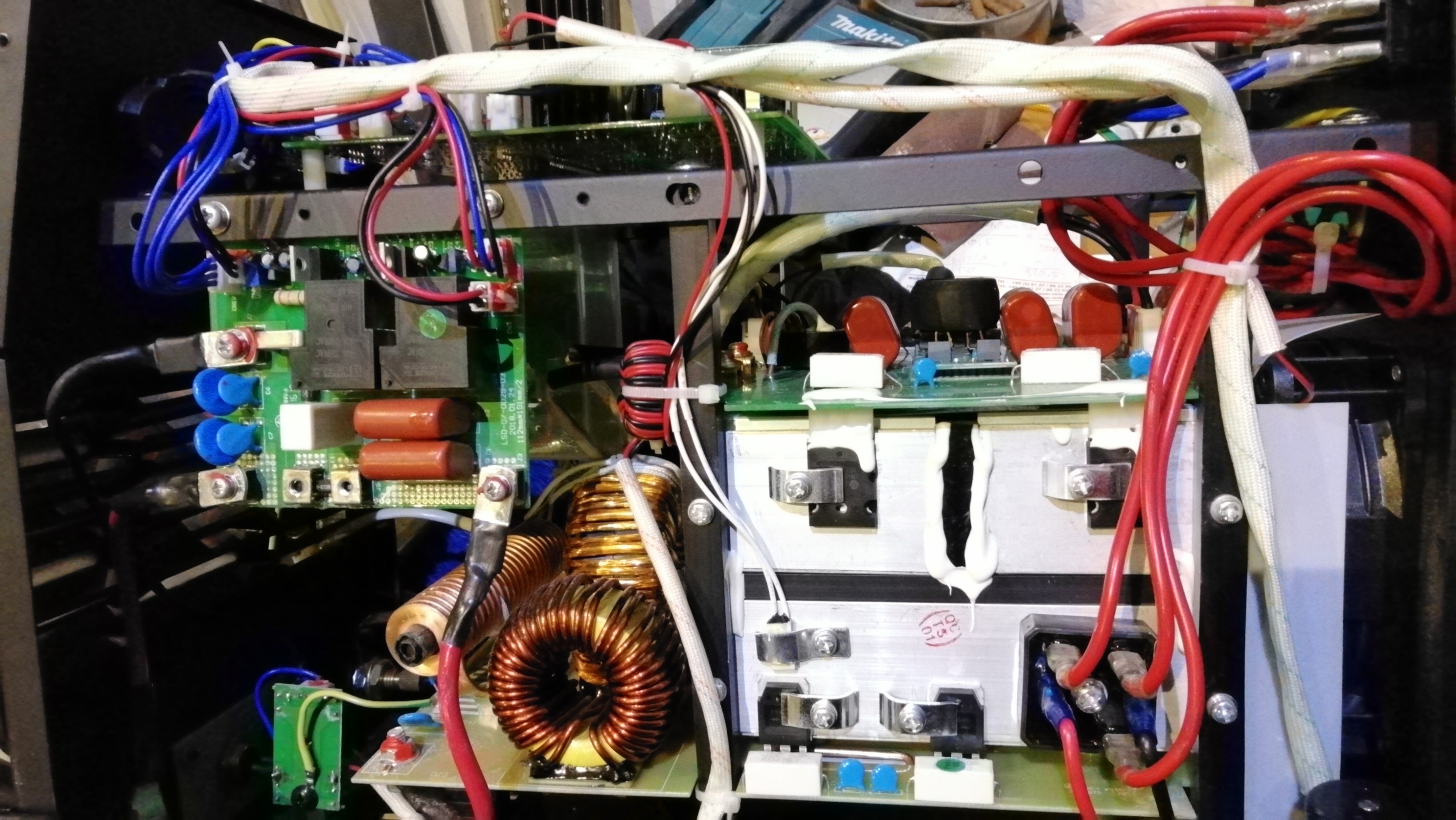

25 Mar 2020 21:27 #161510
Looks easy enough, at least from here, but please do double check:
The IGBT section:
The upper parts are IGBT or Mosfets, i can not read from the picture
The lover parts are diodes as i am pretty certain from the picture, i can barely make a diode sign on all 4 of them,
I can also see some heavy copper wire going from that board, lover part, to the board with the big inductors
My best guess is those are the 2 main wires from the rectifier, so if that is the case, that would be the place to wire the THC, just check the polarity, easily dome with a DVM as both of them will give you a short to the output terminals. That way you know that the one going to the torch in negative and the one going to the clamp is positive.
Do use double insulated wire for that, yank a cable from an old radio or something. Also make sure they do not get crimped when closing the cover.
Buy a 5$ DVM, set it at maximum DC voltage, wire it to those wires from the plasma and fire the torch. If it survives all is good and you can wire the THC.
The IGBT section:
