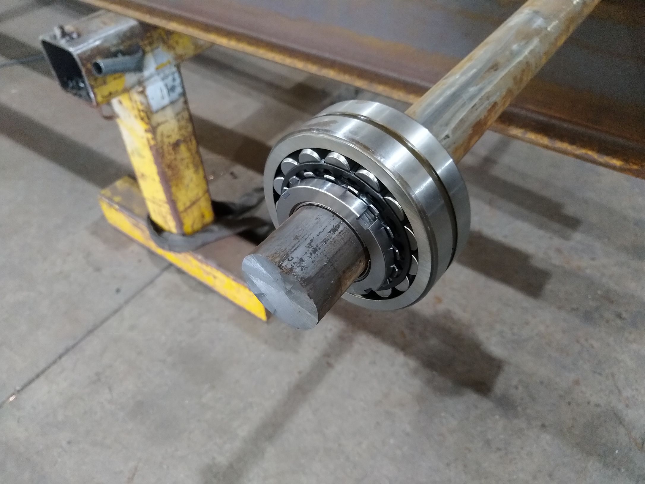

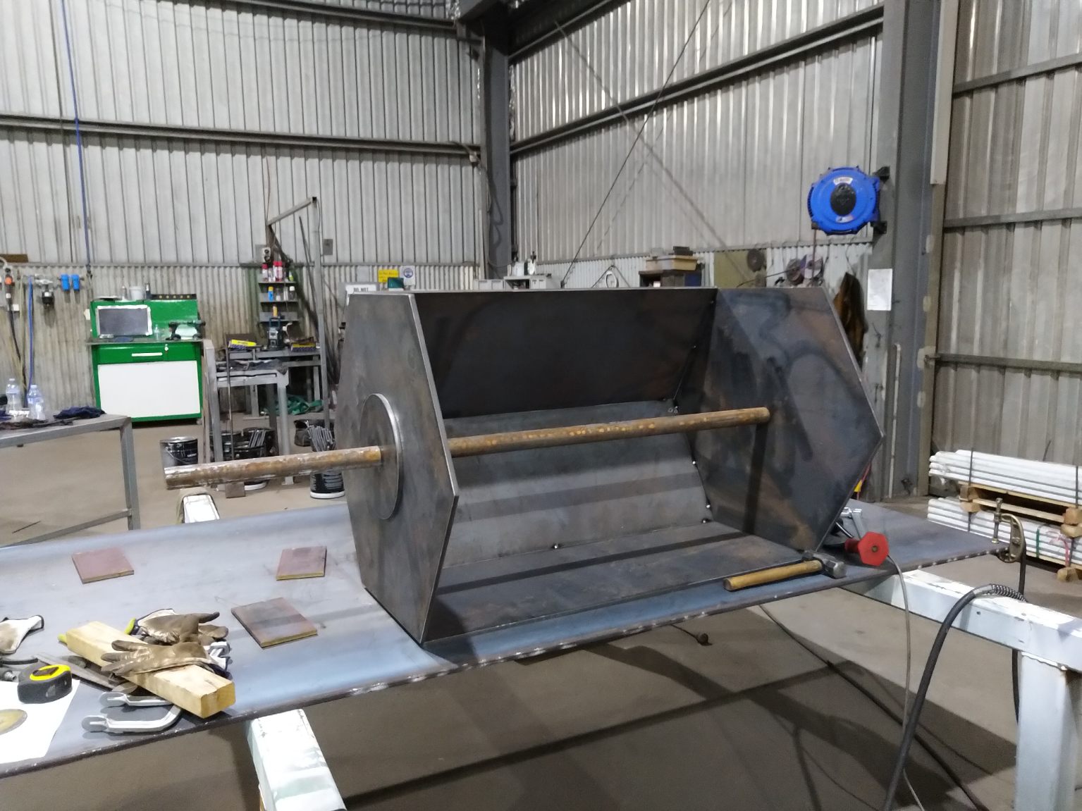

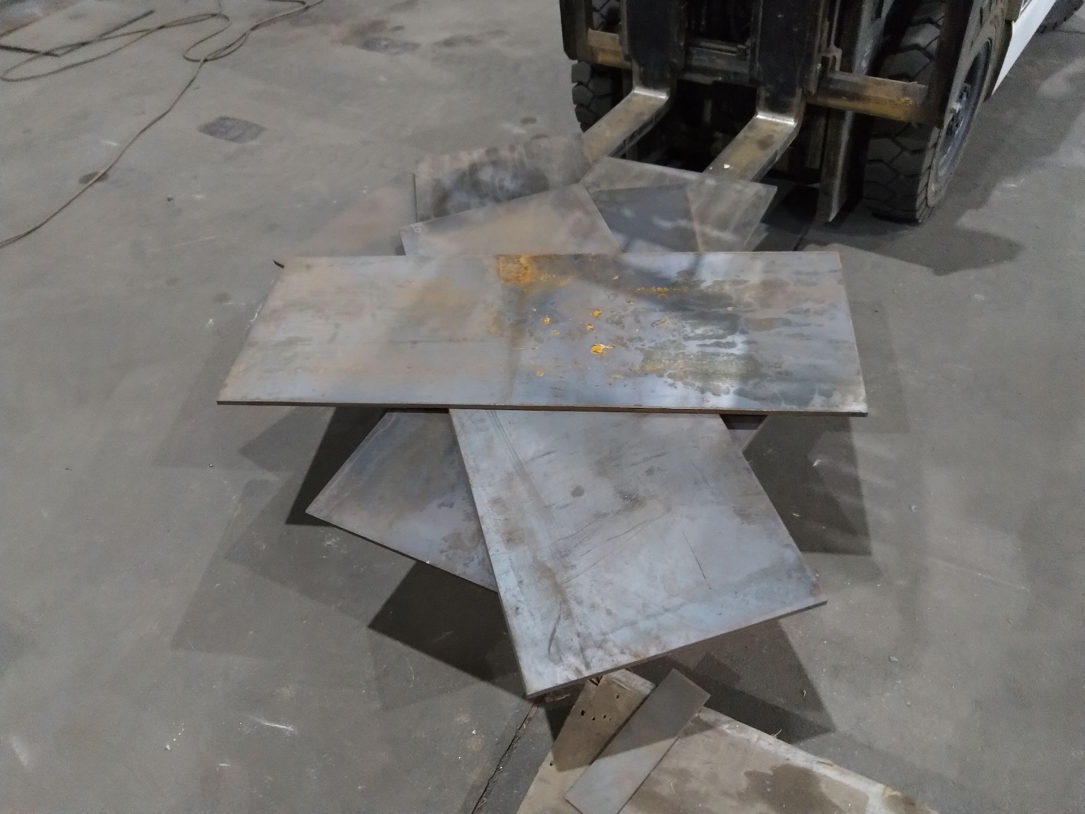

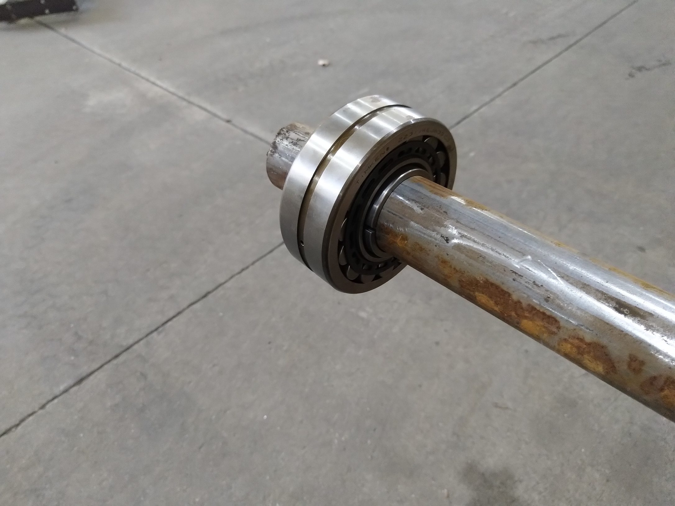

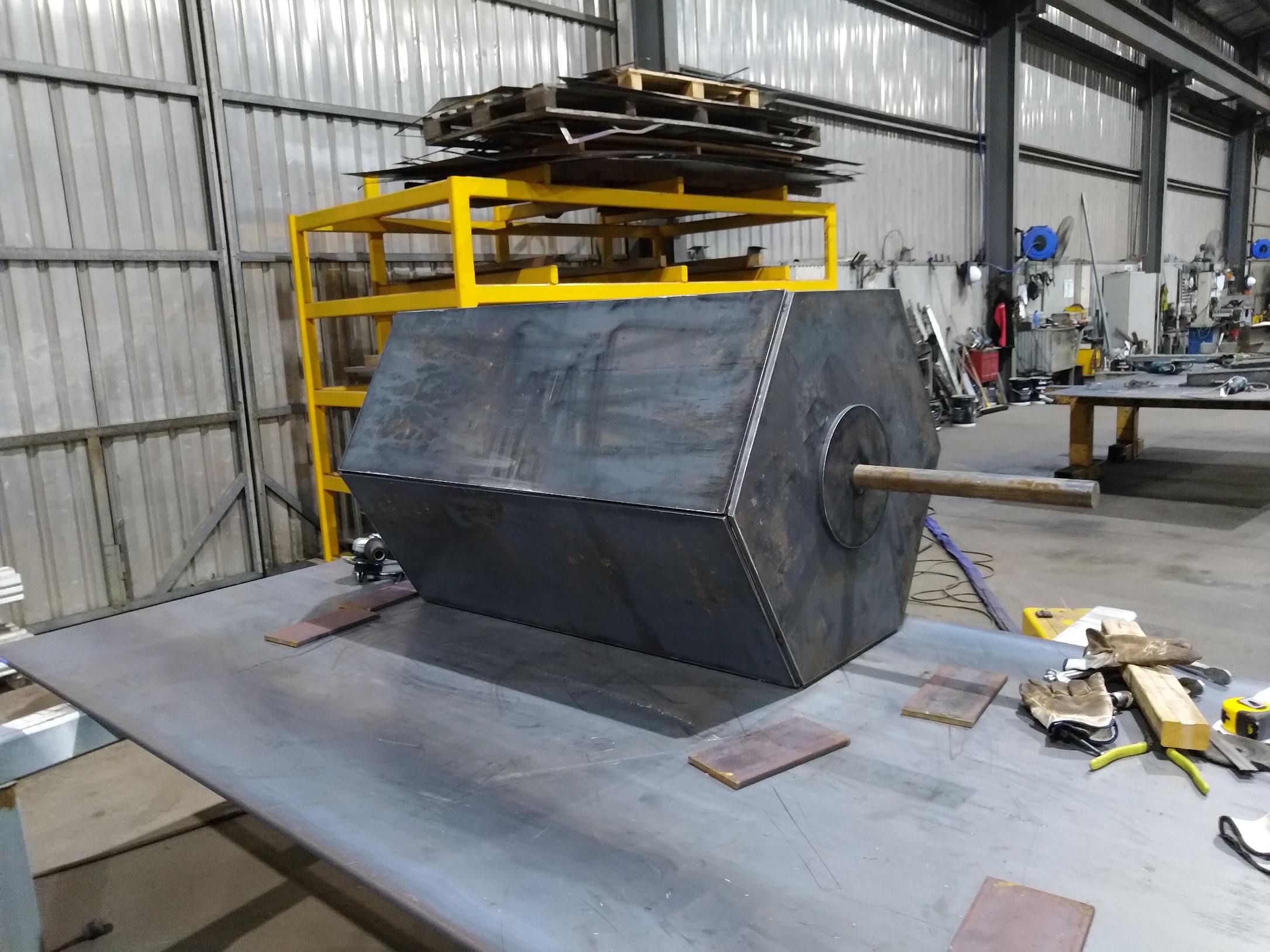

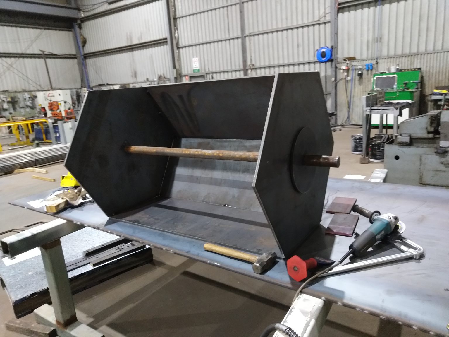

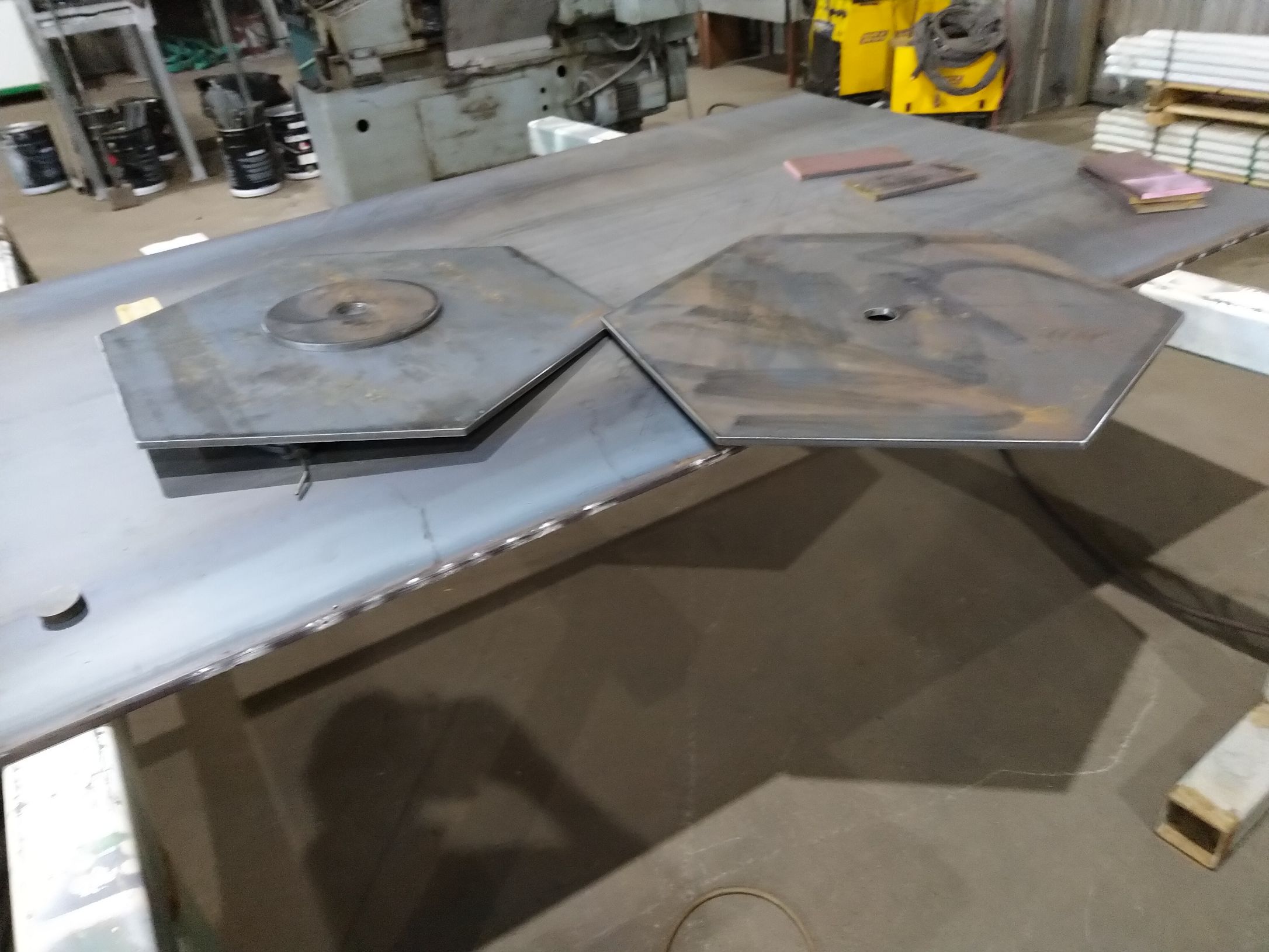

Hi Guys,
I need to keep living up to my screen name and finish fabricating a few more project.
Next project is a tumbler to clean up our plasma cut parts.
This build will be a bit ad-hoc. I am not sure on how the machine will handle different loads. I have done the calcs but I want to do a bunch of testing before I fully finish it off.
I will assembly the drum and frame. Wire it up temporarily and test it with various loads. Depending on how the test go I will then build a enclosure for it,
It will be interesting to see just how loud the thing will be. I am looking at cheap sound proofing options. Tossing up how hebel panels for the enclosure walls would go.
Ill keep updating the pictures over the next couple of weeks.

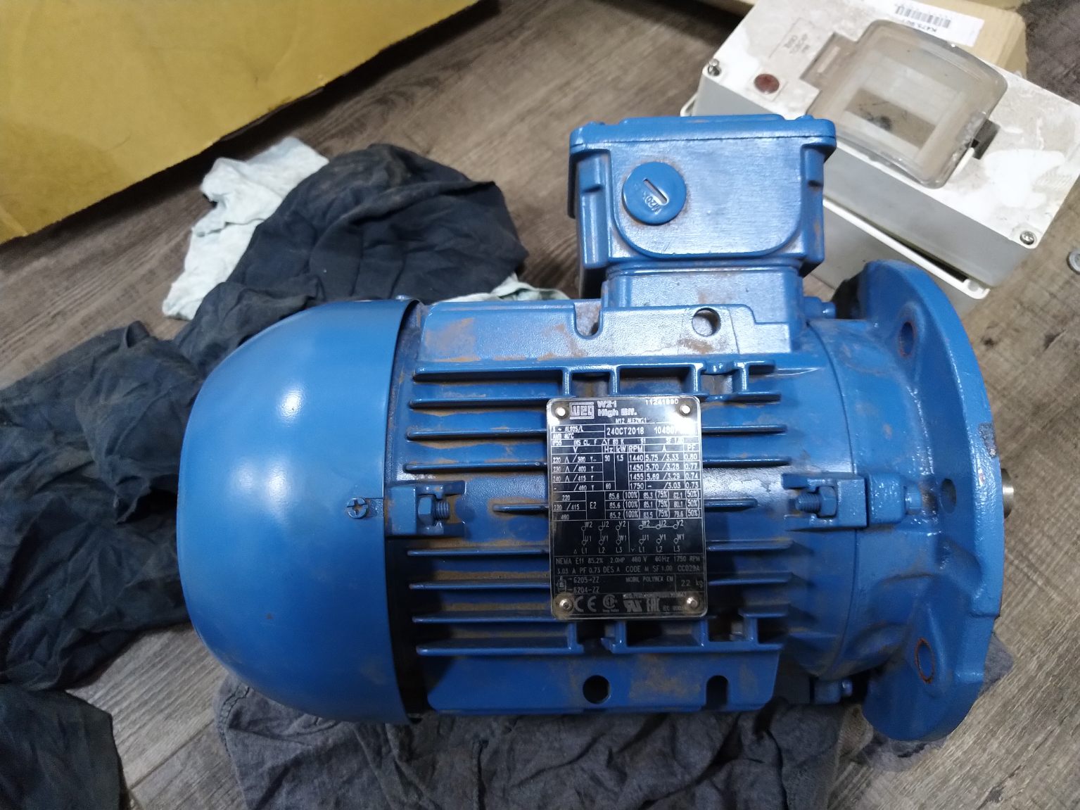

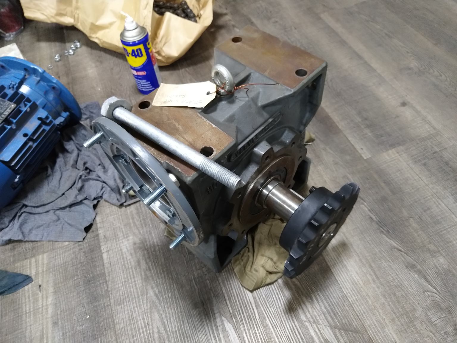

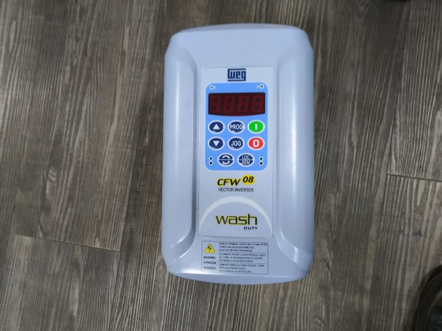

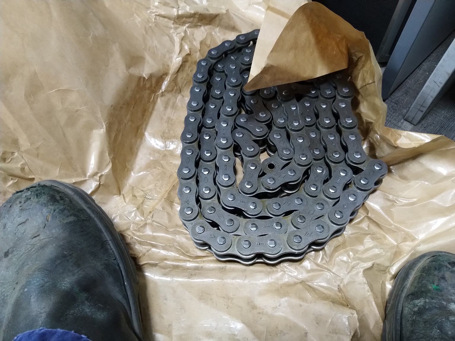

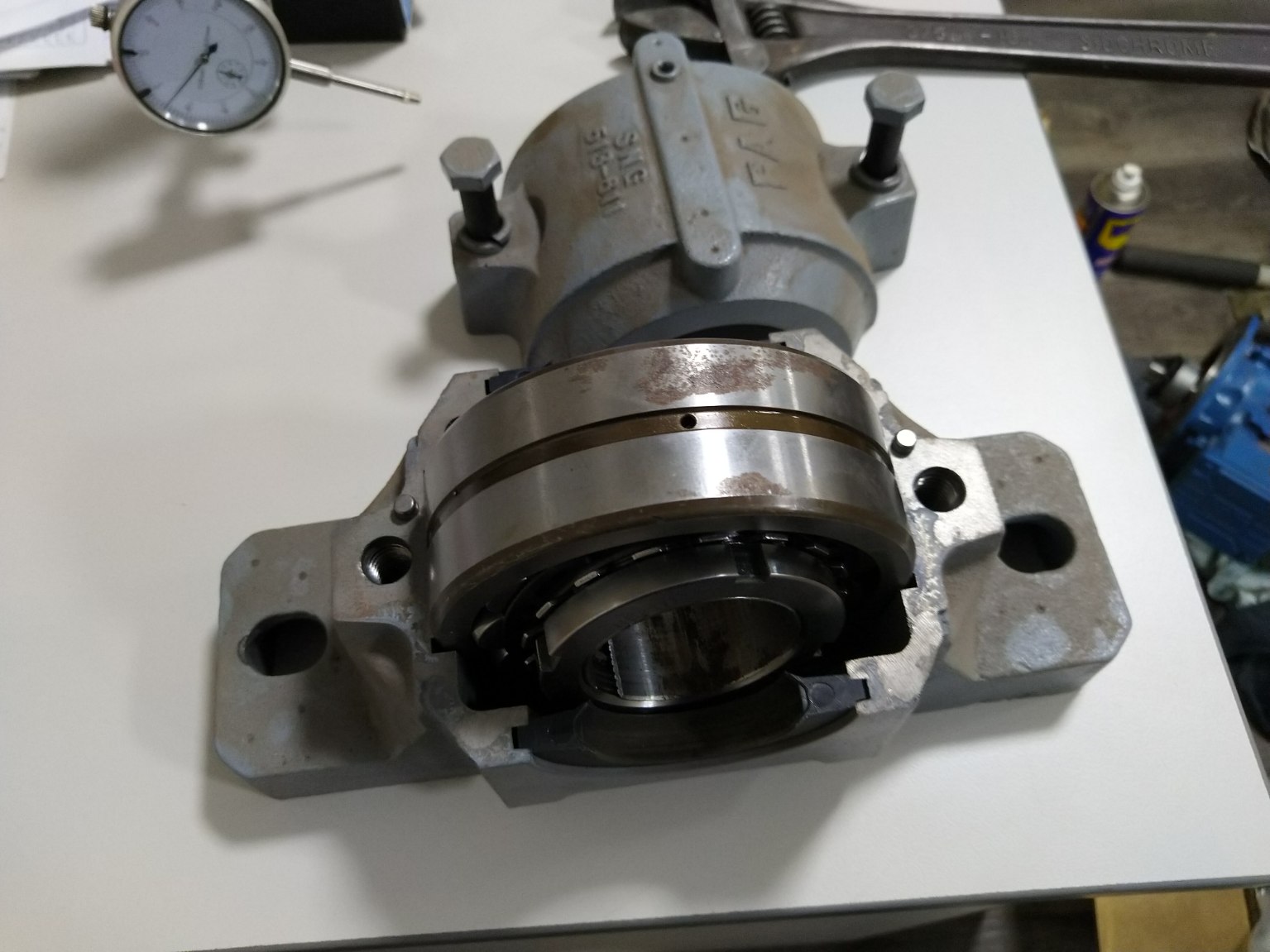

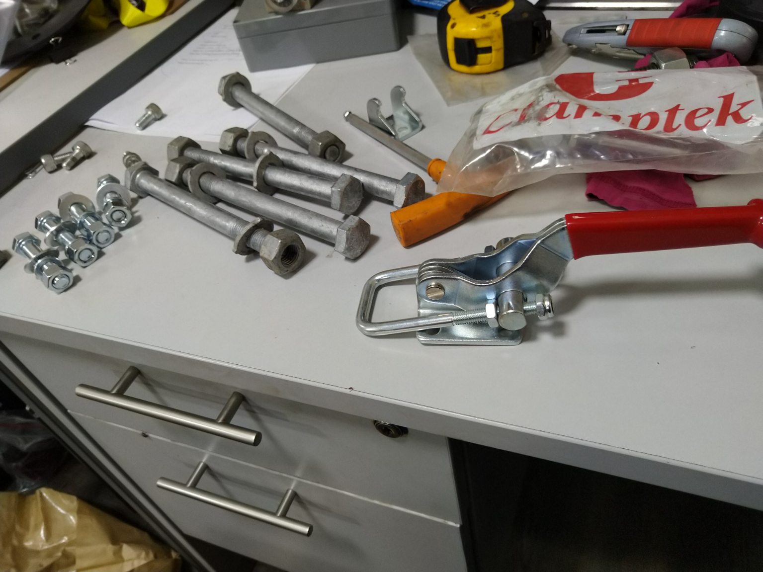

2 HP motor
Gearbox, cant remember the exact specs - I brought it two year ago, Ill look them up.
VFD
Bearing housing
Chain
Latches and high tensile bolts
VFD
Bearing housing
Chain

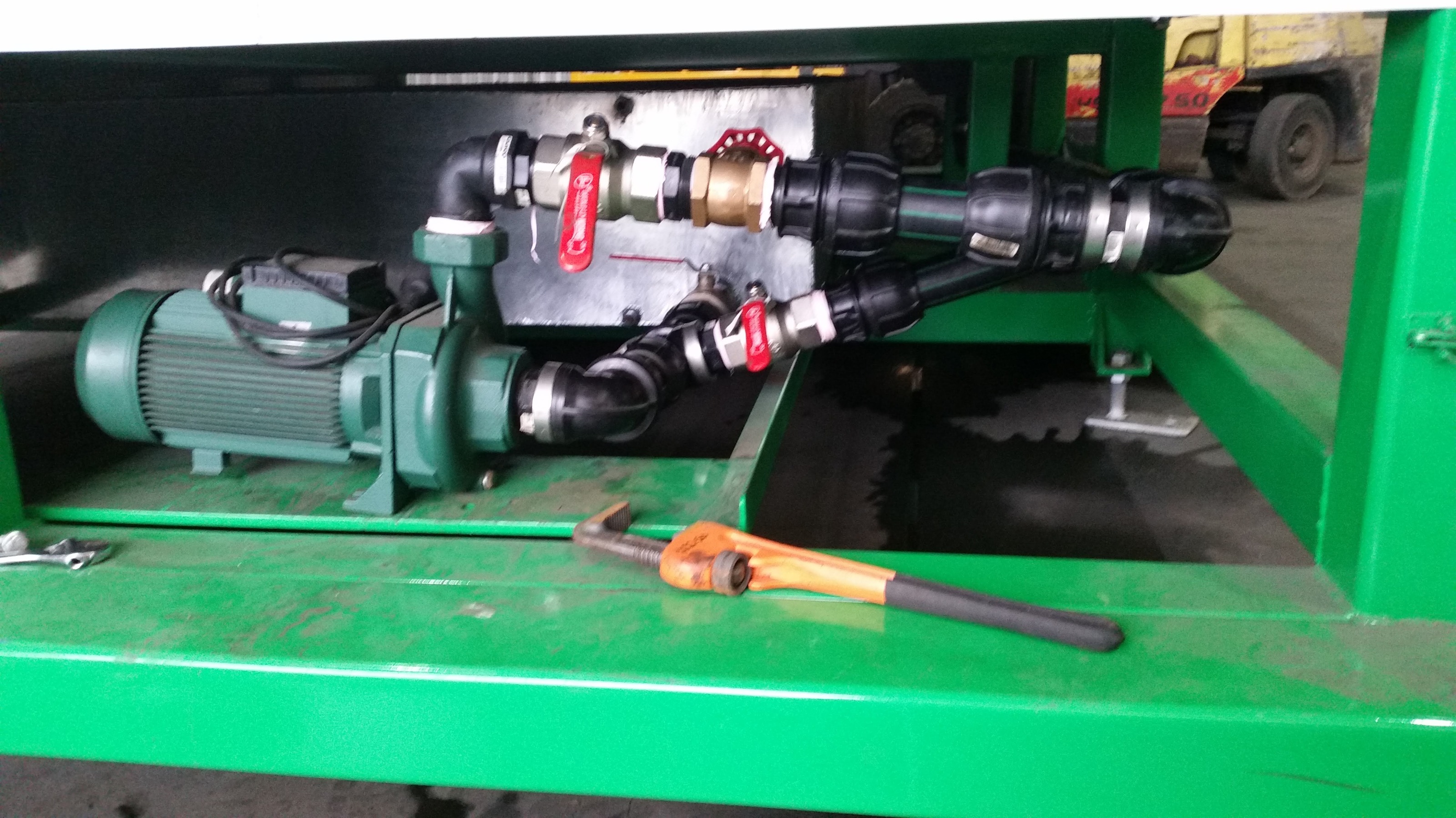

- Posts: 12156
- Thank you received: 4149
10 Apr 2020 12:58 #163475
Possibly add a swivel hose inlet to the shaft and let the water flow in...
Replied by rodw on topic Tumbler Build - For cleaning plasma cut parts.
x 2Nice
Adding a drain may make it easier to regulate the water content

10 Apr 2020 13:19 #163478
- thefabricator03
- Visitor
10 Apr 2020 13:25 - 10 Apr 2020 13:26 #163479
by thefabricator03
Replied by thefabricator03 on topic Tumbler Build - For cleaning plasma cut parts.

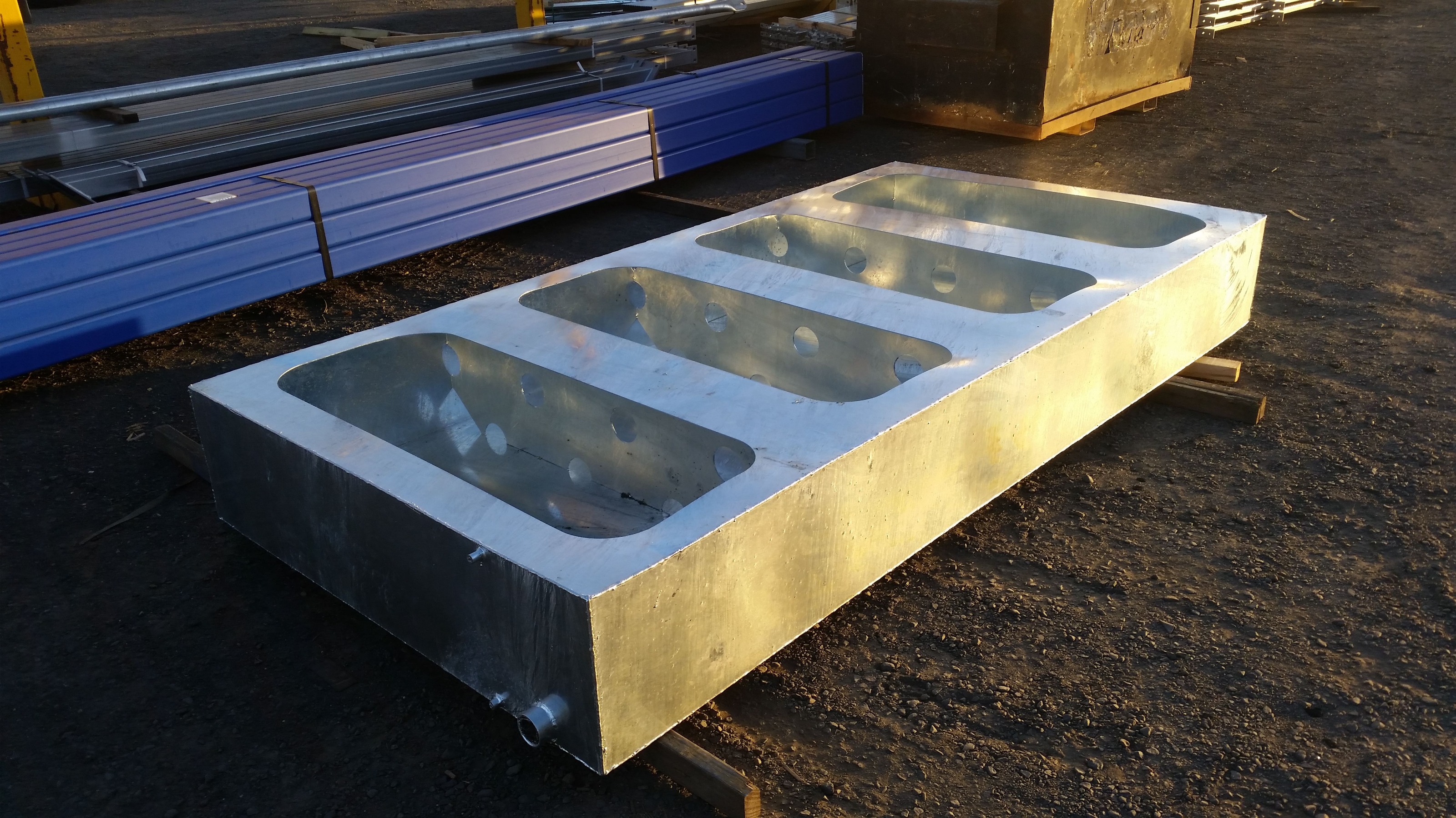

I built a tank for my machine so I can drain the water tray in about 10 mins and fill it back up again in about 6.
Last edit: 10 Apr 2020 13:26 by thefabricator03.
