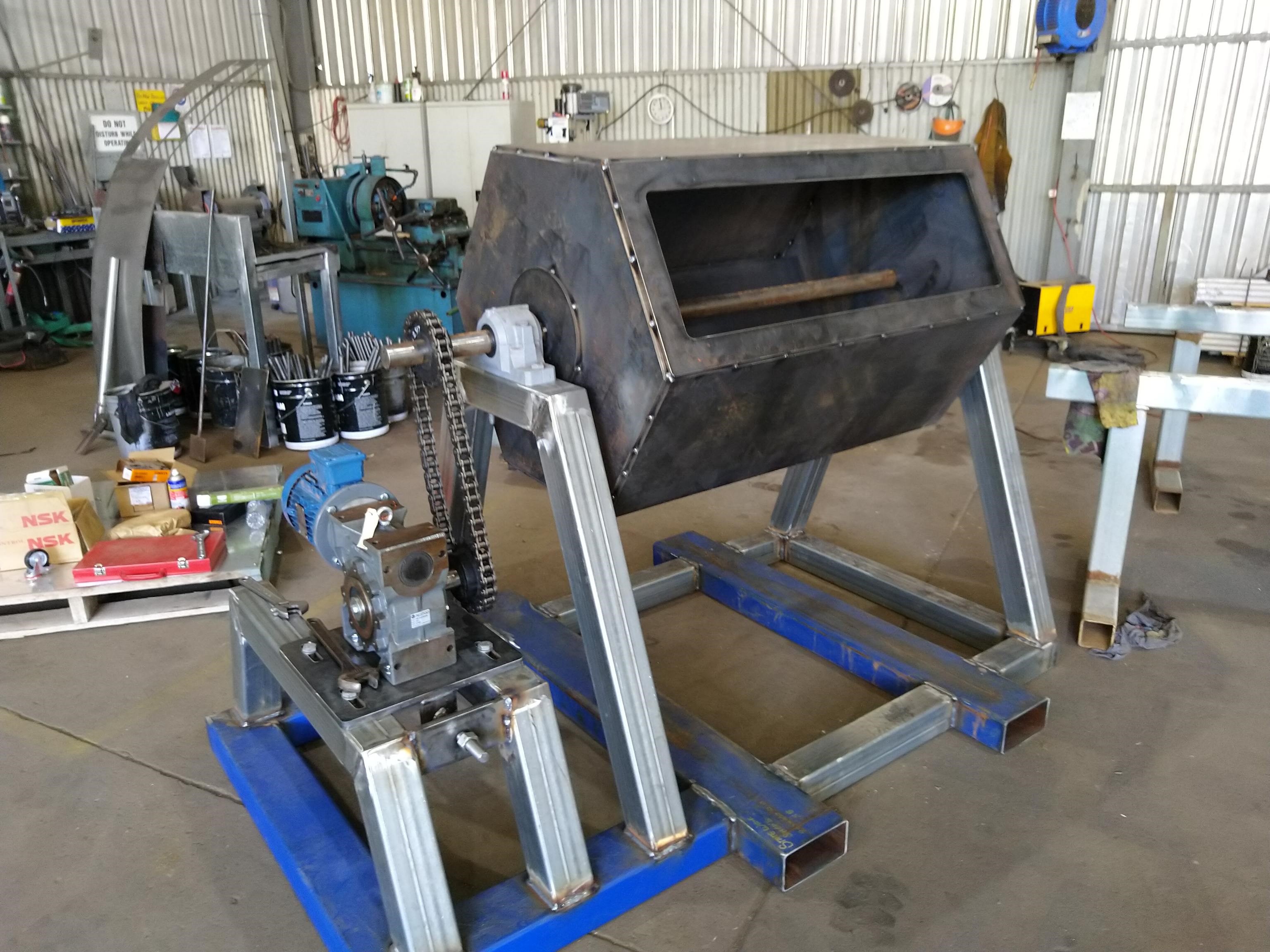

Tumbler Build - For cleaning plasma cut parts.

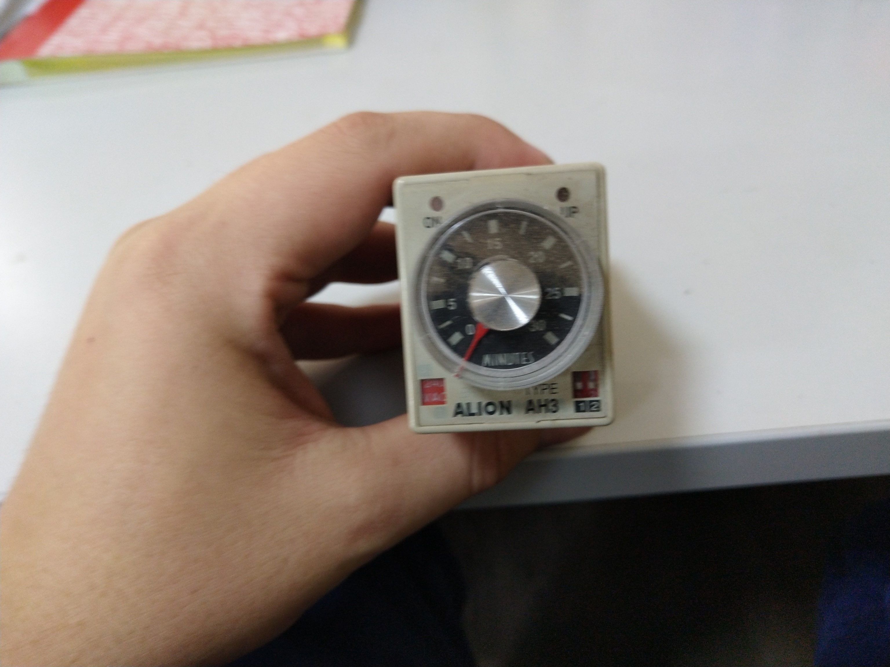

Also do not disrupt power from vfd. If motor is turning you have a good chance to kill the vfd by back-emv. If you feel (i think this a good idea anyhow) that you want to have mains removed from vfd do it via a time delayed relais.

Tom, I am with you on the Timer,
Thinking maybe tie it to one of the digital inputs.

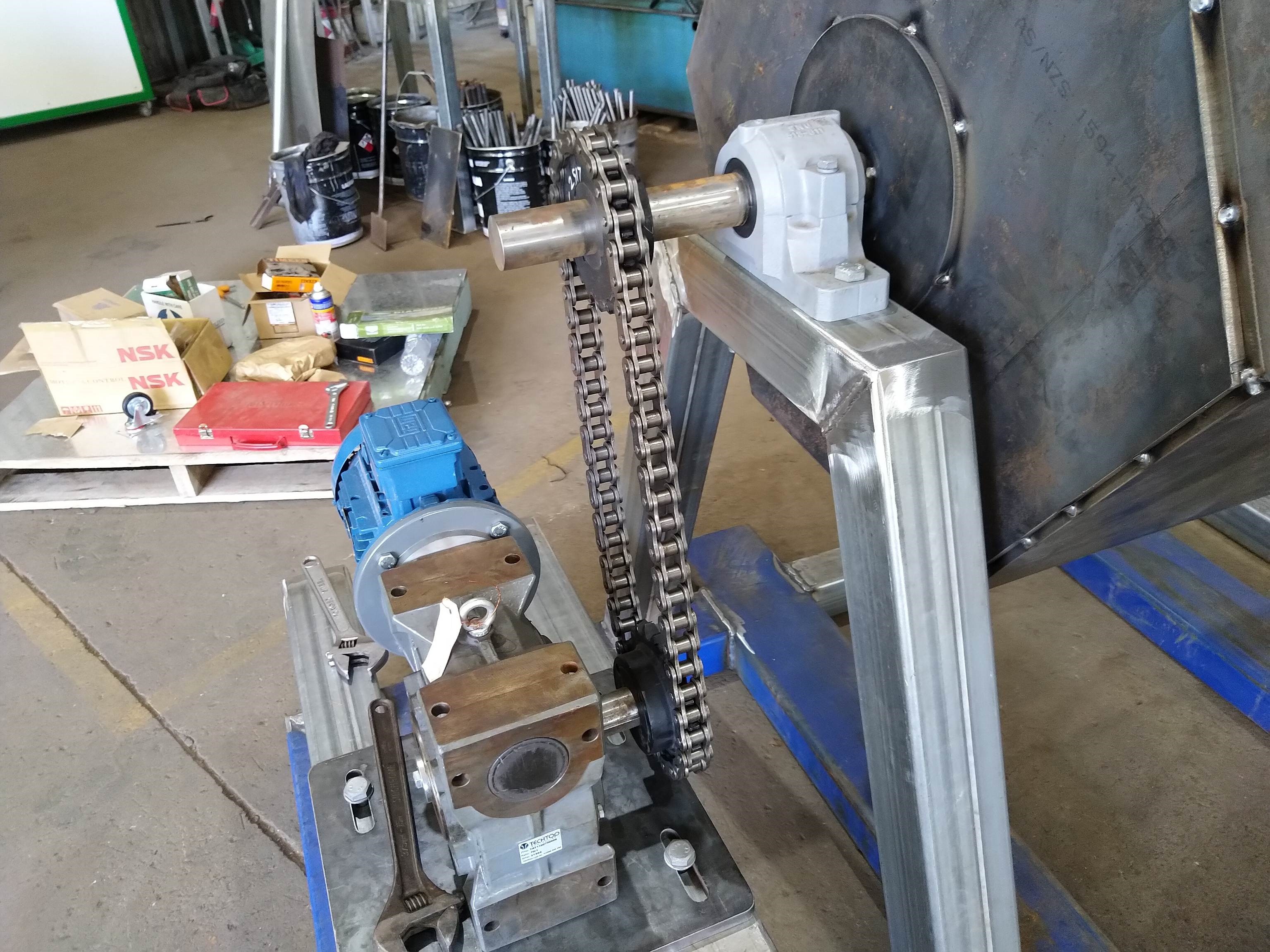

16 Apr 2020 04:04 #164109 by thefabricator03
Replied by thefabricator03 on topic Tumbler Build - For cleaning plasma cut parts.

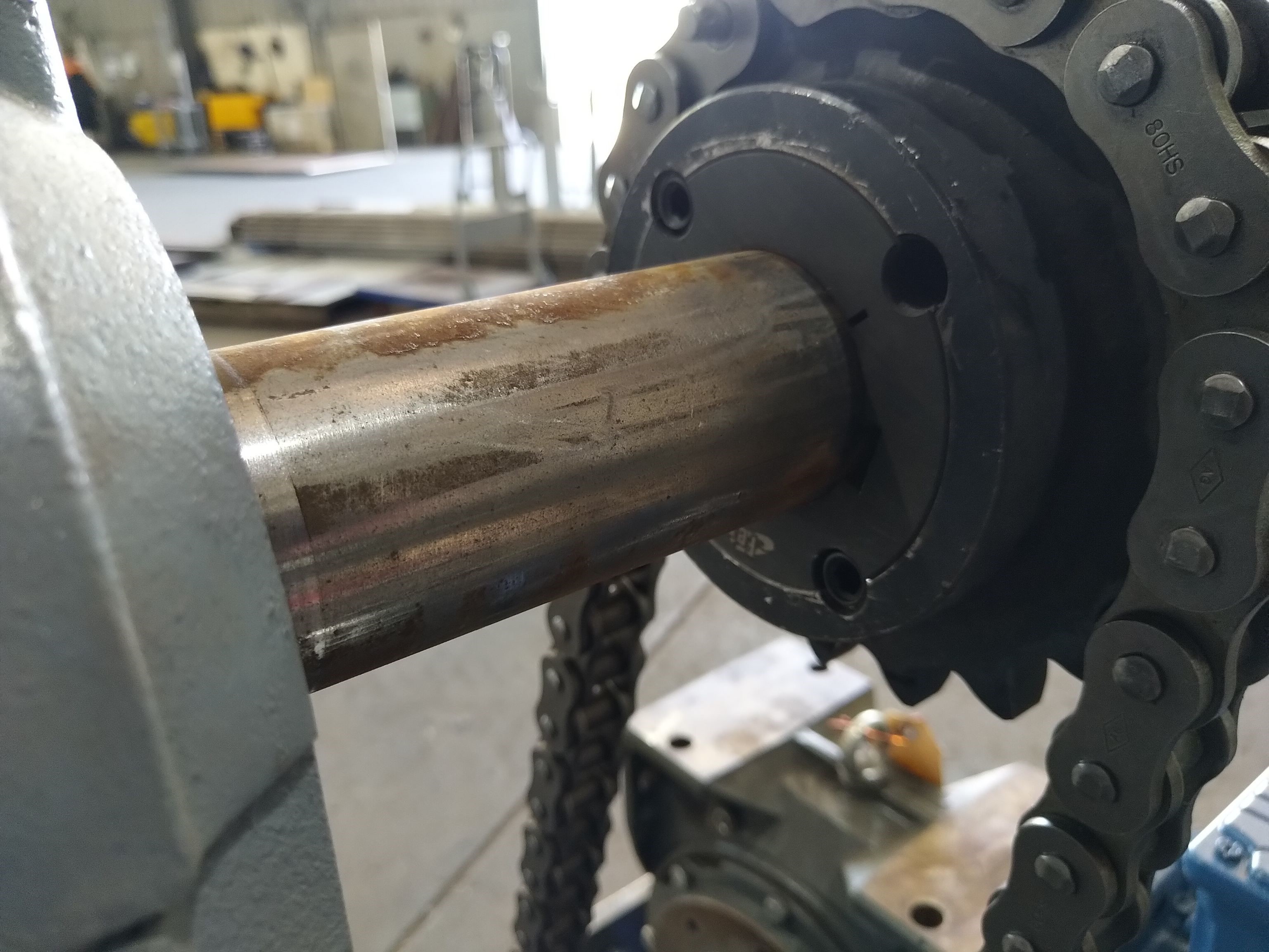

Added the chain temporarily. The taper lock on the shaft is going to need a keyway cut into the shaft.
@ MachineDude: Any advice on cutting a keyway into the shaft already welded to the drum?
16 Apr 2020 04:45 #164111 by machinedude
Replied by machinedude on topic Tumbler Build - For cleaning plasma cut parts.
things would have been a lot easier if the key way was done before the shaft was attached to the drum. now that it is welded to the drum you need a really big machine to cut the key way the way you have things now. might be able to cut it on a Bridgeport style mill with the Y axis if you can use a fork truck to hold it up while you cut the key way and maybe a roller under the other end of the shaft once you get things straight and on center so it can move with the table. i would leave the forks there to catch it if something would slip. doing something like that is not the safest way to do things. the safest way would be to pull the shaft out if you can? i'm not sure what machines you have to work with either?

16 Apr 2020 04:51 #164112 by thefabricator03
I was thinking a bit more agricultural than using a mill.
1mm cutting disc on a 5 inch grinder. Drill two holes either end the correct depth cut slot width underside and grind out center with 5 inch grinding disc. Then finish by had with a file.
Not fun but would be easier than taking the shaft out.
I am going to see if any of the local mining workshops around here have a machine to do onsite keyways. My guy who use to do a lot of on site line boring is not here today so I will ask on Monday.
