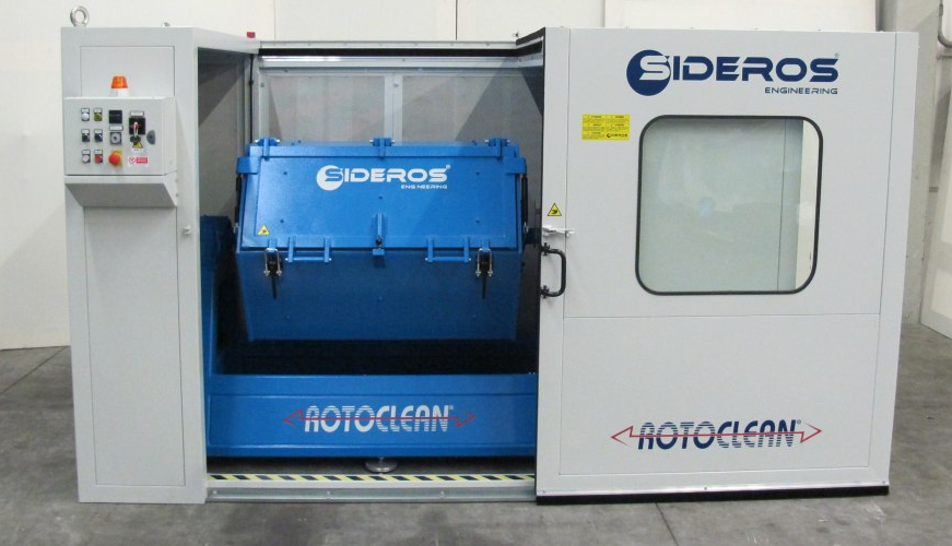

Replied by machinedude on topic Tumbler Build - For cleaning plasma cut parts.

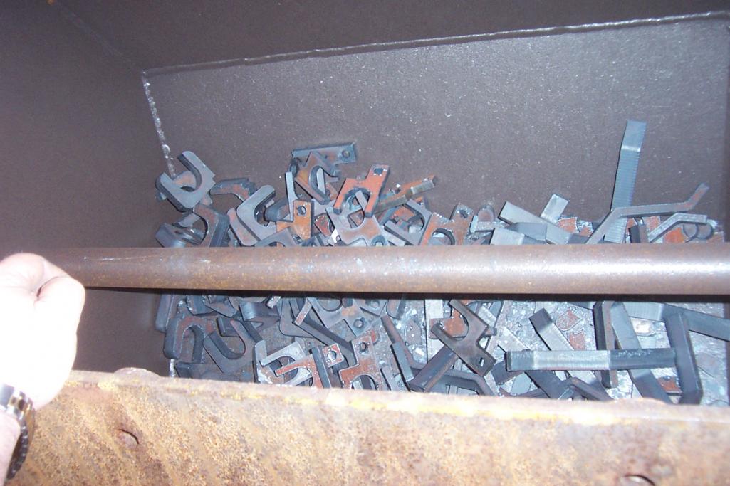

the one we have at work recirculates the water and has additives mixed in the water. i think the additives are something along the lines of anti foaming and rust inhibitors. the water keeps the media cutting better as well.

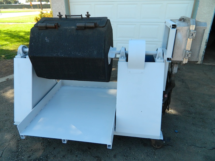

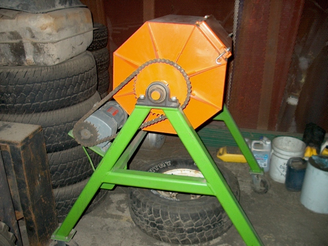

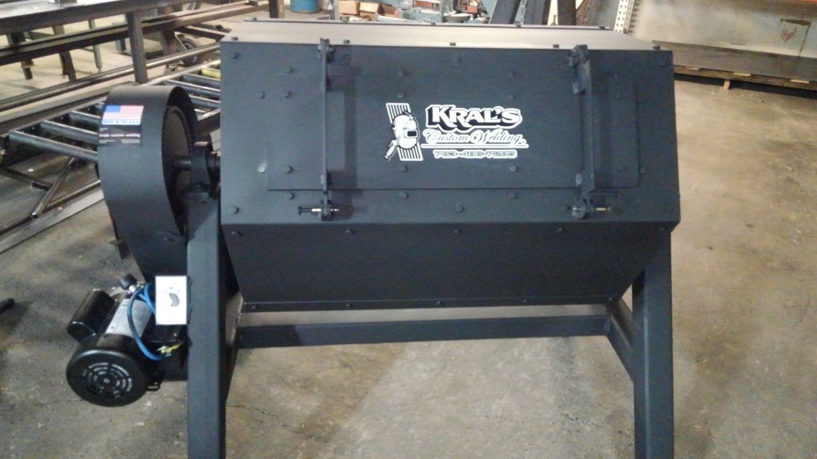

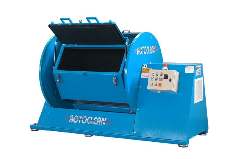

Replied by thefabricator03 on topic Tumbler Build - For cleaning plasma cut parts.

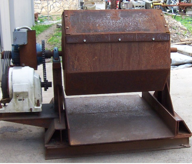

I did not know they used wet systems for tumbling. Ill look into it.

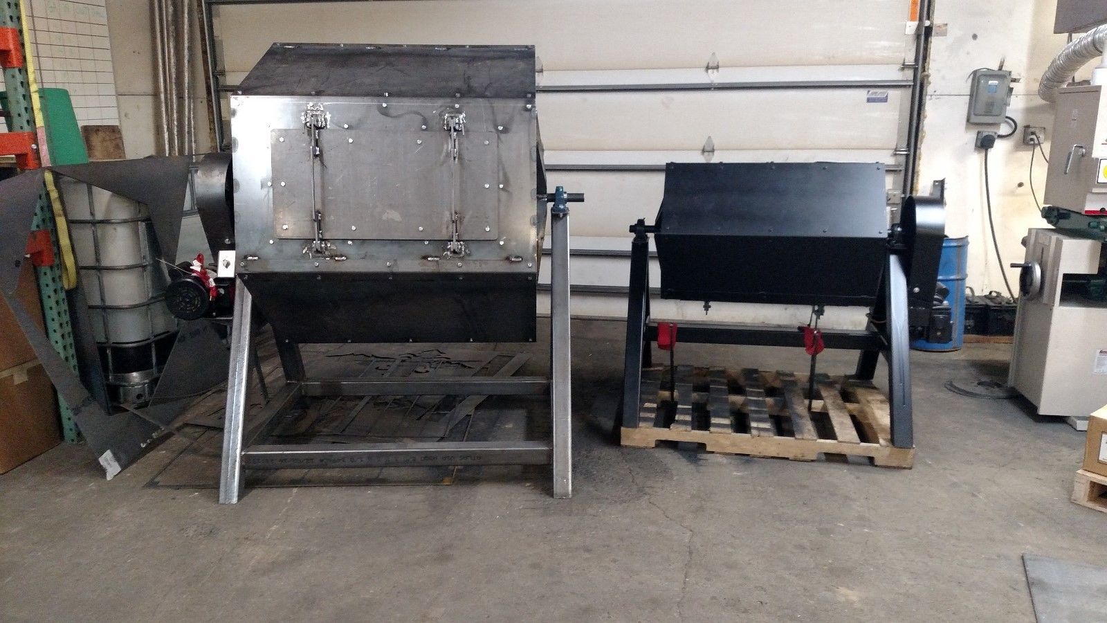

I based my design on these dry tumblers,

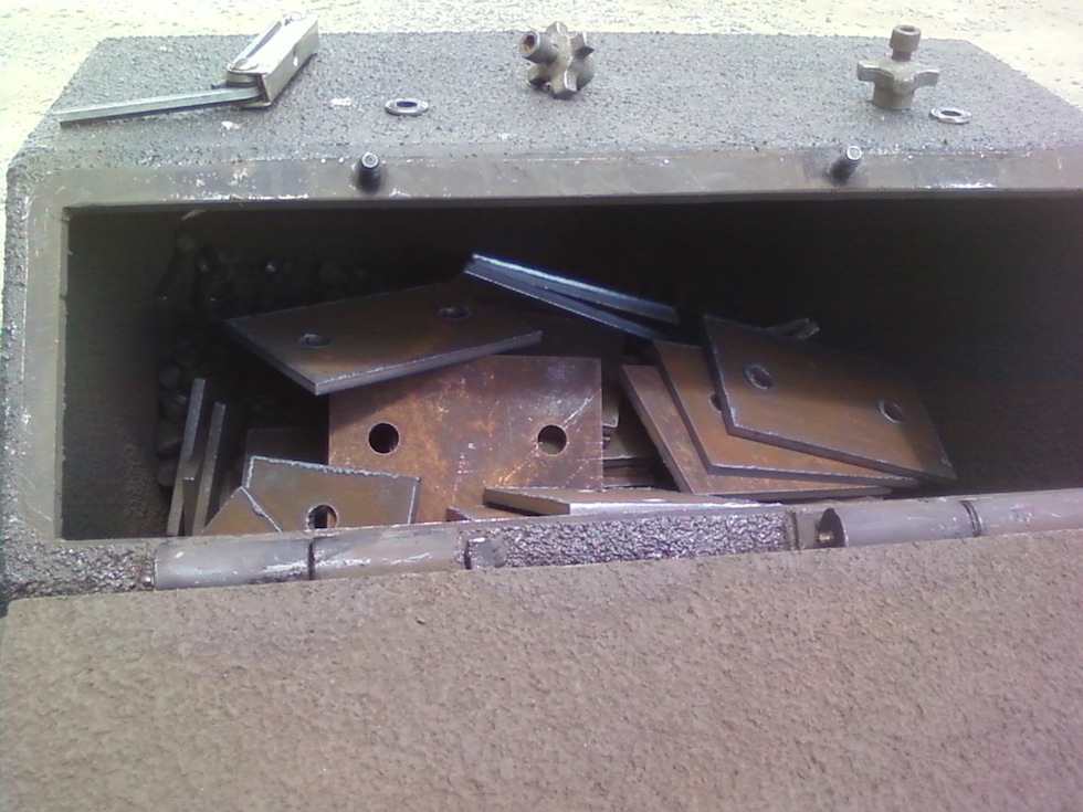

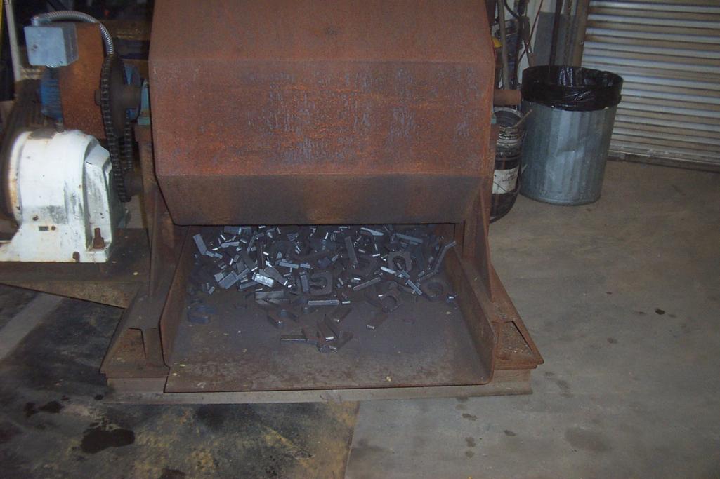

11 Apr 2020 00:36 #163548
by thefabricator03
Attachment not found
- thefabricator03
- Visitor
11 Apr 2020 00:36 #163549
by thefabricator03

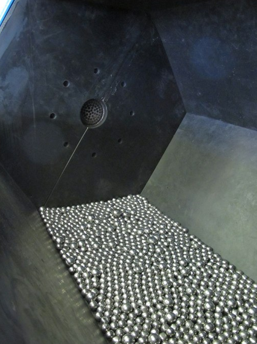

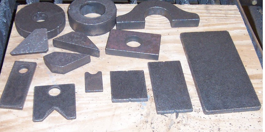

- machinedude
- Posts: 715
- Thank you received: 312
11 Apr 2020 01:33 #163555
by machinedude
dross from plasma or laser is probably a different kind of animal for tumbler requirements. i would imagine you need something pretty violent to knock it loose after seeing a barrel full of huge ball bearing as media
the wet tumblers are more of a finishing tumbler with abrasive stones for media.

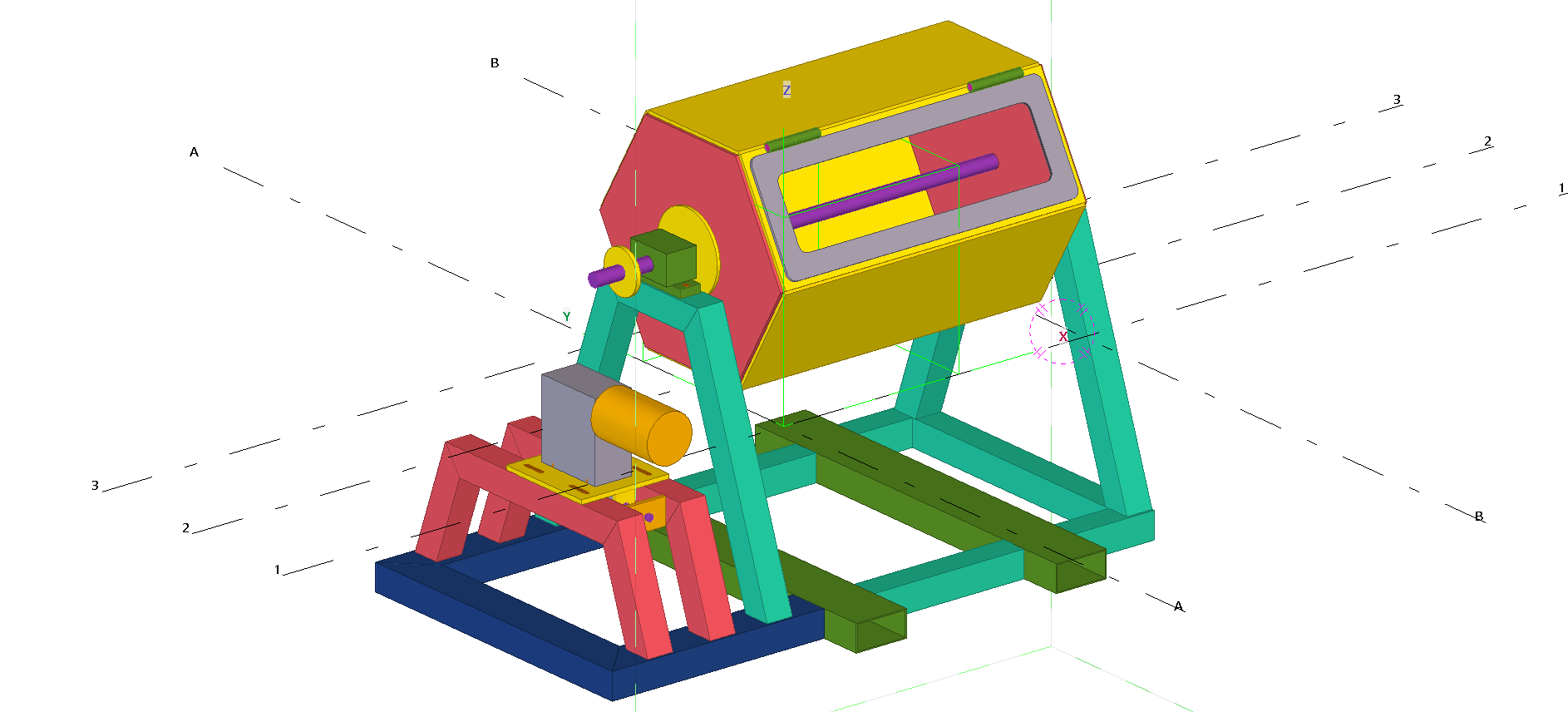

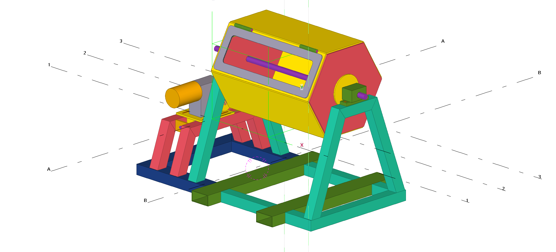

12 Apr 2020 01:49 #163699
by thefabricator03

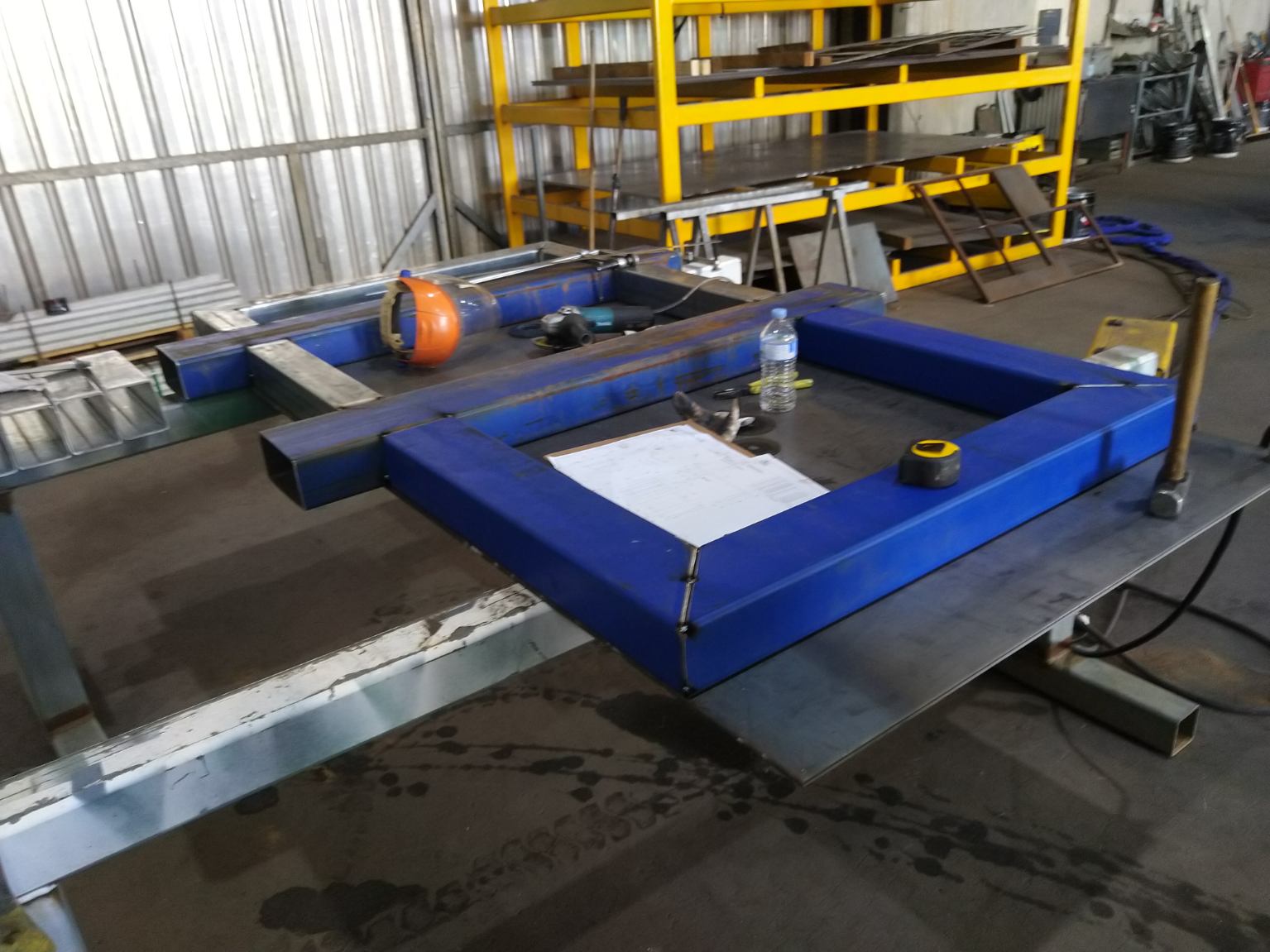

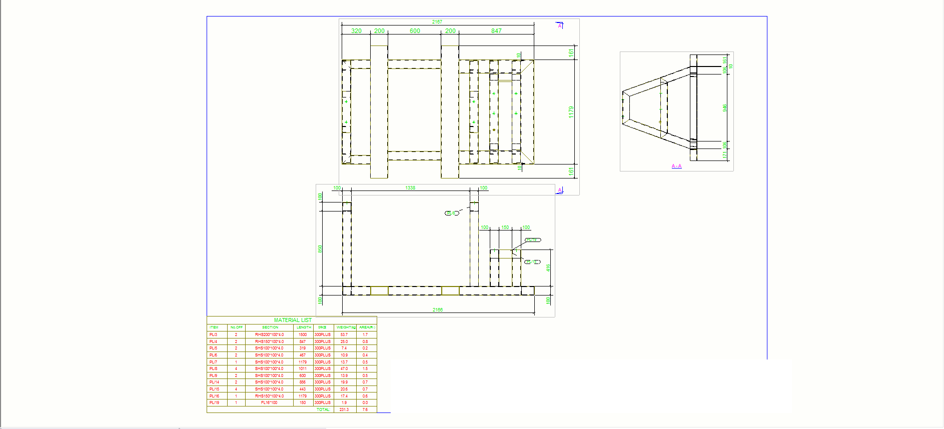

3D model done,
Fab drawings done.
Time to get into it.
Fab drawings done.

- thefabricator03
- Visitor
12 Apr 2020 02:44 #163717
by thefabricator03
Thats my problem with learning programming. Having the time to play around with it and learn the ins and outs.
A few years ago now my job was a full time draftsman.I learnt as many CAD programs as I could when I had the time.
Now when I need to design something, the first thing I do is model it. Saves sooo much time when you need to see how something looks before you go ahead and start making it. Its hard to say how much time you would save on a project like this by modeling it first but it is roughly about half the time. Just being able to try new things out without physically building something is in my opinion is priceless.

- thefabricator03
- Visitor

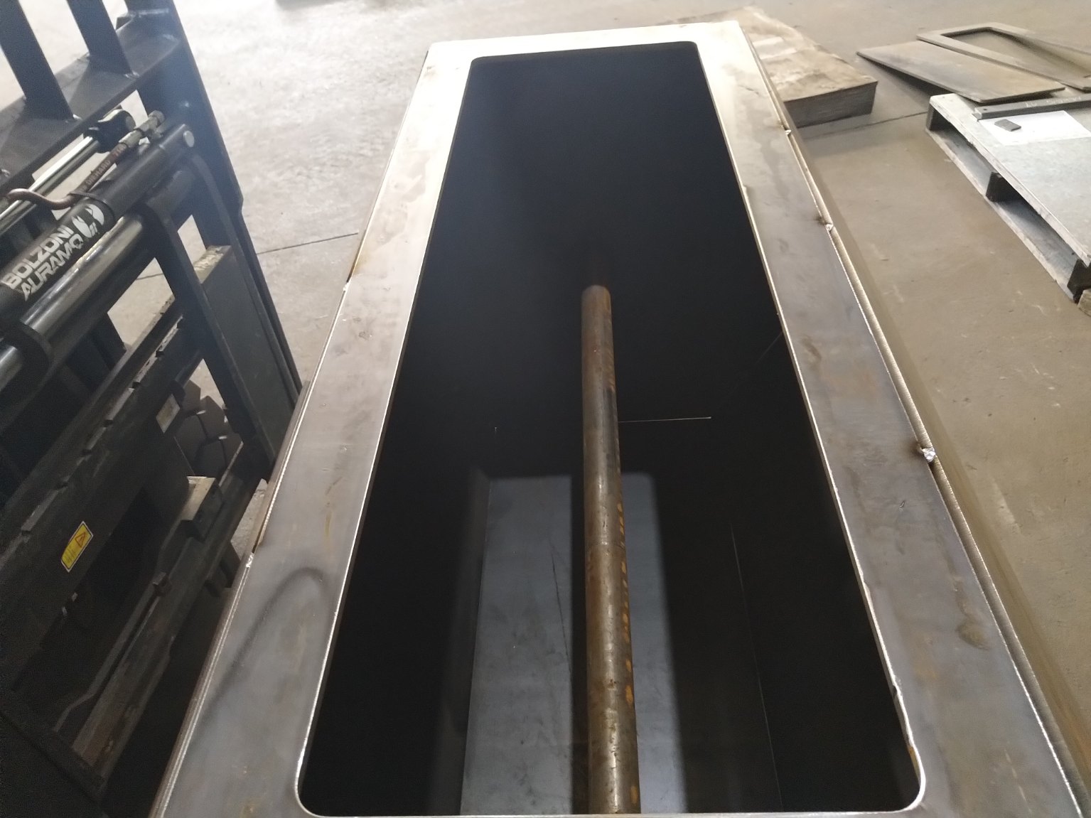

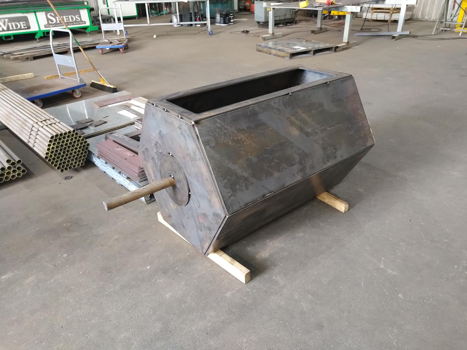

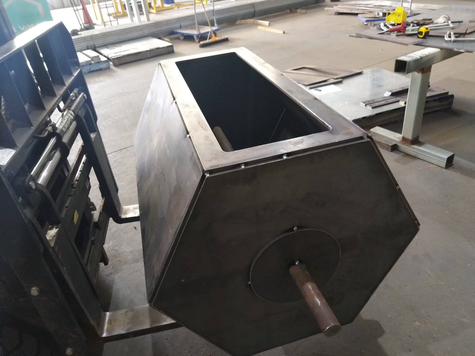

13 Apr 2020 09:14 #163857
by thefabricator03

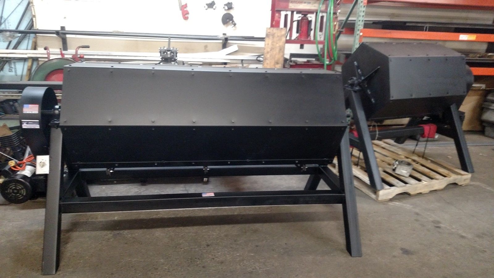

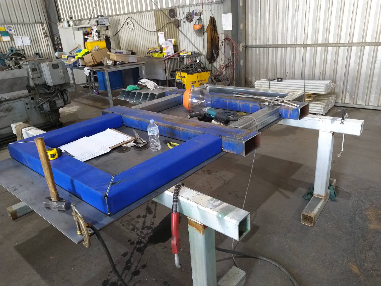

More progress.
