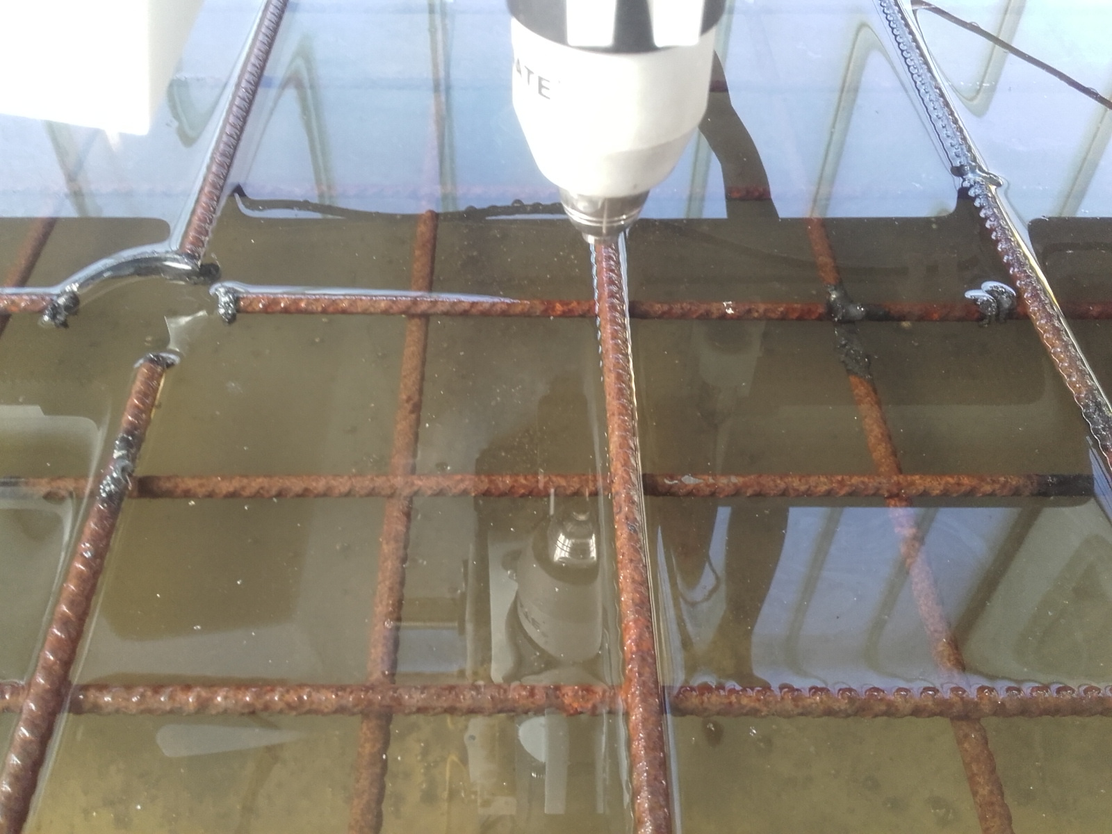

23 Apr 2020 19:10 - 23 Apr 2020 19:16 #165289
by CNCFred
Replied by CNCFred on topic Bought material, the journey continues.

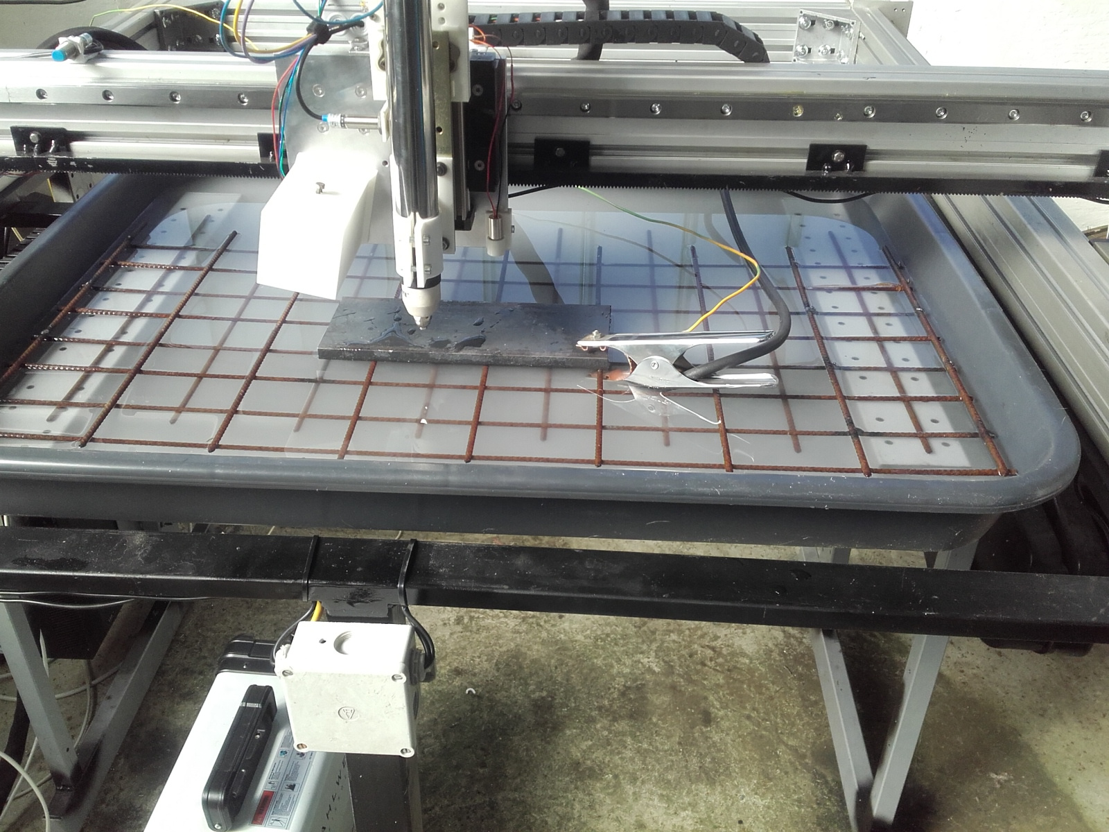

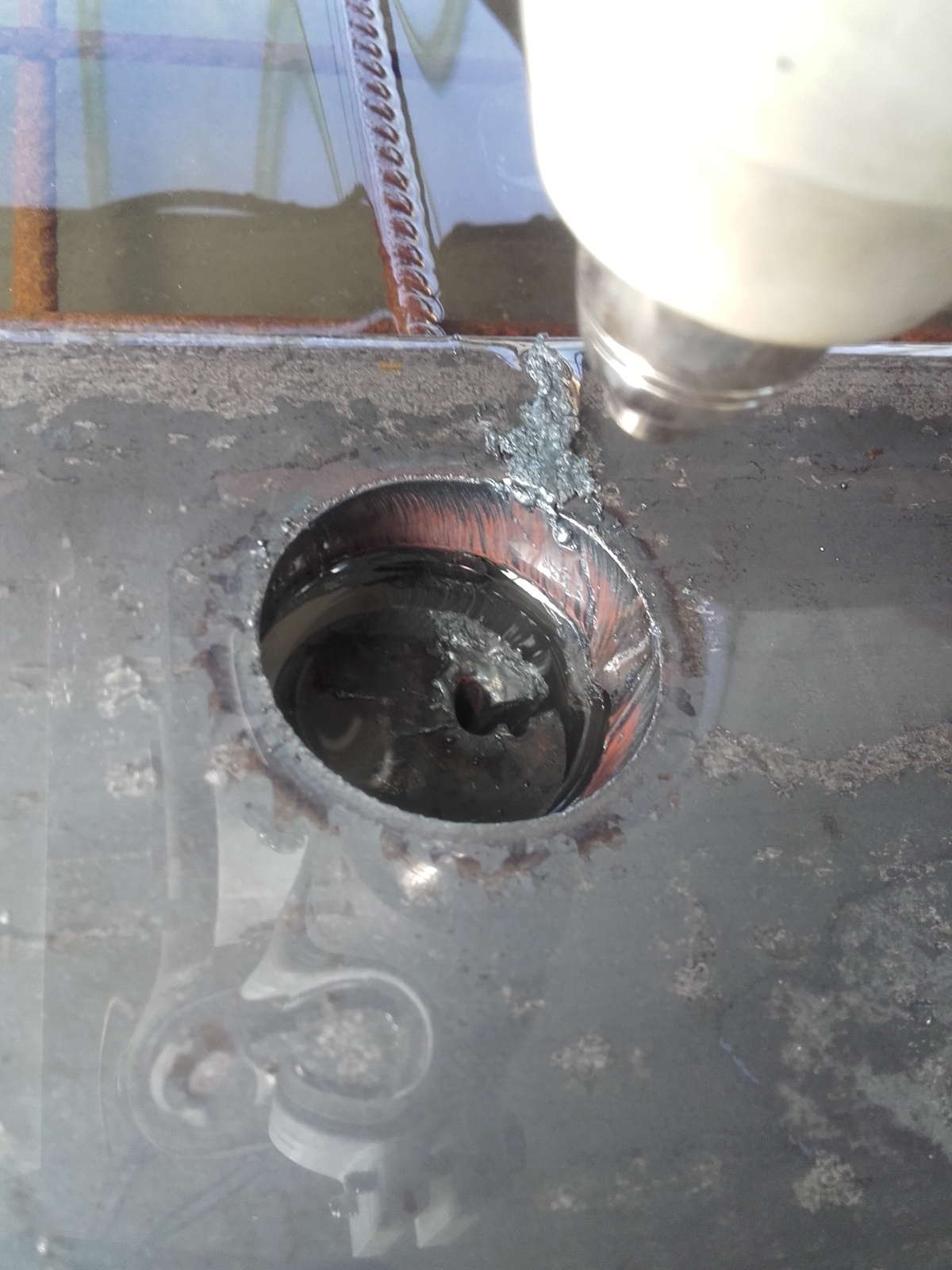

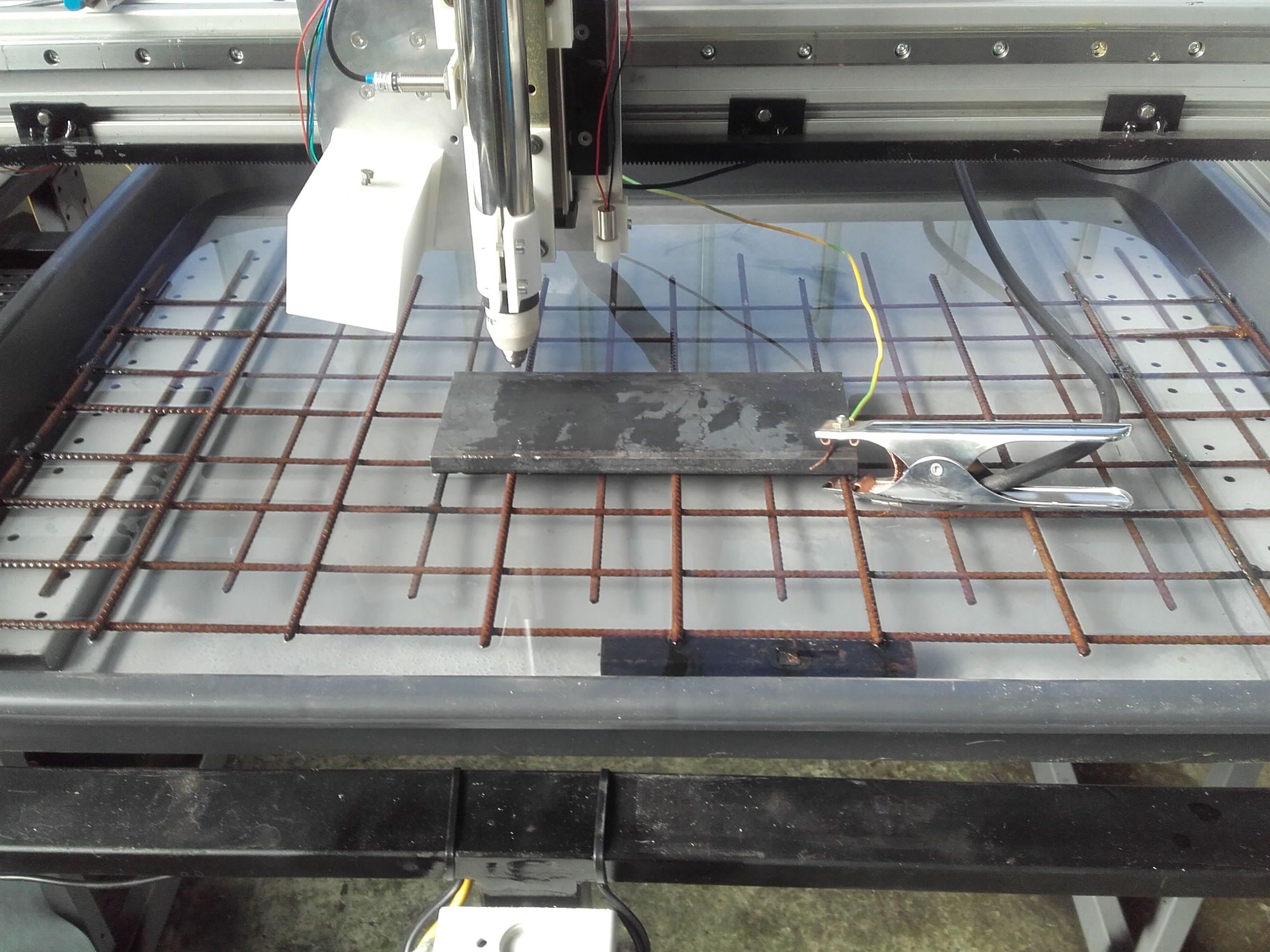

Dear all,
at the end the torch dived again in the hole, so I had a look and it seems the 10mm lead out enables thc again?
Tommylight sorry didn't get a metal pan but a plastic one for testing...this is great what a difference cutting .
pictures will follow
any hint how to embede youtube videos? video link and url did not work...

23 Apr 2020 19:33 #165295
Replied by tommylight on topic Bought material, the journey continues.
That THCAD is quick ! !!
No lead out's for plasma cutting, just lead in.
On the first cut it went 5mm deep, on the second nearly 30mm !
And now you know why i insisted on covering the motor, water gets everywhere.
Nice work.
As for embedding youtube, open the video in browser, click on the link in the address bar and copy that. Works always.
Nice work.

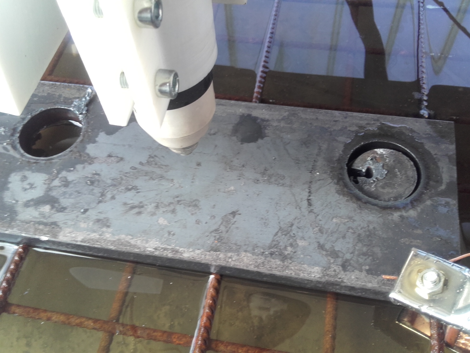

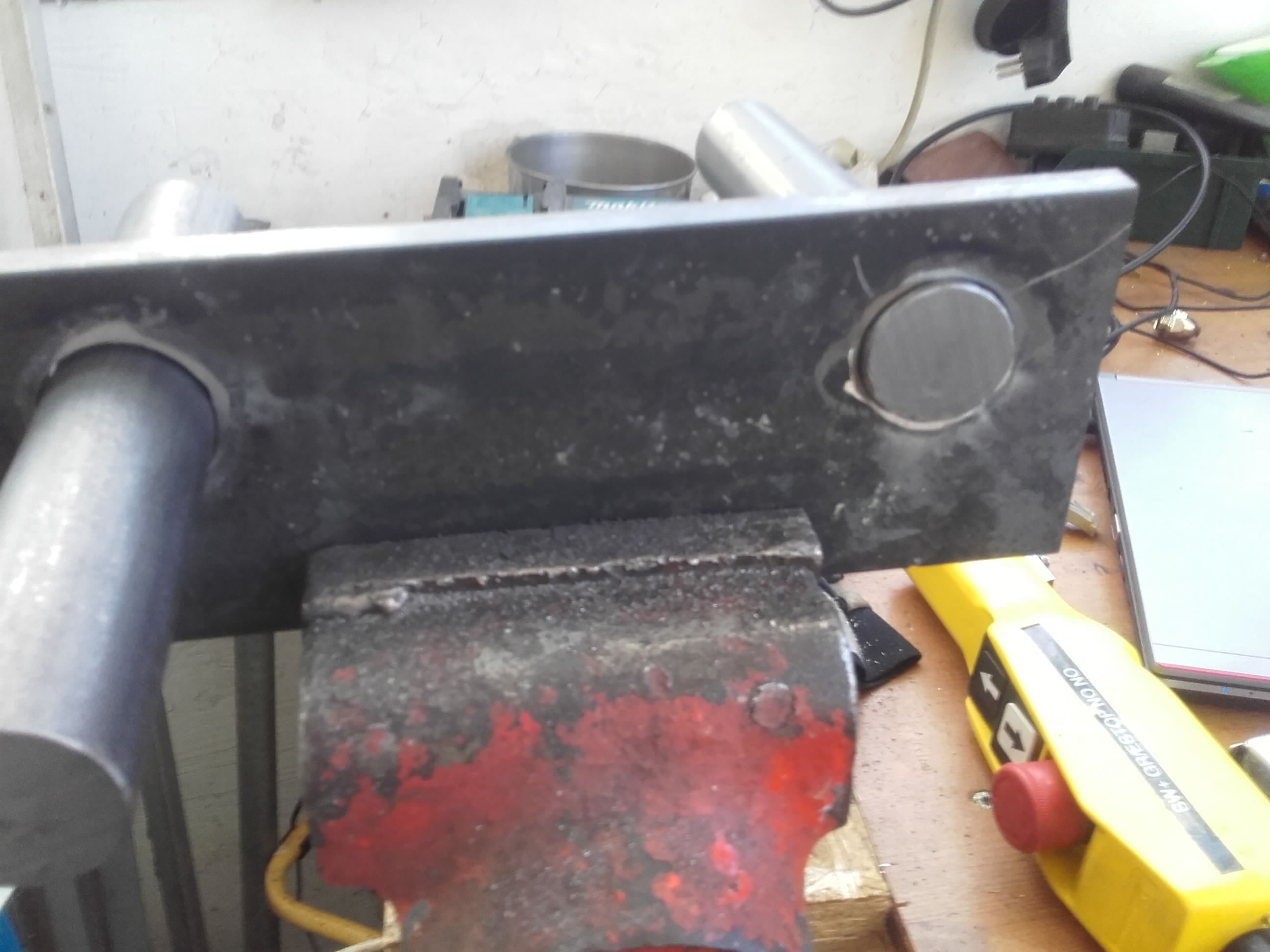

23 Apr 2020 19:43 - 23 Apr 2020 19:45 #165298
by CNCFred
New nozzle and nice cut... Never the less to small the first hole... Fileing 12mm steel not much fun I can tell... So with a grinder the round one
Stopped the cut... Edited the second hole bit bigger started from gcode line! Great!
Is the kerf with different from material to material? Thickness?
The grid is to weak needs support.. The only material I had at the moment.
Glad I had a kilo baking soda at home....
