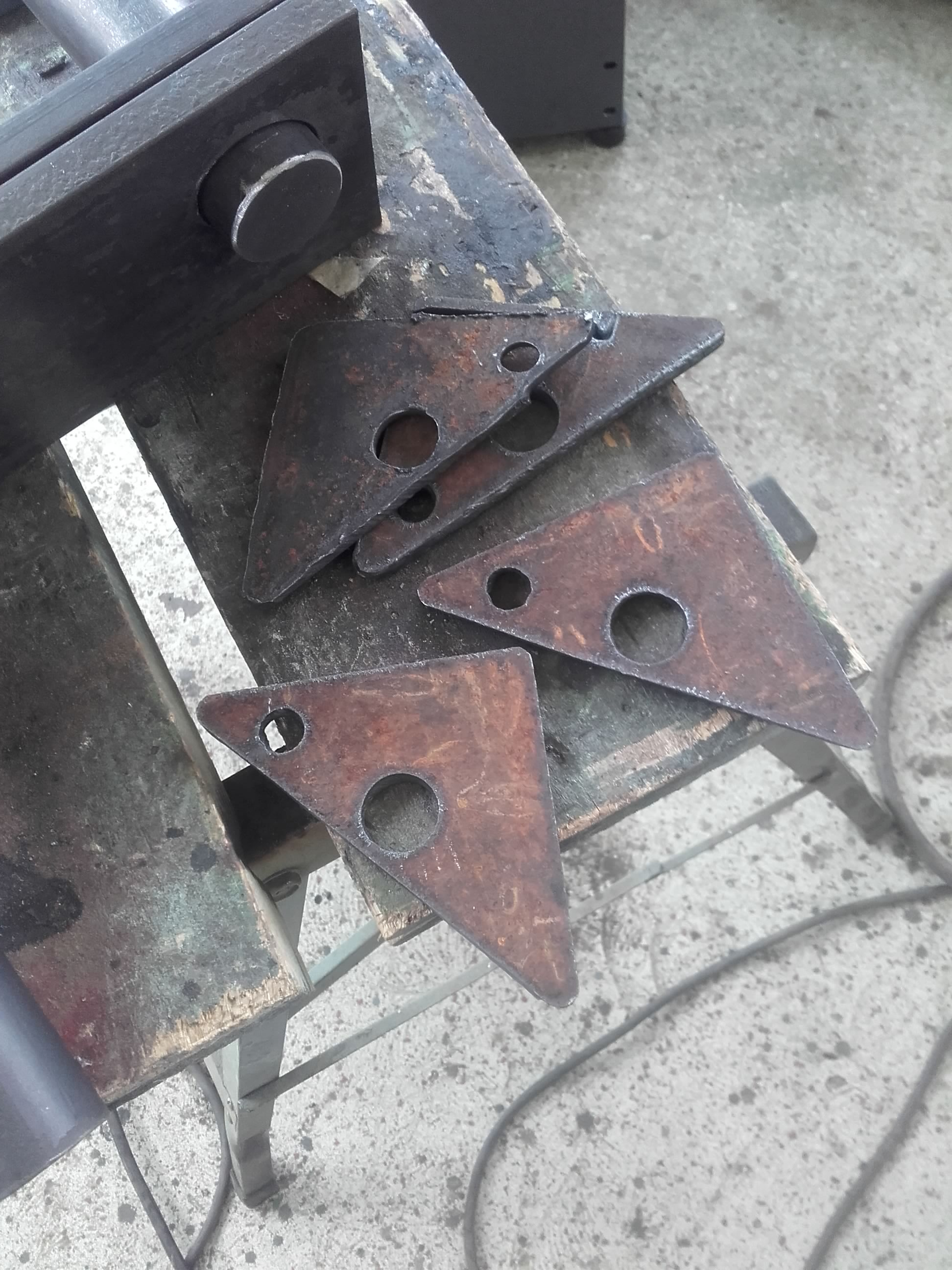

23 Apr 2020 20:15 #165302
by CNCFred
Replied by CNCFred on topic Bought material, the journey continues.
I should have chosen a friendly bright black for 3d printing
That torch can be mounted instead of the handheld one. Was even more expensive in metal than in plastic.
It is a P80 as well the consumables. 1.5mm nozzle
www.stahlwerk-schweissgeraete.de/Plasma-/-CUT-Accessories
I found on ebay consumables nozzle with 1.1mm will get some for thin sheets.
You think it is cutting nice? It is my third cut and I must say didn't experiment with amperage nor something else. Just pierce delay I chose 2.5sec.

23 Apr 2020 21:42 #165308
Replied by rodw on topic Bought material, the journey continues.
Don't worry, it will be black soon enough!
The dive from the torch is the very problem I am trying to solve at the moment. As the slug drops away, the torch tries to follow it. The same thing happens if you cross a kerf. There is a recent thread about this. For holes like that though, you can disable the THC.
I never do a lead out on anything. But on holes like this an overcut will let the bottom of the arc to catchup to the top as it trails behind.
Also check the Plasmac manual in the docs for hole cutting.

24 Apr 2020 01:30 #165339
by phillc54
Replied by phillc54 on topic Bought material, the journey continues.
In the first two videos in the gcode file line 37 and 38 should be reversed as should lines 45 and 46.

24 Apr 2020 04:56 #165353
by phillc54
Sorry about this, some more errors by me, a fix has been pushed.
It will fix the THC and the offset holes not being on centre.

24 Apr 2020 10:09 - 24 Apr 2020 10:11 #165364
by CNCFred
I will make two reinforcement triangles 100x100mm and added two holes for testing.
I skipped lead out and will use overcut this time
(manually added)
#<m_diameter>=45
#<holes>=2
I used the plasmac postprocessor in fusion 360 ..I am still not freehand with Gcode to figure out the right order.(as mentioned above that lines are mixed up)
Thank you Phillc54 for the changes!

24 Apr 2020 18:46 - 24 Apr 2020 18:47 #165438
by CNCFred
This time it worked well..(not the first pairl. Uhmmm well... Somehow the first cut this time was too fast and didn't go through.
But no diving...
Tommylight mentioned the beam should be slightly in front... Didn't manage that.. Seems it was still to fast.
And I forgot to seal the crosslaser which died due to high humidity ! Fortunately it came in pack of two:woohoo:
But no diving...
