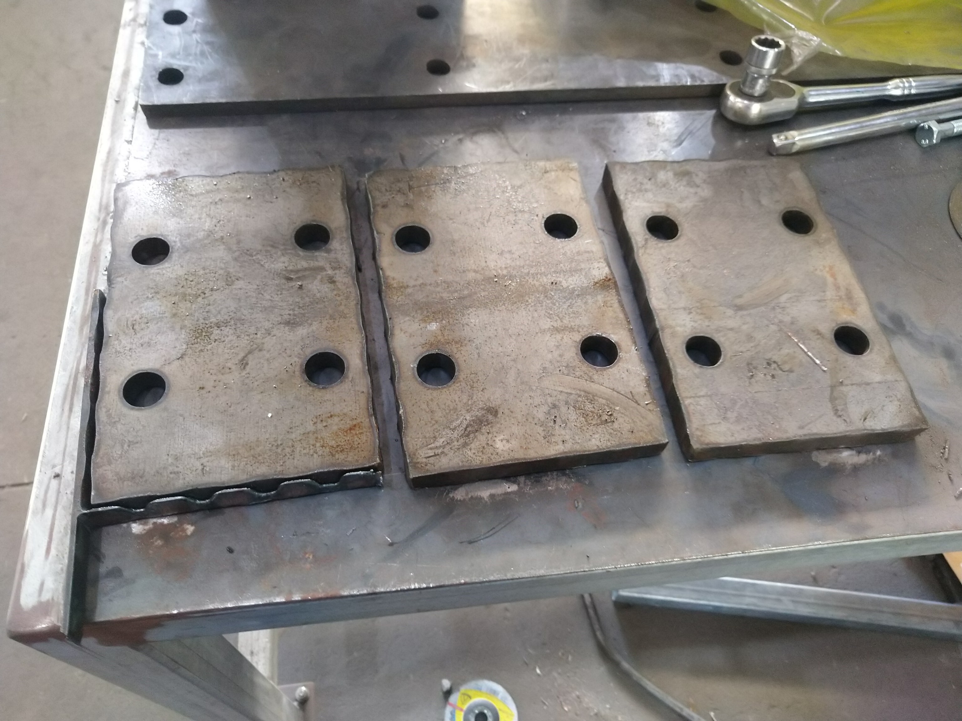

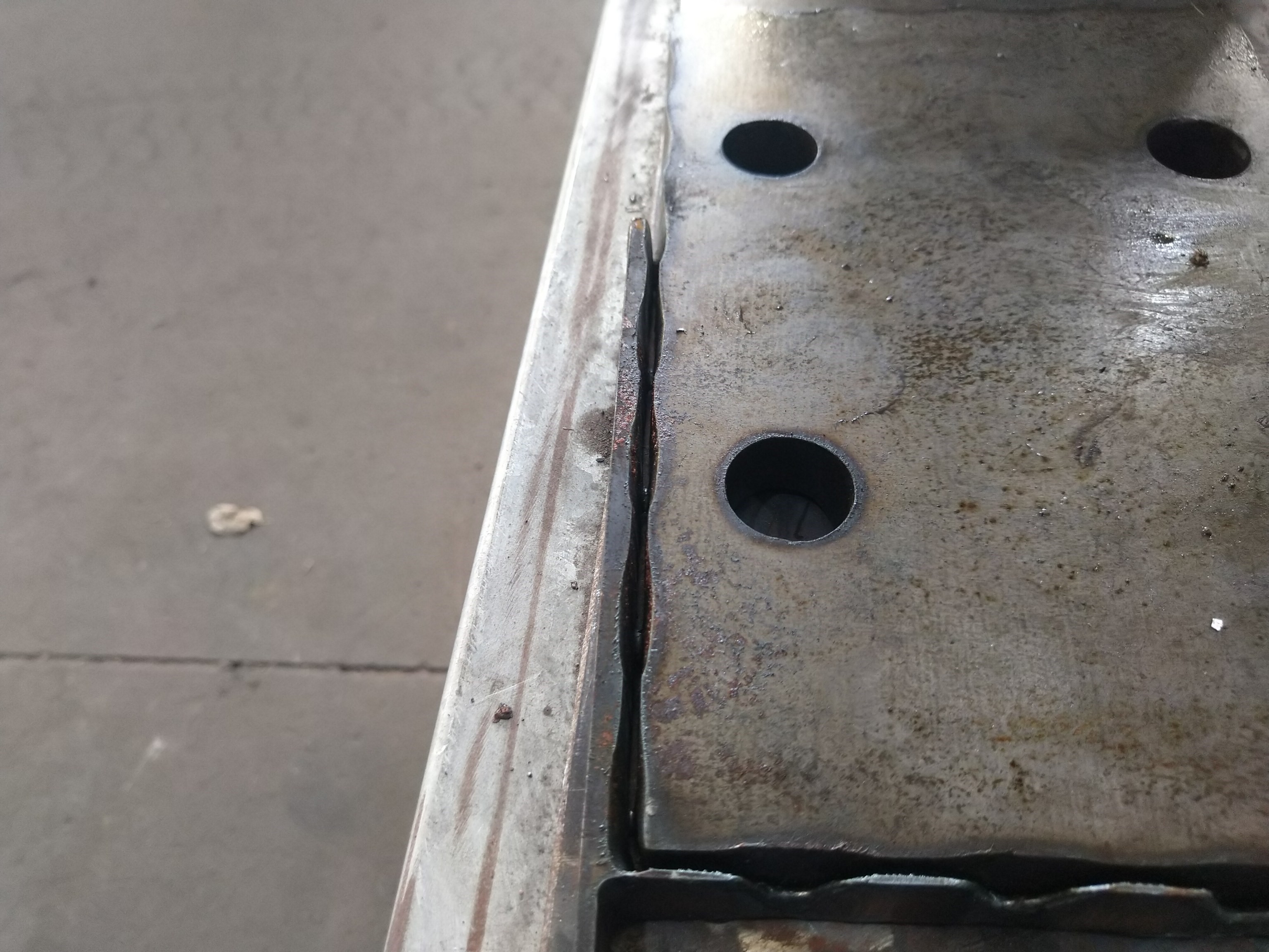

Hi Guys,
I had a strange issue with my THCAD the other day. I have been able to replicate the issue under a certain condition,
So I was doing some cutting the other day and noticed the machine making some strange sounds. I went and stopped the machine and noticed that the torch had been going up and down. This is the result.
I looked at the display and noticed that the THC voltage was fluctuating wildly when idle. I think what caused the issue was the temperature in the shop was just under 40 degrees celsius. The next day I cut some more plates and it worked fine until the temperature got up to the 38 degree mark.
Any idea on what I could do to keep the machine working in those temps? Maybe more fans or some kind of cooler in the control cabinet?

Interesting artwork!
The THCAD is rated to 70 deg C so where is it located? In your control box? How well cooled is that?
Can you check the voltage with a multimeter at the THCAD input if it happens again.
I would be checking for noise in your electrical seeing you have made changes there.
You do have a filter on the power inlet to your box don't you? If not, fit one straight away.
