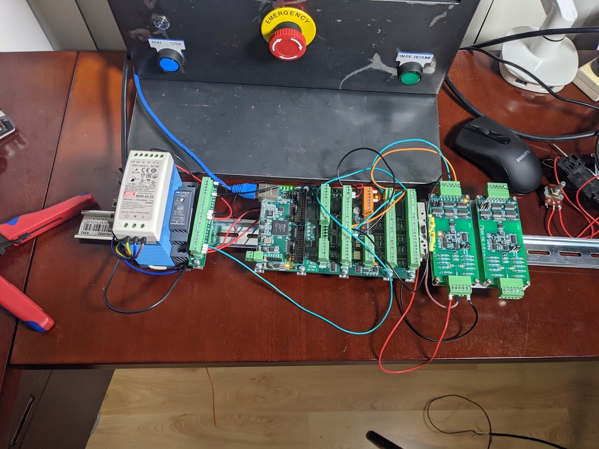

02 Feb 2021 12:55 - 02 Feb 2021 12:57 #197414
Replied by rodw on topic THCAD Environmental Fluctuations
Well, I think I know whats going on.
I set up a 7i76e on my desk at home and decided to play with a THCAD-5 and a 24 Volt power supply I installed for Ohmic sensing.
I had not set up any scaling and was just observing encoder velocity
I was getting all sorts of crazy fluctuations. They went away if I disconnected both THCAD inputs.
As soon as I connected either +ve or -ve, the fluctuations returned.
So I plotted them in halscope
There is a perfect 50 Hz AC ripple!
So then I disconnected the THCAD from ground (being to a DIN rail via a clamp) and the signal was rock solid.
The mains was also grounded to the din rail
So I think that your problem is a ground loop emanating from somewhere in your building on hot days due to some random dodginess somewhere.
I think the solution might lay in what has been suggested earlier,
1. Remove the external power supply
2. Power from the 7i76e
3. Install a quality RFI filter on the power input (Jaycar may not qualify here!)
Eventually I'll try and add a mains RFI filter and observe the response.

02 Feb 2021 13:01 #197415
by thefabricator03
Replied by thefabricator03 on topic THCAD Environmental Fluctuations
Thanks for that Rod, I think your on the money. My first thought was the edges of the plates I was cutting then this first occurred is that they looked like a sine wave. They were perfectly cut in a wave pattern. I had a power cable near the THCAD box and I thought that it might be causing some interference somehow.
I will implement those suggestions and report back.Its been cooler here the last couple of days and I have not had the issue reoccur.
