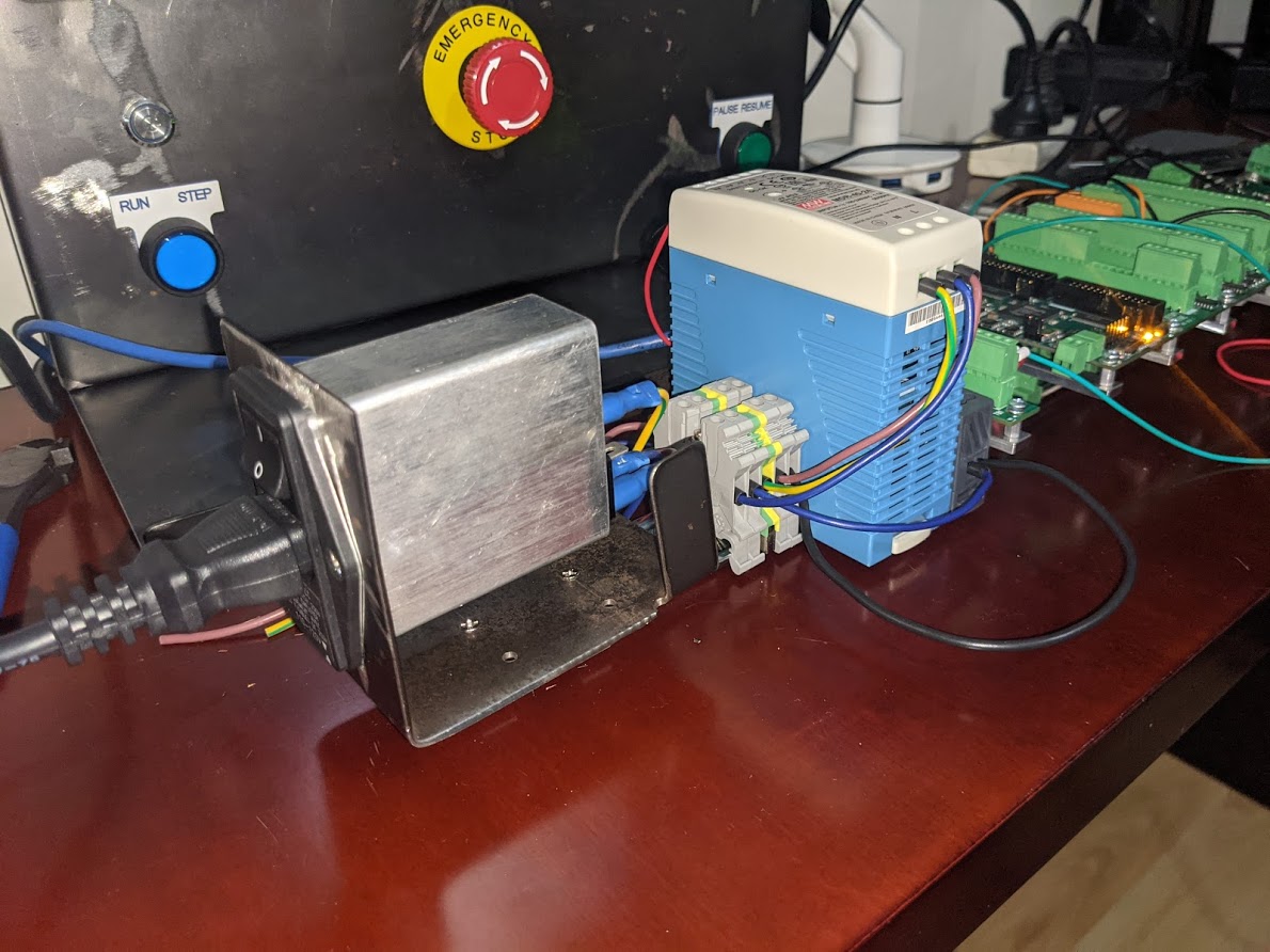

03 Feb 2021 11:14 #197539 by rodw
Replied by rodw on topic THCAD Environmental Fluctuations
Well I cut a bracket so I could use an IEC connector including RFI filter, power supply and fuse.
My associate said this this morning.
I kind of worry that adding a filter to mains will fix it. If the neutral/ground connection is what's causing the problem, then the filter won't touch it.
And he was 100% right. It made not one jot of difference!
So that leaves us with the two ideas from Peter and Tommy.
I don't think the shield connection would make any difference for ohmic sensing as there are no shielded cables in use on my table. Plus the power supply is double insulated and has no ground point. One wire is bolted to the table near the enclosure at the star ground point and the other runs up unshielded to the torch tip.
So doe anybody have any feedback on Tommy's method?
