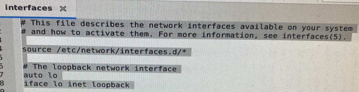

17 Jul 2021 22:52 #215186
by mal136
Replied by mal136 on topic having trouble linking the 7i96 and configuration.
I have not modified that file at all manually. I have found it in my computer and attached a screenshot. it doesn't reference any ip addresses at all.
All i did with LinuxCNC was download it and try to plug in my 7i96(set the jumpers to 10.10.10.10 physically on the board) and that was it. i have never intentionally touched or changed any settings that had to do with the ip address. i have absolutely 0 clue how to change it, i've tried googling it and no other distribution of linux has the same GUI so i cant figure out how to do anything.
- Posts: 18086
- Thank you received: 5320
17 Jul 2021 23:49 #215188
Replied by PCW on topic having trouble linking the 7i96 and configuration.
You can either modify the interfaces file (as described in the hm2_eth manual page)
of you can use the GUI configurator.
For simplicity, I would use the latest LinuxCNC versiion ISO (2.8.2)
as this should have the netmanager GUI for network setup which avoids
issues the previous releases had with the wicd GUI. This should also
have a pncconf version that knows how to setup the THCAD

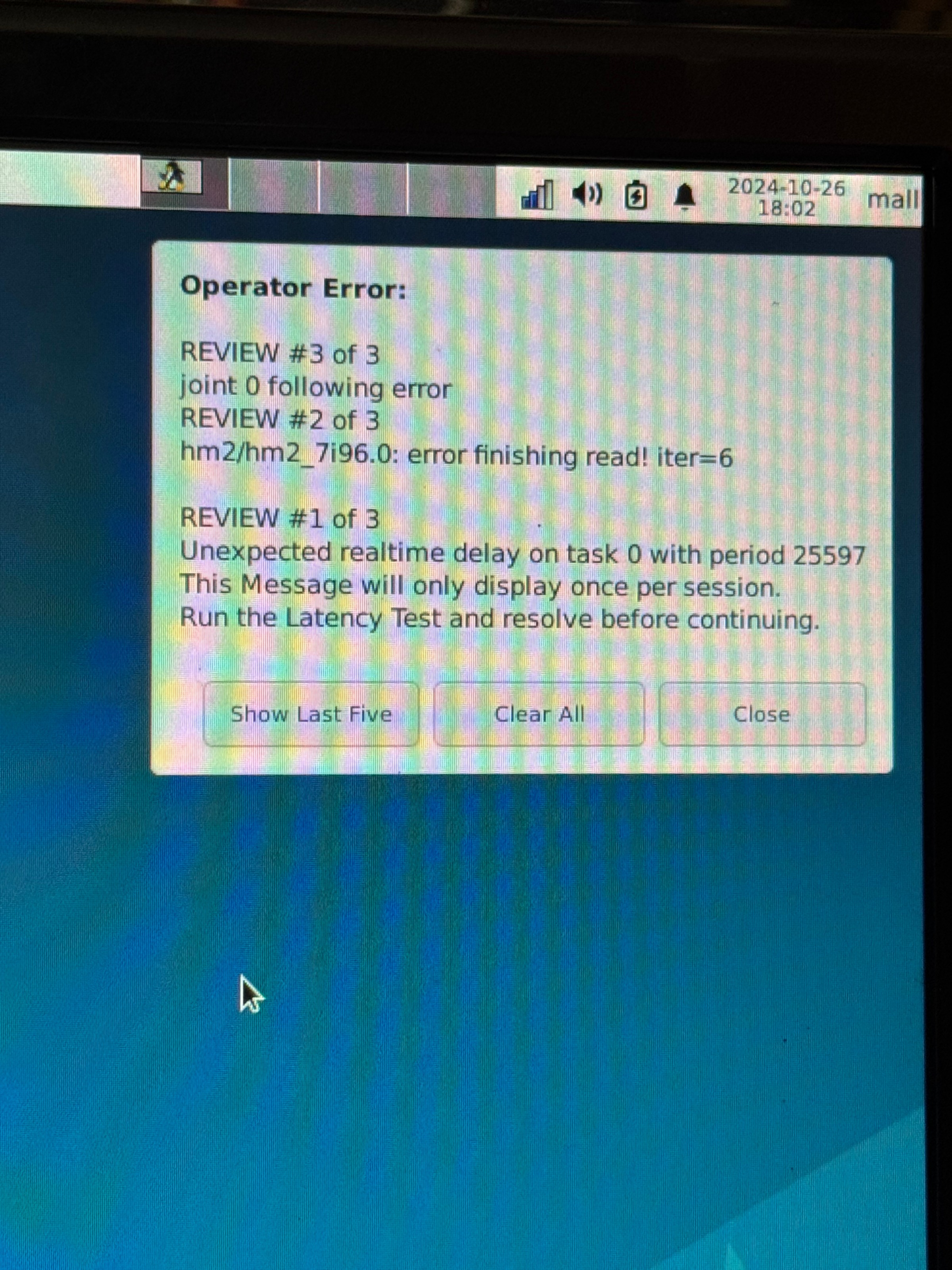

- mal136
- Posts: 23
26 Oct 2024 22:23 #313269
by mal136
Replied by mal136 on topic Voltage divider for Mesa THCAD-10?
Hello all it's been a number of years (3+) and i've finally got around to getting this working on this. I graduated as a mechanical engineer and felt comfortable enough to understand this stuff now. I was able to connect my mesa 7i96, problem was that my linux distribution had issues connecting to the 7i96. I basically upgraded to the latest linuxcnc (currently on debian 12 with linux 2.9.3) and i have the machine moving using AXIS, for some reason when i try to setup the QTPlasmaC and it will not operate .
Here are the errors i'm getting(see image attached), what doesnt make sense to me is that my jitter is the same as when im using AXIS... and AXIS works great!
Honestly my only goal is for the machine to cut metal with the plasma torch and have a functional torch height controller, i dont care which GUI is used.
If anyone could please help me get this machine going i'd greatly appreciate it!!! I have projects that require plasma cut parts and i'm desperate for this machine to work.
Thank you in advanced , have a great day everyone!
