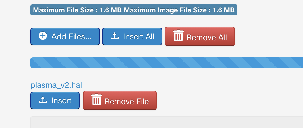

The main hal file: plasma_v2.hal
has not been attached.
- mal136
- Posts: 23
29 Oct 2024 02:33 #313403
by mal136
Replied by mal136 on topic Voltage divider for Mesa THCAD-10?
Hmm that's odd ; I uploaded it but it seems it didn't load or attached, apologizes hopefully this time it works .
