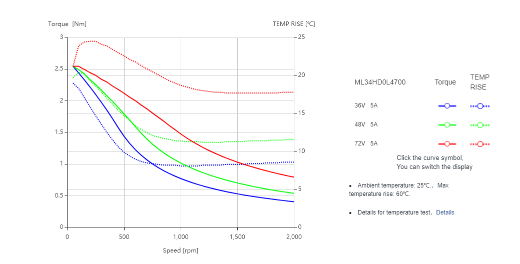

That's not accurate. More voltage will give you more torque when the torque starts to fall at higher speeds.
Your better off using more current and/or less microstepping.
Replied by bevins on topic Voltage divider for Mesa THCAD-10?
That's my diagram!
I told him you could not be trusted!![]()
(doubling volts roughly quadruples torque)

- Posts: 12067
- Thank you received: 4118
21 May 2021 01:18 - 21 May 2021 01:18 #209712
This is a torque curve for a Moon Industries ML34HD0L4700 motor
Solid red line is double the voltage of the solid blue line.
Maybe not quadrupled, but there is a significant increase in torque from 36 volts to 72 volts.
Ref: www.moonsindustries.com/p/nema-34-standa...0-000004611110010545
Replied by rodw on topic Voltage divider for Mesa THCAD-10?
I still don't think we have it right.
That's not accurate. More voltage will give you more torque when the torque starts to fall at higher speeds.Your better off using more current and/or less microstepping.
I told him you could not be trusted!That's my diagram!
