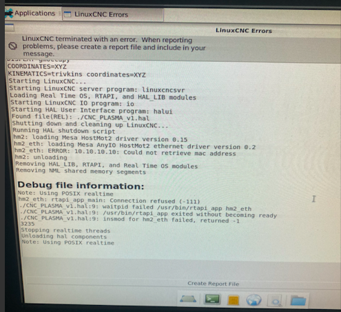

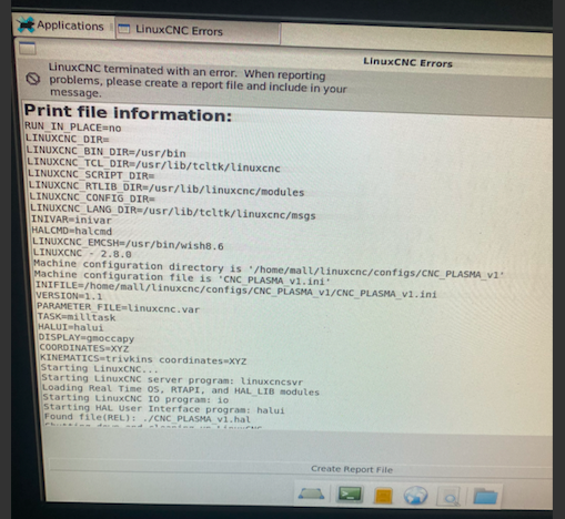

28 May 2021 20:38 - 28 May 2021 20:39 #210560
by mal136
Replied by mal136 on topic having trouble linking the 7i96 and configuration.
Alright so everything is wired up, MESA 7i96 is receiving 5v power, brand new ethernet cable is connected and the lights are on on the 7i96 board. I set W5 & W6 jumpers to enable the address " 10.10.10.10 " and i've configured this in the PncConfig wizard and it's not moving any axis's and when i open the desktop shortcut created by the config to open "axis" , i get an error(attached in screenshots below) and it doesn't open .
2 things are fairly clear, the mesa board doesn't seem to be connected and i dont know why but the config is not correct....
i've followed every instruction online from the wiki and linuxcnc doc's and still having trouble. i really dont understand what's going on..?
i'd appreciate some help on this, please please!
Last edit: 28 May 2021 20:39 by mal136. Reason: gramar

30 May 2021 17:10 #210700
Replied by andypugh on topic having trouble linking the 7i96 and configuration.
hm2_eth: rtapi_app_main: Connection refused (-111).
Looking on this forum:
forum.linuxcnc.org/38-general-linuxcnc-q...tion-refused?start=0
A suggestion is that is happens if the PC and the Mesa card are given the same IP address.
The 7i96 os on 10.10.10.10, but what IP address did you set the PC to?

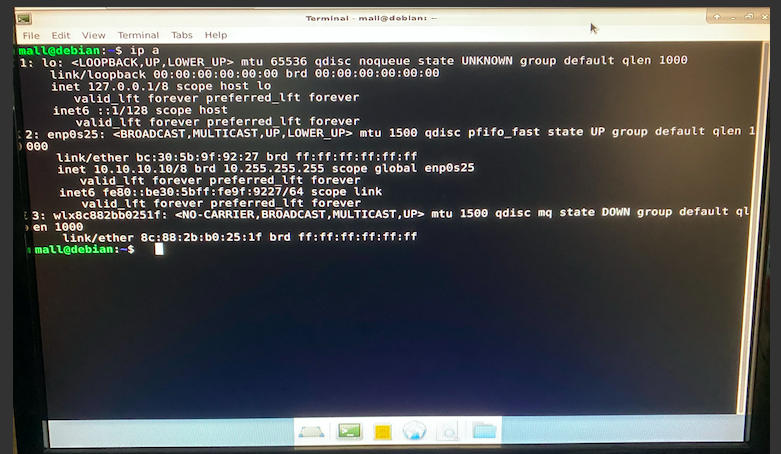

- Posts: 18105
- Thank you received: 5328
31 May 2021 18:16 #210810
Replied by PCW on topic having trouble linking the 7i96 and configuration.
1. I would leave the 7I96 at 10.10.10.10
2. What does the command "ip a" report?
- mal136
- Posts: 23
31 May 2021 18:30 #210813
by mal136
Alright i have set jumpers back to "10.10.10.10" positions
what steps do i take from turning on the board to getting it connected?
Do i setup a wired connection?
(i already tried this with static ip adress "10.10.10.10" and it didn't work, it will ping "10.10.10.10" but doesn't connect to the 7i96, i've even tried the discovery board option in PncConfig and it never can find the board.
